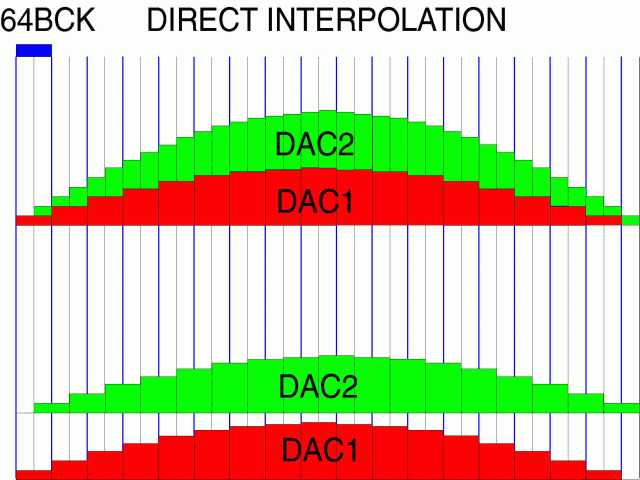

Some information about Direct Interpolation
Hi all,
Here some information about the Direct Interpolation DAC.
Twin Direct Interpolation by parallelling DAC outputs:
It uses the WS signal to split up the 64 BCK pulses long sample into two 32 BCK long samples DAC1 receives the standard signals and outputs L and R. DAC2 receives an inverted WS (wordselect) causing a 32 BCK long delay (WS determines when the sample appears at the DAC output). This all creates 2 samples of 32 BCK pulses each: 1-32, 32-64. so the virtual sample rate becomes 44.1 * 2 = 88.2 KHz. This can be verified by observing the output signal with an oscilloscope. Because all analog outputs are ADDED, the following intermediate steps are created:
1-32 (DAC1)
32-64(DAC1+DAC2)
These addittional steps increase the output resolution to (2*65536=131072) equivalent to 17 bit resolution as DAC output voltages are added stepwise.
Here is an overview of how to connect each of the 2 DAC's
DATA DAC1 = DATA
BCK DAC1 = BCK
WS DAC1 = WS
L OUT = L OUT
R OUT = R OUT
DATA DAC2 = DATA
BCK DAC2 = BCK
WS DAC2 = NWS (inverted)
L OUT = R OUT (swapped)
R OUT = L OUT (swapped)
So basically if you already have a twin DAC and you want to try this, just invert WS on the second DAC and swap its L and R outputs. You will get 88.2KHz virtual sample rate and 17 bits. If you like a differential output stage, invert DATA of DAC2: NDATA

With no delay to the data to DAC2, there will be an error. DAC2 will convert the wrong data
correction
Hi rfbrw,
You are absolutely right of course, but I already fixed this problem this morning. I used the correct delay for DAC2 and DAC4 now 32 and 48 BCK delay and the outputs are no longer swapped, however it takes 12! 8 bit shift registers, but it is definitly worth it, I am quite pleased with the result now. I will post schematics as soon as possible
Hi rfbrw,

Hi, guido
Thanks for your reply.
This DAC creates steps from one and the SAME sample by creating multiple slightly delayed images from the sample (so the delays ALWAYS stay within that sample). By doing so it creates both, more steps and more samples within a single sample. Note the delays will only occur within one sample time (64 BCK) as far as I can measure this will cause no phase shifts in the signal itself since all "interpolations" stay within one sample. So with 2 DAC's you get an image at 1-32BCK and one at 32-64 BCK effectively doubling the "sample rate". Important to know is that the sample is placed on the output on the trailing edge of WS, so by delaying both WS and DATA, you can determine when the next of the 4 DAC's will output the same sample (I used 12 synchronous serial shift registers 74HC166 clocked by BCK). With 4 DAC's you get the original sample at 1-16 BCK, and copies at 16-32 BCK, 32-48 BCK and 48-64 BCK. But since the DAC outputs are added, you get (for the 4 DAC example) 1-16 I out = DAC1, then the second DAC outputs it's sample at 16-32 I out = I DAC1 + I DAC2 (output is twice the sample value). At 32-48 output = I DAC1 + I DAC2 + I DAC3 (output is 3 times the sample value). At 48-64 I out = I DAC1 + I DAC2 + I DAC3 + I DAC4 (output is now 4 times the sample value). So I need multiple DAC's for creating copies of the original sample. When you view a sinewave (recorded on CD) and look at it on the oscilloscope it's waveform is still a sinewave, but it has a much higher resolution than a 44.1 KHz NOS-dac the steps are so small they only show at rapid signal changes, since the sample rate is 4 times higher, some higher frequencies noise is produced (very low amplitude) that is logical because I shift the mirrored image to a higher frequency to make filtering much easier. I used a 2nd order Bessel filter to make sure high frequency residu's are filtered out but maintaining phase linearity and excellent step responce. Note that during developing I always keep comparing the NEW DAC with a standard "reference" NOS-DAC by toggling between them during listening. I always use a a set of test CD's (chesky audio recordings, Diana Krall, Norah jones, Live Jazz recordings) so you get very familiar with the recordings and know when something improves or get's worse.
