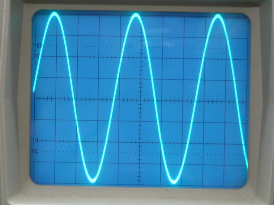

6000Hz sinewave
Hi, all
Here a 6KHz sinewave from the unfiltered octal D-I DAC, still no steps visible.

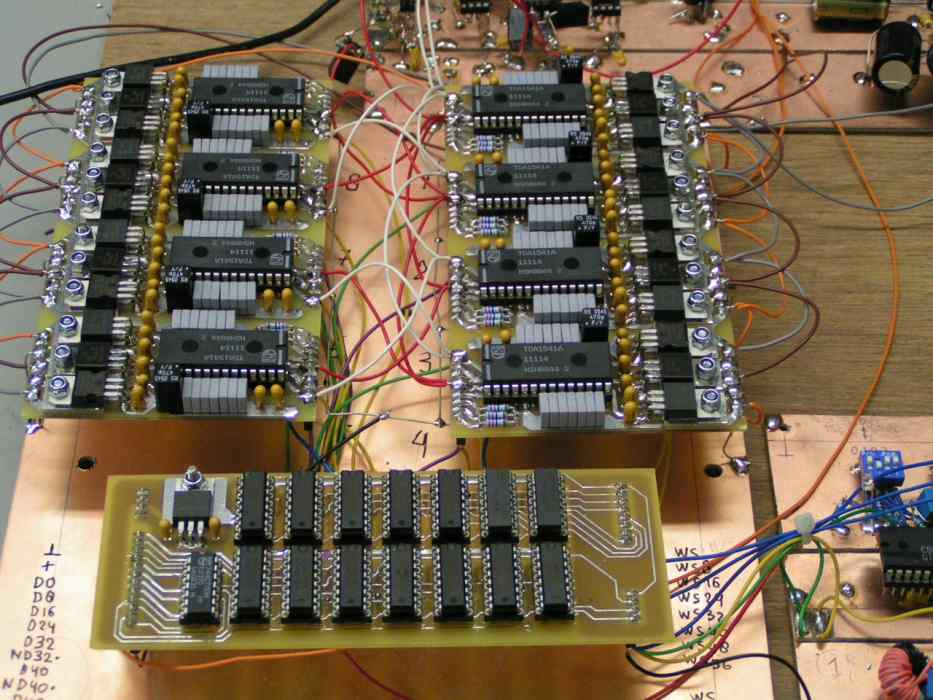

Octal D-I DAC prototype
Hi, poobah,
Ok, I just wanted to indicate you wouldn't get perfect squarewaves with very short risetimes, that's all 🙂. Good that you remind me, I could do some testing with squarewaves tomorrow and see how they look at different frequencies.
I added a photograph of the octal D-I DAC prototype, I assembled a second quad DAC PCB today.

Ecdesigns: i like the look of this 8 dac setup a lot. Has some resemblance looking like a big american V-8 engine to me.....
Btw, do you have 1 logic pcb left, or a copy on sheet to frabicate myself? (For myself here ofcourse, to finisch my project)

The D-I dac with eight 1541's is giving outstanding oscillograms. There exists a very small possibility that even Jocko Homo is following this thread. But this possiblity is very very small, he dislikes the 1541 and NON-OSsers in special. 😉 Well, Jocko, if you are following this, what is your opinion of the D-I dac?

>The price of professional ones depends upon the amount of circuit boards and materials used. You can have plain PCB's with a standard green anti-solder mask or more professional ones with gold plated tracks and a blue anti-solder mask.
>Basically you can make double sided ones by taping two films together and slide a double sided photosensitive board in between, then fixate the PCB with some tape on each side. Then apply the same process for both sides. Perhaps I could start a thread later on, that describes in to detail how to make circuit boards yourself.
Hi Ecdesigns.
With showering this morning was thinking of the how-to for doublesided pcb. Taping two sides together did not come in my mind: simple but genius!
Hi, MGH
thanks for your reply [post#175]
> I agree, the D-I dac deserves professional circuit boards, and professional PCB's would make it much easier to assemble and reduces the chance of short circuits.
> Since all modules have simple straight forward routing and use no fine pitch SMD components, I don't see the necesity of using multilayer boards. As for ground planes, this task will be solved by the main board that has a large ground plane, so when the modules are placed on this main board you have a similar situation as 4 layer board.
> I am thinking of PCB's with gold plated tracks, I have seen some examples and the price would't be much higher than tin plated tracks. Silver has only slightly better conductance than copper. One could also increase the thickness of the tracks, effectively decreasing track resistance even more.
> More important is to keep interference and cross-talk as low as possible, this is mainly done by design. I used separate Digital and Analog ground planes. I try to screen the digital signals (BCK, WS and DATA), so they don't interfere with the analog signal. Separate power supply regulators for each individual module reduces interference as well.
Thanks ecdesigns.
I would love to have a PCB with silver or thicker copper tracks with gold plating. That would look so professional - Threshold (Nelson Pass's era) preamps had beautiful gold plated tracks and lasted forever. I like the idea of silver tracks on PCBs because I like to use silver wires on the analogue side, but on the digital side I guess it wouldn't matter much.
I really like your idea of placing the modules on the main board that has a large ground plane, effectively acting like a 4 layer board in some respects. But the question is, will you go for the standard glass epoxy or Teflon PCB board? I don't know how hard Teflon PCBs are to find, but they are much more stable over time and temperature compared to glass epoxy. I don't know how much heat 8 TDA1541s and all those other chips generate, but you could tell us.
I completely agree with you that the most important aspect of PCB design is the design itself - keeping cross talk to a minimum, keeping the analogue and digital ground planes separate, and using separate power supply regulators for each module.
Have you thought about batter power or USB interface?
With your innovative approach to NOS DAC and the above PCB design, I think you will come up with a DAC that deserves the "ultimate" designation.
