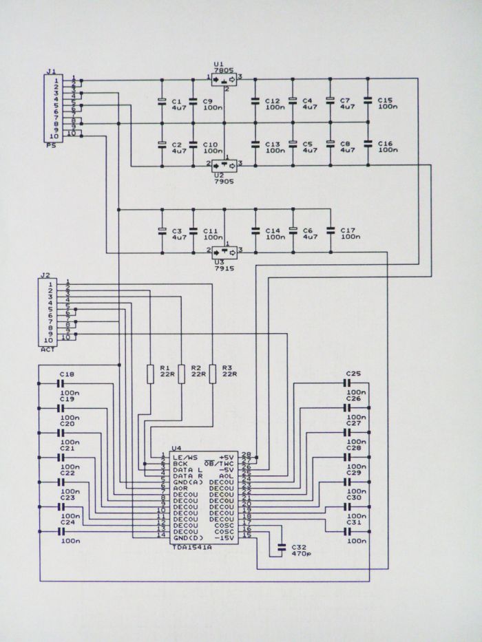

DAC module schematics
Hi, all
Here is the schematic diagram of a single DAC module I used in the D-I DAC. The quad-DAC board has 4 of these identical modules on one PCB. The design is compact and straight forward. A printed circuit board layout will follow next.
J1 and J2 are 10 way single row pin headers
U1...U3 voltage regulators +5V, -5V and -15V respectively
C1...C8 are tantalium cap's 4.7uF / 35V. Black marker on PCB indicates minus, long wire / marker on the tantalium cap's indicates plus
C9...C17 are 1206 size X7R SMD cap's for power supply decoupling
C18...C31 are 100nF film capacitors from BC components for TDA1541A decoupling
C32 is 470pF polystyrene cap (will be modified later for DEM clock synchronizing, probably 100pF capacitor with jumper and addittional pin)
R1...R3 are 22 Ohm resistors (MRS25)
U4 is 28 pin socket with turned pin's for TDA1541A

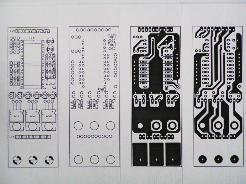

DAC module PCB layout
Hi all,
Here is the double sided PCB layout of the DAC module, so you can have a look at it, or use it to make your own double sided PCB.
From left to right: silkscreen component side, silkscreen solder side, solder side tracks, component side tracks
Exact board size is 1.4" X 3.95" or 35.56mm X 100.33mm. The board holds 2 separate parts: the main board and a small voltage regulator insulating PCB (the part with the 3 rectangles). This part is placed between the DAC board and the 3 voltage regulators, rectangles facing towards the voltage regulators. You can also place 4 of these identical modules on one circuit board to make a quad DAC PCB like I did, but pin spacing between 2 modules must be exactly 1.45" or 36.83mm so it will fit on the main board later on.
Tracks are kept as short as possible, power supply decoupling cap's are placed directly at the semiconductor pin's. Each DAC module has it's own fully separated power supply (crosstalk), with very short connections to the DAC chip (this method already proved itself in the prototype). Digital and analog ground are fully separated. Ground planes and tracks are used for minimizing interference. Modular setup enables easy star grounding scheme. The main board holds addittional (power supply and I2S) filters to obtain both a very clean power supply and clean digital signals.
First 5 trough metalizations have to be placed (wires)
The 28 pin socket, resistors and voltage regulators have to be soldered at both sides of the PCB. All other components either on the component side (pinheaders) or solder side (cap's)
C9...17 are SMD 1206 cap's that are soldered directly on the solder side
DEM clock synchronizing: The DAC modules can use either the standard 470pF cap's or DEM clock synchronizing with BCK. With BCK synchronizing a 100pF capacitor is used instead of the 470pF, and this cap is routed to a 176.4KHz clock (divider placed on main board). I have to figure out how to do this in a way that causes minimal interference. So either an existing pin is assigned for this, or an addittional pin is placed very close to the 100pF cap.

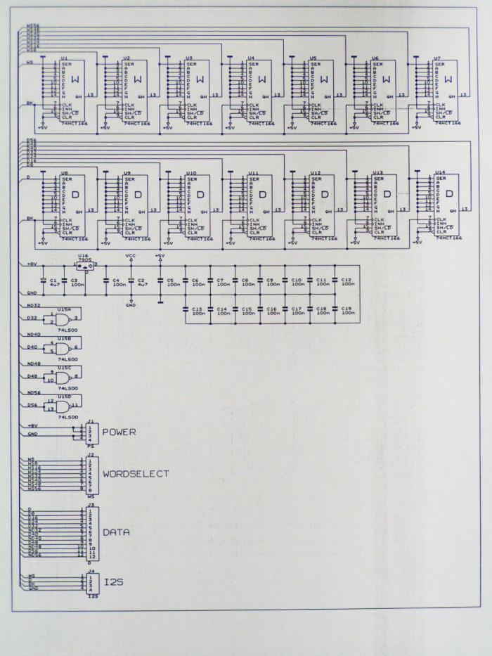

Timing chain module schematics
Hi, all
Here is the schematic diagram of the timing chain module I used in the D-I DAC. It supports dual, quad and octal D-I DAC. The design is straight forward, but could be simplified (post #52 by dddac). A printed circuit board layout will follow next.
J1 ... J4 are single row pin headers
U1 voltage regulator +5V
C1, C2 are tantalium cap's 4.7uF / 35V. Black marker on PCB indicates minus, long wire / marker on the tantalium cap's indicates plus
C3...C19 are 1206 size X7R SMD cap's for power supply decoupling
U1...U14 are 74HC(T)166 synchronous serial shiftregisters
U15 is 74HC(T)00 quad NAND gates (indicated as LS in schematics)
Power supply:
+8VDC...+15VDC
Inputs I2S:
BCK (must be buffered), DATA, WORDSELECT
Outputs WORDSELECT:
WS, WS8, WS16, WS24, WS32, WS40, WS48, WS56
Outputs DATA:
D, D8, D16, D24, D32, ND32, D40, ND40, D48, ND48, D56, ND56

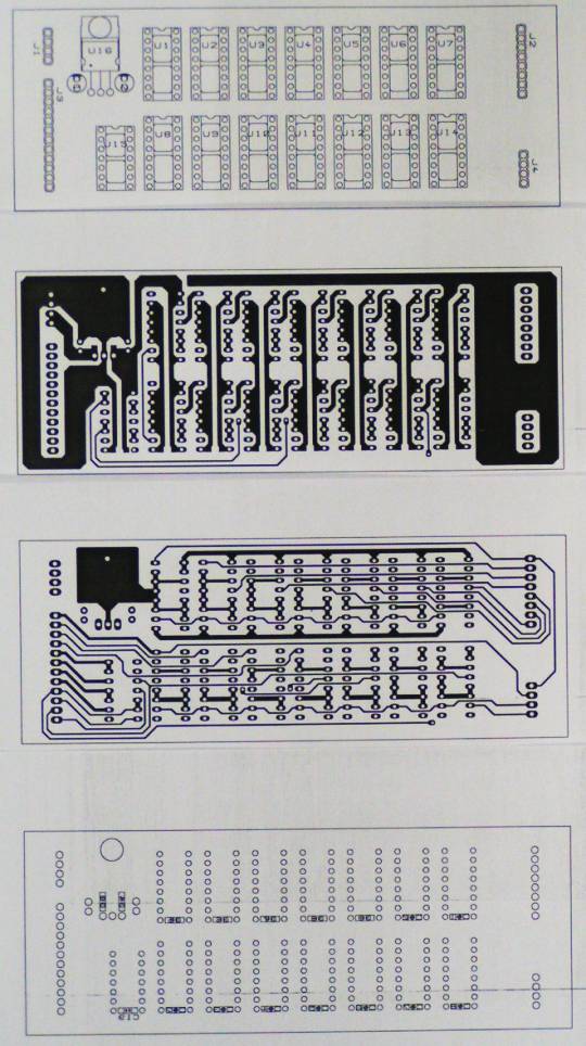

Timing chain module PCB layout
Hi all,
Here is the double sided PCB layout of the timing chain module, so you can have a look at it, or use it to make your own double sided PCB. Perhaps this module is simplified later on, but this version works fine.
From top to bottom: silkscreen component side, solder side tracks, component side tracks, silkscreen solder side.
Exact board size is 5.75" X 2.15" or 146.05mm X 54.61mm.
Power supply decoupling cap's are placed directly at the semiconductor pin's. The timing chain board has it's own 5V power supply regulator.
First 3 trough metalizations have to be placed (wires)
U1...U15 (14 / 16 pin sockets), and voltage regulator have to be soldered at both sides of the PCB. I soldered the sockets at the solder side first, then heated the pin's at the solder side and applied soldering tin at the component side when the pin was heated up enough. This is necessary as the sockets are placed close together, it avoids damaging the socket's plastic frame. Check/measure for short circuits after each socket is soldered in place, because removing short circuits when all sockets are placed could become quite problematic.
All other components either on the component side (pinheaders) or solder side (cap's). Note that J1 pin's must be soldered on both sides.
C3...19 are SMD 1206 cap's that are soldered directly on the solder side

Hi, X.G.
Thanks for your reply (post#195)
I had a look at the URL you posted (especially at the circuit board and schematic diagrams). You indicated about the same things I already noticed:
- a standard NOS-DAC has less detail but more natural "open" sound
- a NOS-DAC with filter has more detail, but it's sound is not so natural / "open" anymore
- a oversampling DAC has more detail, but the sound is not so natural "open"
- a "NOS-DAC" with a CS8420 sample rate converter (upsampling) has both, more detail, and the sound is more natural / "open"
When I designed the D-I DAC, I tried to get a smoother output signal (less harmonics in the audio range and no need for filtering). This is done by using "copies" of one sample and place them on regular distances within 64BCK clock cycles. This way you get more "samples" within the 64BCK cycle. Then the outputs of all DAC's are added together, so the copied samples also form a higher resolution (amplitude). See post#34 for a graphic representation using only 2 DAC's. With 4 or 8 DAC's basically the same happens. With an octal DAC you get a theoretical resolution of 19 bits and a virtual sample rate of 352.8KHz.
I am quite happy with the sound now, I tried some other "tricks" like non-linear interpolation, but the sound quality even seem to get worse. I know it's not perfect according to theoretical analysis, but it's a great improvement compared to the standard NOS-DAC.

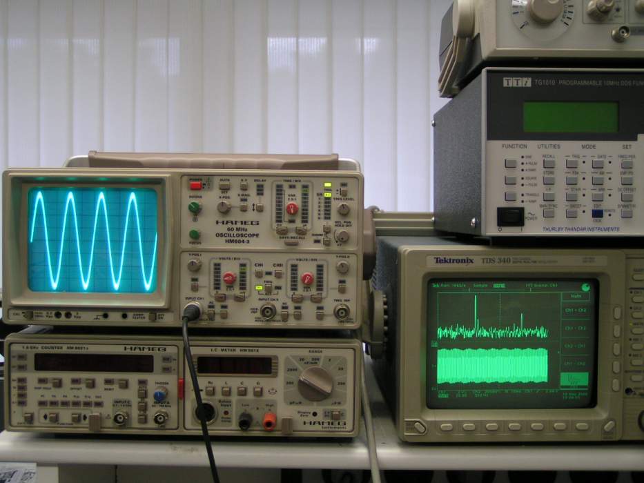

I also added a photo of a 8000Hz sinewave and FFT scan of the unfiltered octal D-I DAC.
I also build several tube output stages in the past days. One of them is a differential triode amplifier with a transistor stabilizer on the annode voltage. The differential triode amp is then fed into a cathode follower. I use a "hybrid" setup with OPA627 I/V converters and a tube output stage. The sound is very transparent, and you also get a differential output (well I needed 2 double triodes anyway), but I can't seem to eliminate the noise that is produced by the tubes. So now I am trying to create a very high amplitude signal (easy when using op-amp I/V converters) and attenuate the output, this seems to reduce the noise quite a bit.
