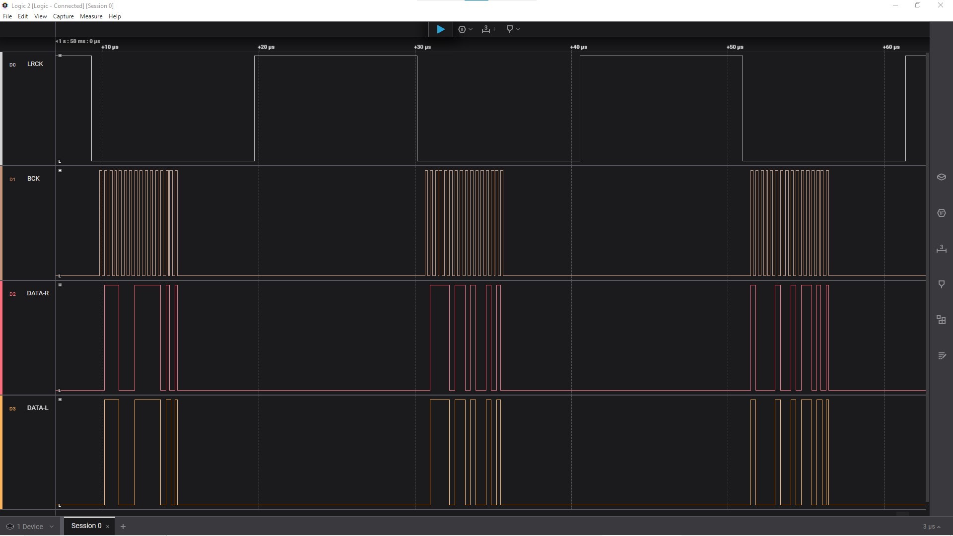

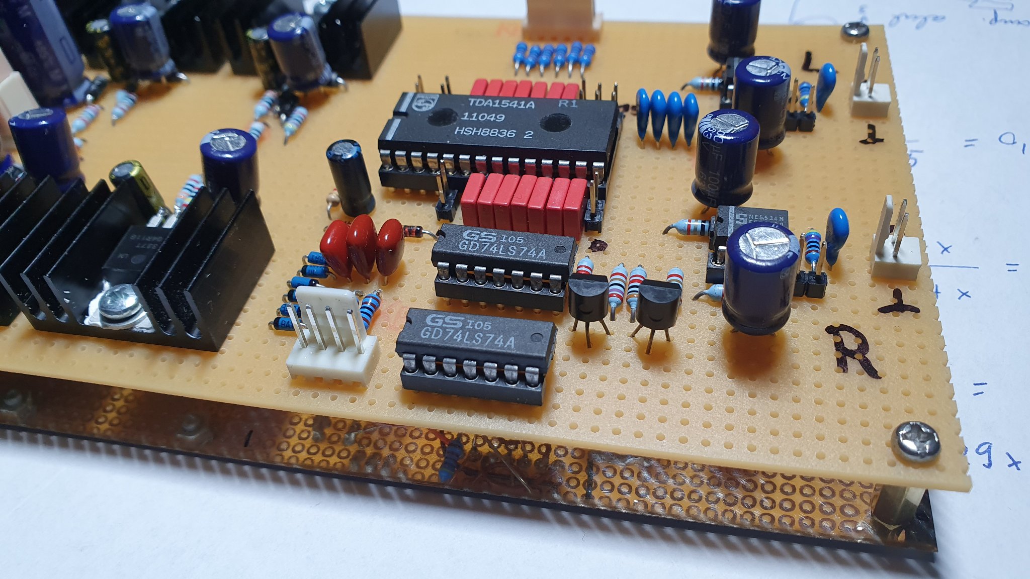

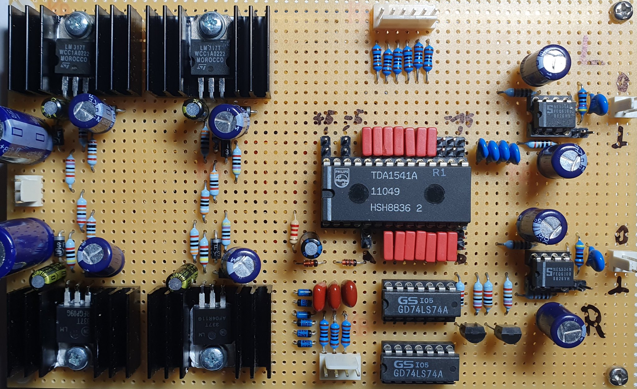

Did You mod something or ot is as it is on the sch? And didYou use same types of ICs for all ICs?
Do You have some signal Measurements?
Thanks 🙂
Here is the logic capture of the output with 1Khz signal :
