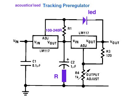

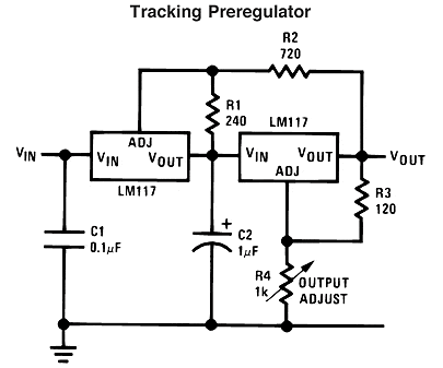

When I mention the Tracking preregulator, it is for minimum added parts for imroving psrr and stability?
Because the regulator is constantly in operation charging super-capacitors.
It is just one LM reg and few passive elements more.
Example at
http://www.acoustica.org.uk/t/3pin_reg_notes4.html
original from datasheet
a bit improved
Once I made the version with L FB at outputs of each LM. It was better than standard with one LM regulator.

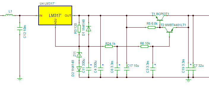

PS, IF I where to this soft of thing in this project, what I'd do would look more like this:
Sometimes with a FET as pass element for lower impedance where that matters. The output circuit can be adjusted and tuned for the best compromise between all relevant parameters.
Self noise of the Output Regulator is ~1.5nV |/Hz or a fraction of 1uV noise because T2 is a SMD variant of the magic 2N4401 "switching transistor". Z
It kills enough of what is on the output of the 317 to leave only the self noise.
This version here is intended for clock circuits, the very large value electrolytic capacitors are there to kill close in noise, with 0.050Hz and 0.005Hz turnover.
Many clocks do not start up clean with a slow PSU ramp, in this case add a relay on the base, to keep the base a 0V until the voltage is stable. Something like a modern 555 might answer the purpose adequately.
However, in my current application I am not size/cost constrained, so I want to keep it as passive as possible.
Thor

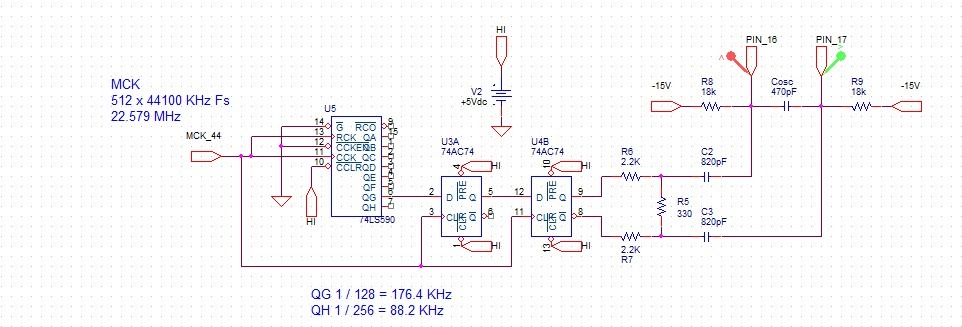

@Zoran, hello
With flip flops, do you think the John's sim mode is the simpliest way to to it ?
I think that is the good way? Not sure which version is actually build, working and eventually measured?
But it is the elegant concept with reduced elements amount.
And I think there is a version with -Data for ballanced mode.
Maybe this is OK for TDA1541A, for employ L-R segments in say -L/+L for one and same for R channel to have dual mono balanced configuration with 2 DAC chips? In that case theese diskrete IVs, can be used as -180deg phase, and with simple -DATA part will be +Analog Out (and for +DATA other 1/2 DAC will be -Analog Out
No need for "switching oposite" the loudspeaker polarty... To make the things "right"...😡
Disadvantage is that Johns very good idea, is only for TDA1541A chip. 🙁 Probably can be rearanged for other DACs too?
Because of that I tried to make it more versatile, to cover "All" old school DAC-s. (inclouding TDA1540). Even diskrete R2R parallel bits datas can be used for Diskrete DAC up to 32bit per channel in Simouuktaneous mode with stopped clock...
But unfortunately I didn't build the piece to test yet. (It is "working" in the sims, BUT it could be not the case of real circuit...)
Would like to ask again, why BCK and not MCK divided down to sync to DEM (16,17).
Cheers
I will try do it with MCK

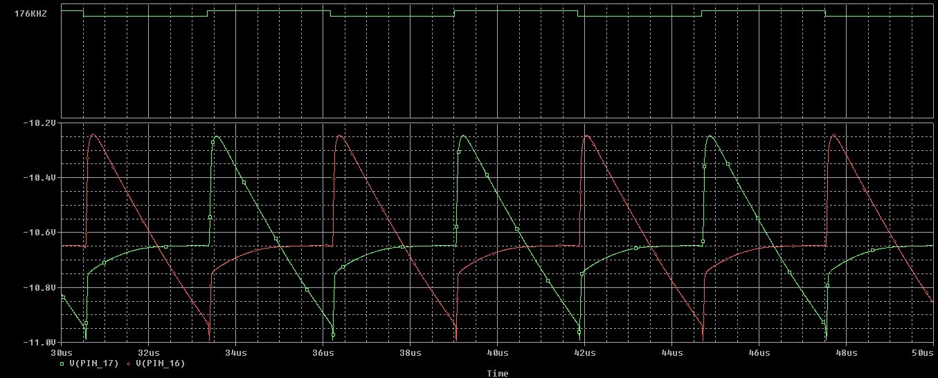

Something like this with 512 x MCK
with 590 counter IC, other types is also OK
(For 1025 x MCK same topology but last counter out QH is for 176KHz)
(The inside oscilator part circuit of DEM DAC is same as Thorsten posted...)
It is with A version and external 470pF. 2 x R to -15V values for 0.2mA cca.
