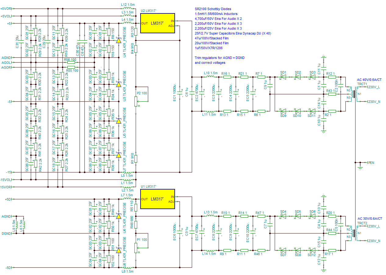

I said I would show the "Super Capacitor" version of the power supply that is fully split A/D. including analog stages.
Here you go:
Regulation is simple. The main AC Impedance and Noise specifications are down to the super capacitors. The rest of the circuit is made simple, with common mode noise conduction significantly reduced.
Most TL431 are actually "protection" circuits for start-up.
Only the +5V ones should be active.
Thor
If You insist on LM317 ICs I can suggest to add just one same IC for each one, for "Tracking pre-regulator" configuration.
I made it once and it was better than classic one IC regulator...
One note about 317 specimens:
Contemporary versions are somehow "not good". to not to use other word starting with "Sh" 🙁
I had a mush better results with "old" Motorola 317/337. But it may be harder to find.
Anyway, if Motorola is unobtainable i suggest to use some types with better, more mass, integrated body heatsink?
And, 🙂
You switch to 2 x power suply for A and D for 2 x +5V A/D and for 2 x -5V A/D.
Sharing common "GND" potential points (L connected)
I draw earlier posted in topic, modular schematic but for only 2 x -5V A/D line power. Which was considered as booth A and D function...
I think the same treatment for 2 x +5V for A + D power, "sharing" the "GNDs" points is better.
And it is not huge addition and complexity for one transformer and PS units.
I will draw the concept SCH
TDA1541A deserves very good treatment in that way for sure 🙂

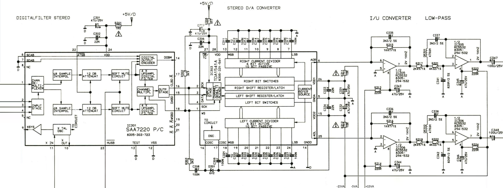

Hi thanks for the answer.There is a theoretical possibility (yet to be proved) that the DEM oscillator might interfere with the BCK and/or with the LE signal, causing spurious signal in the audio band. This could be be due to on-chip leakage, ground bounce, whatever. I think that syncing the DEM oscillator to LE signal (á la Grundig in 4x OS) or to the divided MCK or BCK would not harm, it does not increase coplexity too much. In any case, I would not go beyond 176.4 kHz, regardless I don't believe in the "4-times sample rate" rule. Even 50 Hz DEM clock worked fine, with properly sized decoupling capacitors, didn't it? Most important is perfect (I mean rigorously perfect) 1:1 symmetry of the DEM oscillator duty cycle. It should be also jitter-free, naturally.
I think that the PHI/Grundig LE based 176.4KHz are fixed fo.
Because CD format is 44.1KHz and they use OS SAAxxxx digital 4 x OS.
And that is more related to audio band and original SR/2 audio HF?
For max sample rate HF -3db fo will be 1/2 so it is 176.4KHz still (or 192KHz for 48KHz base)
Anyway I was asked because it seems to me that is best solution to use some counter and derive DEM 16.17 Fo
from MCK
Since the C on MSB to MSB-7 pins are calculated for say 176.4KHz,
They are not.
My calculations only state the MINIMUM capacitance that is likely to attenuate the worst case ripple from the DEM circuit to a level where it is less than 1/2 MSB, at a given frequency.
So Capacitors are the lowest values that should be used for this circuit, not a "tuned" value.
You can use more capacitance, you can use less. Less capacitance will best be used with DEM frequencies that integer multiples of the sample rate with minimum recommended ratio being 1:4, that is Fdem = 4 X Fs. but if not used with a reliably locked DEM clock the result is simply greater error than 1/2 LSB with the worst case tolerances in the DEM circuit.
Would it be good to have also constant Fo of 176.4KHz at DEM oscillator (pins 16, 17)?
Note:
Only in case of 44.1KHz Sampling rate,
Well, if you only ever see 44.1kHz Fs (inside a CDP), then setting Fdem to 176.4khz is valid. It can be done while bypassing the SAA7220 (but retaining it in place) and using SAA7220 BCK to drive a Grundig DEM Sync.
In every Sample rate increase, the external DEM oscilator Fo is higher for SR x n times
while DEM MSB pins remain fixed 176.4KHz
This can be done. The consequence is that for each sample less than 4 DEM Cycles occur (at 8X Sample rates we get 4 DEM cycles in 8 samples).
It means the potential for errors at each sample is increased. If using my minimum value calculation errors should be reliably < 1.2 LSB, in practice probably significantly less.
I don't think this exists.
BUT there is a real and proven mechanism by which BCK, Data & LE signals can interfere across the whole chip. Namely the planar PNP input transistor with collector to substrate has a large collector to Base (Miller) capacitance that is charged /discharged at every edge via the substrate.
The substrate has a significance resistance to either GND pin and capacitively couples into every part of the IC.
Another proven mechanism causes DEM Clock sub harmonic leakage into the Audio Output, that is the ripple at the DEM Filter capacitor pins being insufficiently attenuated by the DEM Filter Capacitor.
Both are very real.
If both mechanisms are active at sufficient levels (e.g. a "cooking" SAA7220 + TDA1541 design with 100nF capacitors and free running OSC will cause beat notes, the relatively poor stability of the DEM oscillator will cause low level IMD that can fold back into the audible range.
Syncing the DEM clock to audio clocks of at least 4 X Fs causes these subharmonic edges to line up with the audio clock edges.
Using larger Cdem Values attenuated the DEM clock feedthrough into the audio output.
Using slew rate and voltage swing limited input signals (at the simplest a series resistor of ~1.32k, when modifying existing gear) attenuates audio clock/signal feedthrough.
So a minimum mod set for existing DAC's might be Grundig DEM sync and 1.32k resistor (~10MHz lowpass) in the Data/Clock lines. Improvements by this simple set of measures is bound to be substantial, I will be able to test on my PM-75.
There is no "4 X Rule", just in this case a number of mathematical constructs sum reliably back to zero (though the ~10...20nS switching glitch at fDEM throws a spanner into the practical works), allowing in theory the DEM Filter capacitors to be discarded.
We can look at two unrealistic but instructive cases.
1) Cdem = oo - this means once the system is stable (long after the end of the universe) we can disable not just DEM switching but any current from DEM.
2) Fdem = oo - this means we do not need Cdem at all.
As the DEM clock is divided by a ring counter a precise 50% duty cycle is not very important. Having a very stable frequency however is important. Dividing BCK will do that, as will dividing MCK. One will create a 4X clock, the other a fixed clock.
Due the limited switching speed of the transistors in the DEM circuit, the higher the DEM frequency the greater the frequency of these glitches, which cannot be considered reliably independent from the remaining IC state. Everything is a trade-off.
The glitches in my view are less relevant if layout and DEM/AOL/AOR/+5V decoupling are handled right, this can even be done in modifications of existing gear. Kapton tape insulator and copper Foil to make a AGND or (preferred) -15V plane every decoupling capacitor is bonded into below the IC. So the DEM frequency becomes a little less relevant.
No point. You could also use other IC's, e.g. 7810 for the +/- 5V Digital.
They do not need to be low noise or low impedance. Just hold DC voltage steady.
The DCR of inductors and the Super Capacitors capacitance create an ~0.01Hz lowpass with around 38dB attenuation of noise at 10Hz and a second roll-off above ~150Hz, reaching ~54dB attenuation at 1kHz. The regulator is basically immaterial in the context.
Add to that the common and differential mode noise attenuation of mains noise to ~2.8mV PP before the regulator and really almost any reg will do. This is actually the point of this otherwise overly complex PSU. Let the supercapacitors totally dominate noise and impedance, build the highest possible firewall for unwanted noise on the mains side.

Remember, +5V to -15V is the main loop for audio, it needs a fast low impedance path. AGND is the supply for the DEM circuit and -15V is the AC Reference/GND for the DEM circuit.
AOL/AOR and +5V are current outputs for current from DEM. There is no analogue supply current here, but 8mA in total flow here, out of ~22...27mA total current in -15V, the audio signal current.
So
-15V = 22...27mA
AGND = 22...27mA - 8mA = 14...19mA
AOL = 0....4mA
AOR = 0....4mA
+5V = 0....8mA (sum of inverse of AOL/AOR current)
where Iaol +Iaor + I5v = 8mA
Then +5V is Digital CML supply (kinda PECL) and -5V is supply for CML (ECL with - supply) driving bit switches. Reference DGND.
+5V & -5V draw similar current with less for +5V.

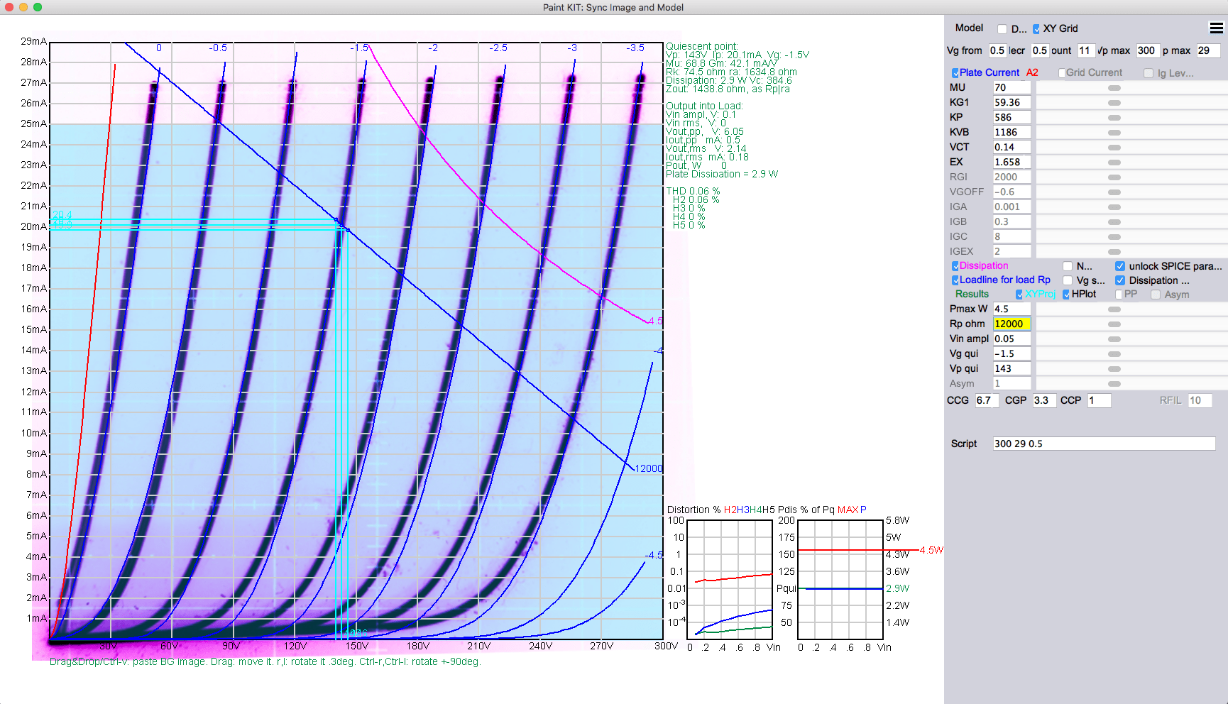

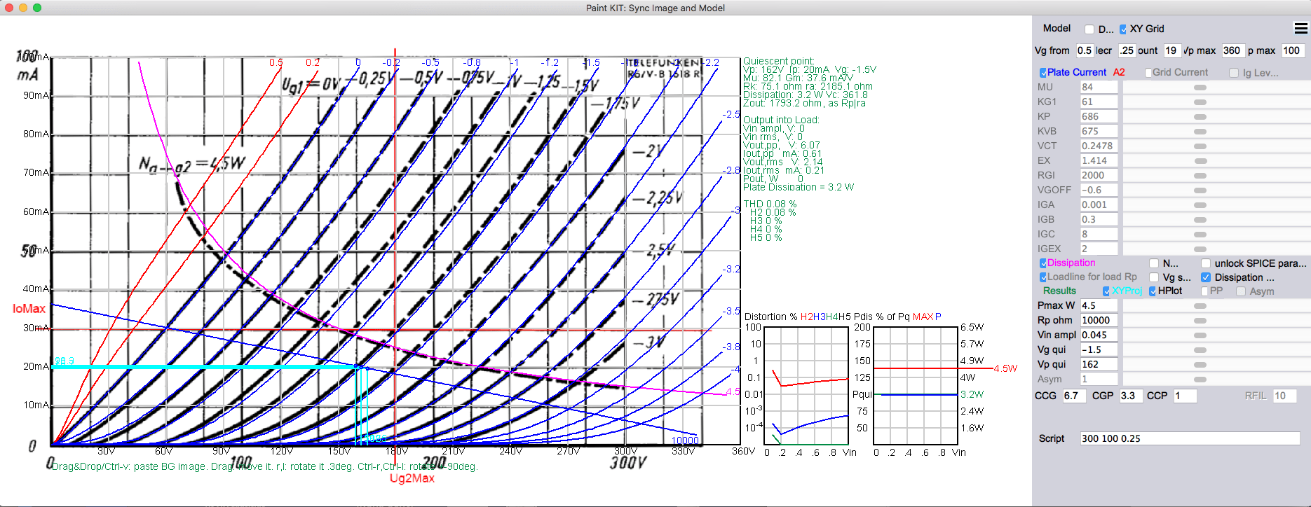

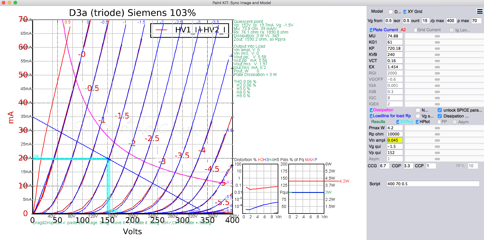

There is some interest for D3a tube. In triode mode.
I collect some informations and made few PSpice models.
I made spice models for G2-A, G3-K with Telefunken and Siemens datasheet measurements.
Note that in this configuration capacitnces are different...
Also I made a model with Vinil Saveour measurements for G2,G3-A
As for some bartola Siemens specimen type measurements check.
Other 2 models are from barola measurements and they are prety close, but not the same.
All spice models are in the form of .inc (incloude) file and they are in .zip archive.

TDA1541 Modkateer Redux
Well, this analysis overall proved worthwhile. While trying to understand what goes on and why a certain design aspect changes the sound quality offends some in this thread, overall I think it helps.
When it comes to DEM filtering and clocking, we have seen the OP (John / ecdesigns) tried out anything from no DEM filter capacitors and a several MHz DEM frequency to 100uF Electrolytic Capacitors (not even low leakage types) with 50Hz DEM Clock. Not once did he report "bad sound", so I conclude the TDA1541 sounds pretty good no matter what you do.
We discussed a lot for new designs, but for those with existing DAC's based on China PCB's, existing classic gear etc. these are usually not feasible. Let's see what we can do.
After our expedition deep into the TDA1541 nether regions, I would say that this early 90's design by Grundig (for Philips) holds up well:
The 1uF MSB Cap's are spot on. DEM Sync to WCK from SAA7220 also.
So if we modify some existing gear this is a good start.
With my recommendations it get's us here:
Added LC filtering for SAA7220 & TDA1541 Supplies and use of large value Os-Con. Ideally there is a Kapton tape + copper tape) DGND Plane under the SAA7220 to the TDA1541 Pin14.
Series resistors in the digital signals to slow down the edges.
TDA1541 uses 1uF for the 2 MSB Pin's (easiest) to minimise DEM ripple entering the audio circuit.
I/U stage Op-Amp changed to OPA2156 (or OPA1656). Here deliberately there is no offset current. The Op-Amp output is thus forced to ~ +3V and biases the output stage naturally into SE Class A. The I/U stage also has a pair of 10nF capacitors to DGND that help to avoid the Op-Amp slewing at fast edges.
Little item easily missed, the capacitors on +15V Op-Amp are returned to +5V, not AGND. Ideally one Dual OPA is used for the first stage and a second for the Output. In that case the output gets separate decoupling.
The output stage is a simple buffer, with DC removal (1uF Film Cap) and classic SK lowpass. The output DC will be a few mV worst case, so coupling capacitors can be omitted. Build out resistors (say 51R) are needed.
This is something I will have a go at with my Marantz PM-75 restoration.
Thor
