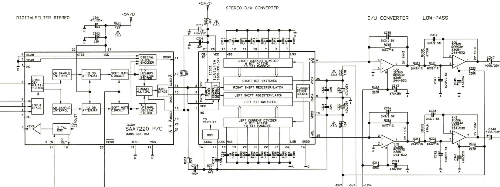

hi thor, I'm using DEM Grunding without filter (NOS) and in SIM mode. Also my caps are: 1x 4.7uF + 1x 1uF + 5x 0.47uF. I must say that it works without problems but I would like to verify that it is optimally sized. How could I do it?TDA1541 Modkateer Redux
Well, this analysis overall proved worthwhile. While trying to understand what goes on and why a certain design aspect changes the sound quality offends some in this thread, overall I think it helps.
When it comes to DEM filtering and clocking, we have seen the OP (John / ecdesigns) tried out anything from no DEM filter capacitors and a several MHz DEM frequency to 100uF Electrolytic Capacitors (not even low leakage types) with 50Hz DEM Clock. Not once did he report "bad sound", so I conclude the TDA1541 sounds pretty good no matter what you do.
We discussed a lot for new designs, but for those with existing DAC's based on China PCB's, existing classic gear etc. these are usually not feasible. Let's see what we can do.
After our expedition deep into the TDA1541 nether regions, I would say that this early 90's design by Grundig (for Philips) holds up well:
The 1uF MSB Cap's are spot on. DEM Sync to WCK from SAA7220 also.
So if we modify some existing gear this is a good start.

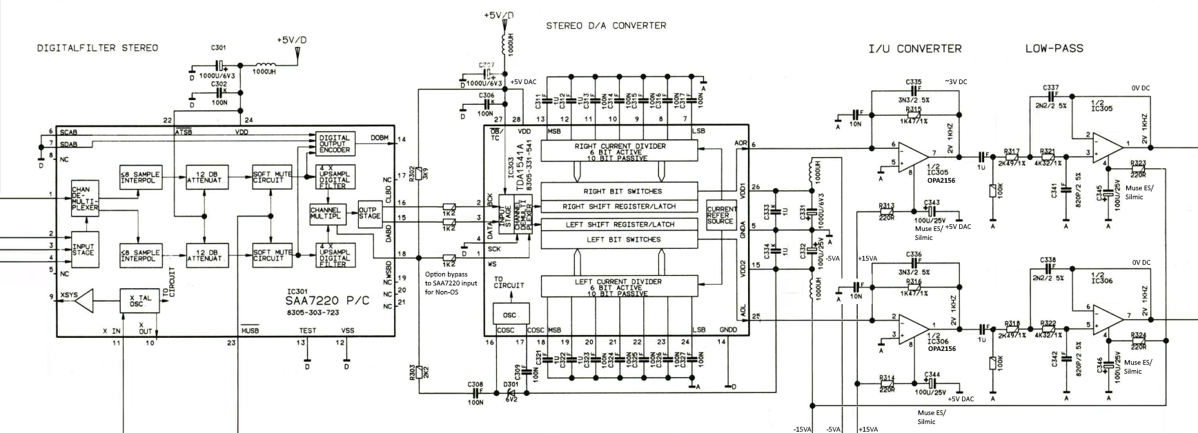

With my recommendations it get's us here:
Added LC filtering for SAA7220 & TDA1541 Supplies and use of large value Os-Con. Ideally there is a Kapton tape + copper tape) DGND Plane under the SAA7220 to the TDA1541 Pin14.
Series resistors in the digital signals to slow down the edges.
TDA1541 uses 1uF for the 2 MSB Pin's (easiest) to minimise DEM ripple entering the audio circuit.
I/U stage Op-Amp changed to OPA2156 (or OPA1656). Here deliberately there is no offset current. The Op-Amp output is thus forced to ~ +3V and biases the output stage naturally into SE Class A. The I/U stage also has a pair of 10nF capacitors to DGND that help to avoid the Op-Amp slewing at fast edges.
Little item easily missed, the capacitors on +15V Op-Amp are returned to +5V, not AGND. Ideally one Dual OPA is used for the first stage and a second for the Output. In that case the output gets separate decoupling.
The output stage is a simple buffer, with DC removal (1uF Film Cap) and classic SK lowpass. The output DC will be a few mV worst case, so coupling capacitors can be omitted. Build out resistors (say 51R) are needed.
