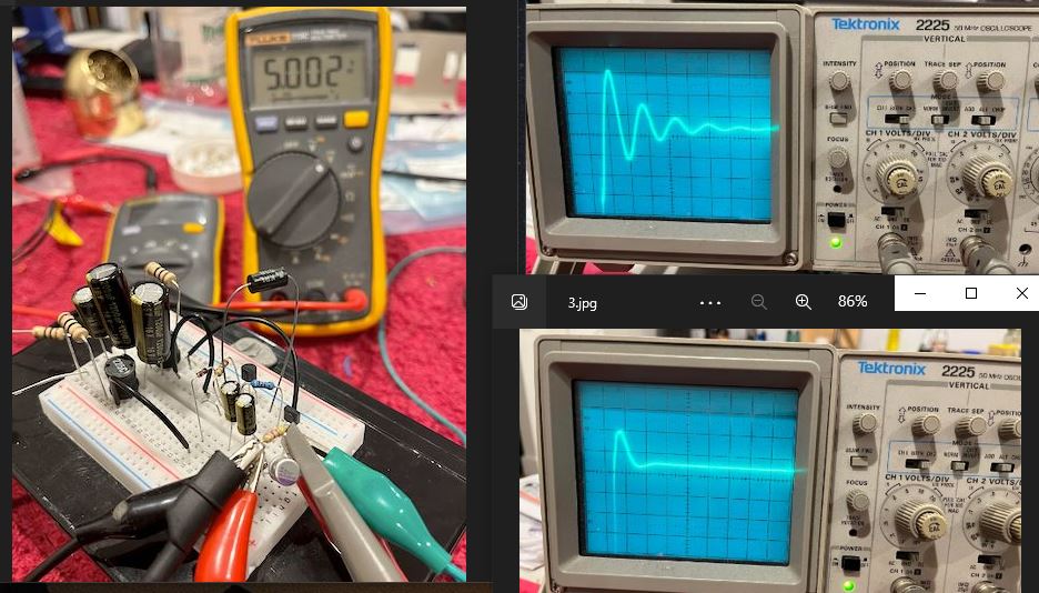

The tube rectifier (if running on the same transformer) damps transformer ringing and switching noise.
This is the ringing that I observed on a '1541A' transformer with separate and screened secondaries (for all) with schottky bridge into 10R CM resistors and reasonably low value capacitance (1000uF). Both with and without 'snubber'. The snubber circuit is that developed by the 'Quasimodo' guy, values as determined by scope.
On the veroboard, I added a three-pin header at each of the supplies to 'jump' it in or out of circuit.
