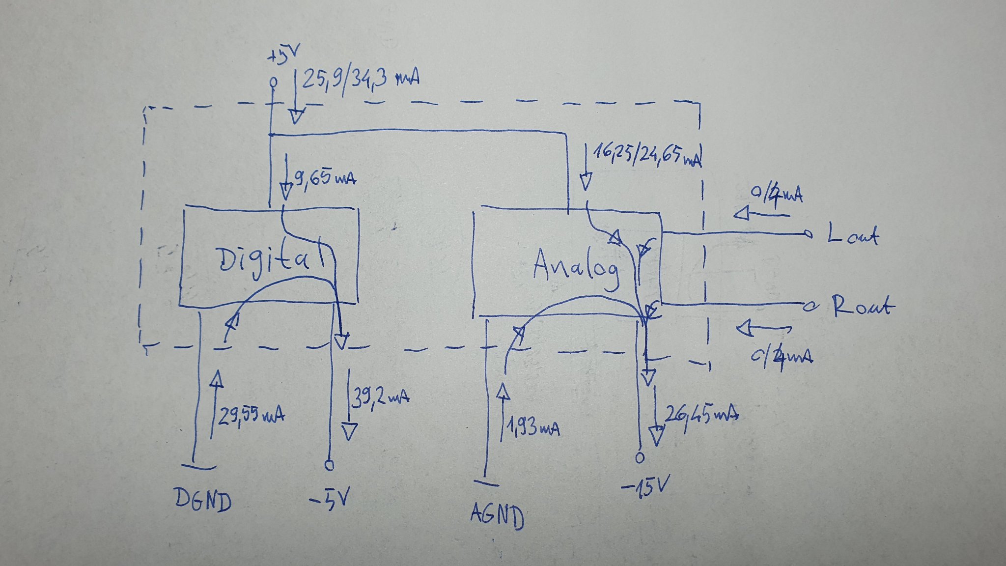

I measured the actual currents right at the supply/GND pins.
+5 V: 30.0 mA at -2 mA output current. 25.9 mA at -4 mA output current. 34.3 mA at zero output current.
-5 V: 39.2 mA fixed
-15 V: 26.45 mA fixed
AGND: 1.93 mA fixed
DGND: 29.55 mA fixed
I double checked the AGND current.

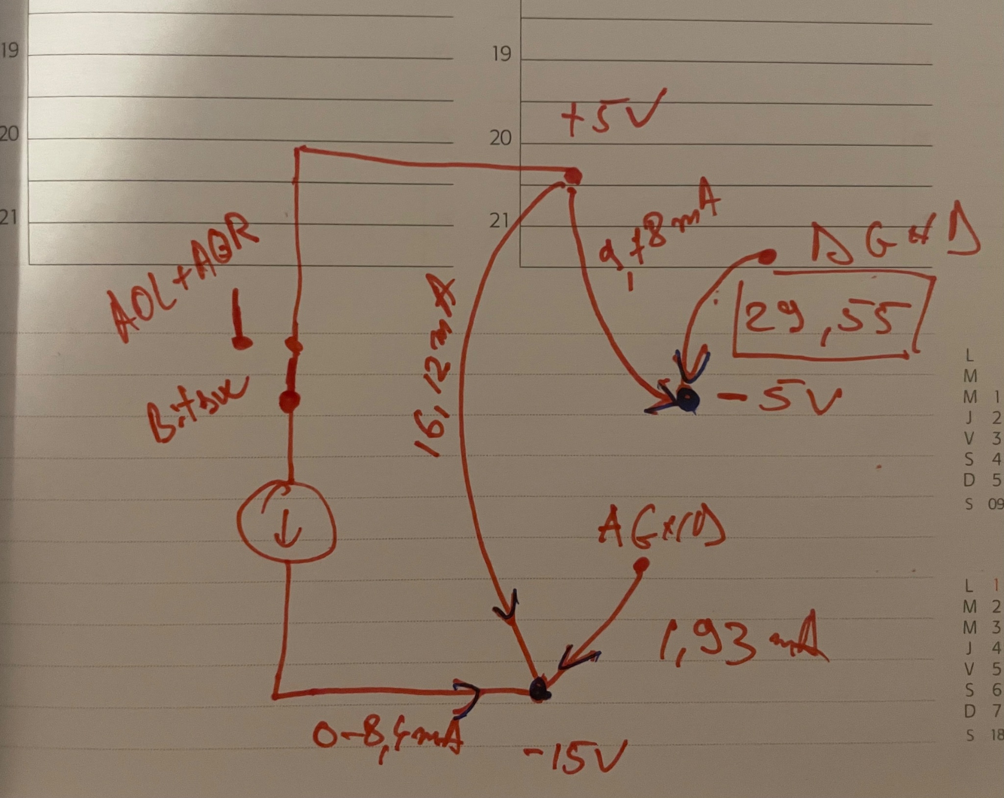

This is excellent work.
For 5V we see 8mA between zero and full scale, with some error for base currents of bit switches. So this follows published design details of the chip and logical conclusions.
For -5V we obviously only feed CML.
I wonder where audio current flows. It shows only up in +5V, but if we close the loop to AGDN (or DGND) we should see variable current with different codes.
Does the Audio current flow into DGND or AGND?
We have up to ~35mA peak flowing in +5V and into DGND.
We have 39.2mA fixed flow out of -5V (or -39.2mA flow into).
We also have 26.45mA flow out of -15V. So 65.65mA totally flow from AGND & DGND towards -5/-15V.
An average of 30mA flows from +5V into DGND/AGND.
This leaves 35.65mA flowing in the grounds.
We have 29.55mA in DGND leaving 6.1mA to reconcile.
We have 1.93mA reported in AGND reported. Leaving 4.17mA to reconcile. Could this be the two channels ~2mA?
Do they flow into AGND?
I think we have all currents accounted for, just where the current from AOL/AOR returns in unclear, they are left as an irreconcilable 4.17mA amount given the reported numbers.
Still, we have a few conclusions.
First conclusion, AGND is NOT a supply pin, but mostly a "reference". The current for the DEM logic comes from DGND.
Second conclusion, we cannot really separate AGND and DGND.
Third, we are back to a "zener chain" as "optimum" supply.

I think this is correct (+/- 1 or 2 mA).
Audio corrent flows from +5V and Iout (L, R) to -15 V. Their sum in the analog path is constant.
I think the +5 V should be well filtered, because the current draw is some fixed value (34.3 mA) minus the (L, R) output current (0 to 8 mA) so it is heavily changing.
The current flowing into -15 V (cca. 26.5 mA) is constant, it is easier to filter it. And there are some current generators at the bit switches IIRC, so it further relaxes the filter requirement here.
