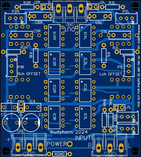

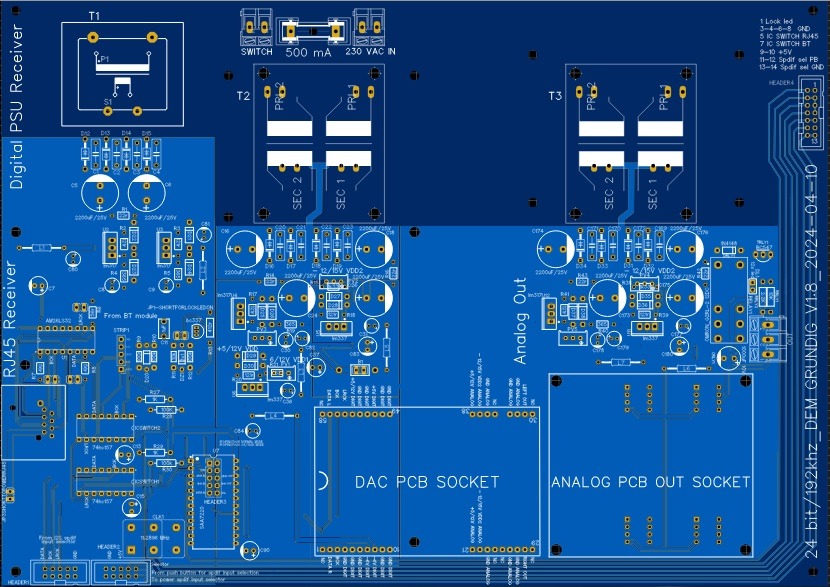

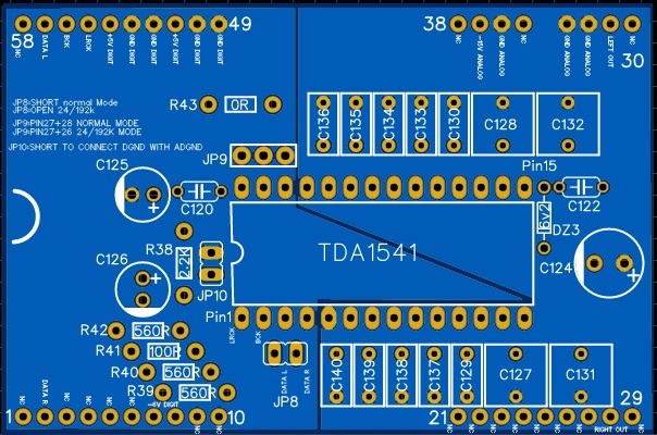

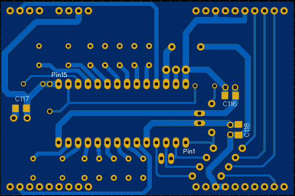

For TH lovers, I personally could share the entire project of my MODULAR DAC, I believe that the big advantage is that of being able to change both the dac chip module (with some modifications on the PSU) and the analog output stage (currently 3xAD844 per channel).
If you are interested I can attach the Json files (EasyEda).
Perhaps it could be a good starting point for a DAC that also includes balanced I2S (RJ45) input and optional Bluetooth.
As a SPDIF receiver I used an AK4113 card which I connected to the DAC obviously in I2S.
As for the DEM I used the "simple" Grundig technique.
The TDA also works in SIM mode via SAA7220 to CPLD converter
published a few pages back.
Sorry for my english!
Antonio
https://it.aliexpress.com/item/1005002922474547.html

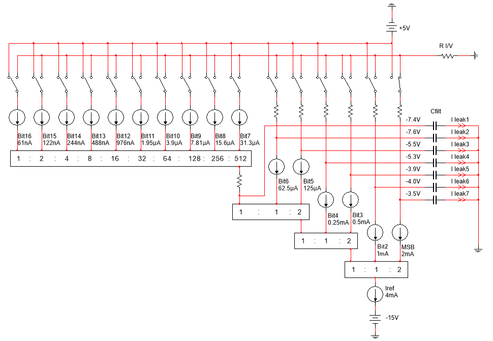

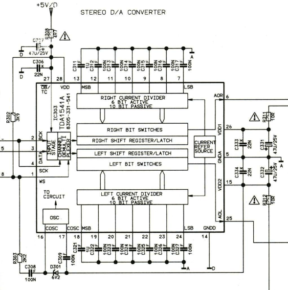

Hi there are some PDFs about the DEM pins Fo calculations according to @ThorstenL proposed.
It is from the MatCad software, if Someone want to have I can post .mcd files.
(But it is not so complicated could be done with Excel?)
Please take a look for eventual mistakes?
I also was interested how it reacts for TDA1540 dac, 14 bit dac, with 10 dem bits, same Iref and higher V@Cmsb.
And compare to typical value that most manufacturers used.
It is without a "grouping" values that can be added latter...
I just have one question about something that is not quite clear?
What is:
"We need to consider the worst case peak-peak ripple current, which is Iref / 4 * 10%."
and
"We need the variation from the ripple current
( 2.5% of 2mA worst case )"
I am asking because, booth sentences giving the same result, but in first we can consider peak-peak ripple current as Iref / 4
and in second sentence, peak-peak ripple current is Iref but % are divided by 4?
What is the real value of peak-peak ripple current?

What is:
and
From this diagram MSB Iref is 2mA so the percentage correction is 2.5%
But this is when the Cs are connected to "GND" not to the "-15V"?
Maybe the voltages trough the DEN oin Cs shoud be considered according to the connection in -15V?
Anyway
The results for C in the PDFs are good, percentages shuld be divide by 4 😎
I will correct it and re-post
What is:
and
The first case states the mathematical rule for the worst case ripple current on exact TDA1541 DEM Filter pin, illustrating the logic, that is each current splitter output is Iref +/-5% but all Iout summed must be equal to Iref.
The second case is simplified for a specific pin with a specific current value, simplified to be used in next round.
The real value of ripple will vary from IC to IC and pin group to pin group. It could be even that there is no difference with some IC's and pins.
The +/-5% number BTW is from RvdP paper on the TDA1540 prototype. It should represent the worst case. Actual production TDA1541 may be better (or not).
In the 80's Chip making was still more alchemy and magik than reliable tech and science the way it is now, with deep UV or extreme UV lithography.
Thor
We normally assume power supplies are 0 Ohm DC to Light, so naturally connecting the capacitors to AGND or -15V makes zero difference in this theory and in theory there is no difference between theory and practice.
Voltage is "across", not "through" capacitors.
Thor

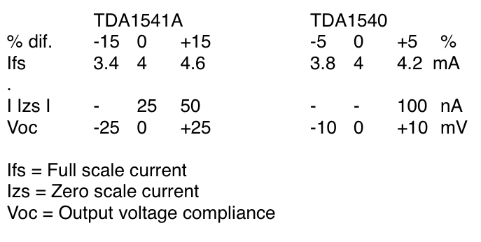

Sorry it is not clear enough this about Iref
The values are from the datasheets
That is for the full scale currents, zero scale currents and output voltage compiliance
Note that ratios of permited Voc values are the same as Ifs. and it is 3 :1
I persume that Iref from the picture abowe
is the same = 4mA
