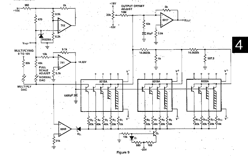

The only other DAC I know that is as legendary as the TDA1540/41 CDP's/DAC's is the Accuphase DC-81 (and related). That uses 4 or 5pcs 4-Bit
bipolar current switches to make in effect a discrete DAC, not R2R but binary weighted:
Discussed here: Information wanted about Accuphase DP-70 DAC: 4 pices Intersil's 4-bit ICL 8019ACPD
Hint, something like that could be added to a TDA1541 to give it more than 16 Bit (with ~110dB SNR it is nearly 18.5 Bit capable IN PRINCIPLE anyway).
It also shows a technique by which a second TDA1541 could be stacked for a 32 Bit DAC with 18.5 Bit ENOB.

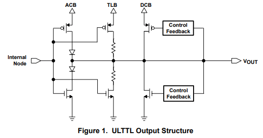

74AUC is very fast, low voltage, but TTL compatible and it uses a special kind of "soft" switching to limit ground bounce.
AUC Little Logic devices provide 8-mA dc drive current at the 1.8-V VCC node for nonportable applications, while maintaining the signal-integrity performance of a 4-mA dc driver. The ULTTL output used in the AUC Little Logic family is designed to address each of the three critical performance requirements previously noted. Figure 1 shows a schematic of the ULTTL output structure.
To achieve the three impedance phases, the ULTTL output utilizes a three-branch p-channel upper-output (UOP) and three-branch n-channel lower-output (LOP) structure (see Figure 1). For the purpose of illustration, the three branches are referred to in this application report as the ac branch (ACB), the transmission-line branch (TLB), and the dc branch (DCB).
The first branch, which uses the diode in the output structure, provides the high dynamic current required to drive through the ac threshold.
The second branch, which contains a series resistor, provides optimized impedance matching into the transmission line.
The third branch provides the additional dc current drive for applications requiring more than 4 mA of output drive current at 1.8-V VCC.
Each independent branch posses a unique on-state resistance (ron). As the output transitions from a low to high (or high to low), the equivalent resistance of all branches varies in a controlled manner by adjusting the individual resistance of each branch. The low-to-high transition functions similarly to the high-to-low transition. The output impedance is controlled during the low-to-high transition sequential action outlined below and shown in Figure 2.
1. During the initial phase of the transition, all three legs are turned on. The parallel ron of all three legs provides very low combined impedance.
2. During the second phase of the transition, the ACB and DCB are turned off, and the output transitions to a higher impedance. As the output voltage level approaches VCC, the series diode begins to saturate and, eventually, becomes reverse biased, causing the current through the ACB to be reduced to less than 1 mA (basically, turned off). A threshold-controlled feedback circuit turns off the DCB. The thresholds are adjusted, to minimize the effect of oscillations directly at the output of the driver before entering the transmission line. (NOTE: A major advantage for the DCB being turned on in the initial stage is to provide support for the ACB at lower VCC ranges where speed often is sacrificed.) The TLB ron is 50 Ω to 65 Ω and, because it is the last branch remaining on, it provides the impedance matching to the transmission line.
3. In the final phase of the transition, the DCB is turned on by the threshold-controlled feedback circuit to provide a combined DCB and TLB equivalent resistance that is satisfactory for driving applications requiring more than 4 mA of output drive current at 1.8-V VCC.

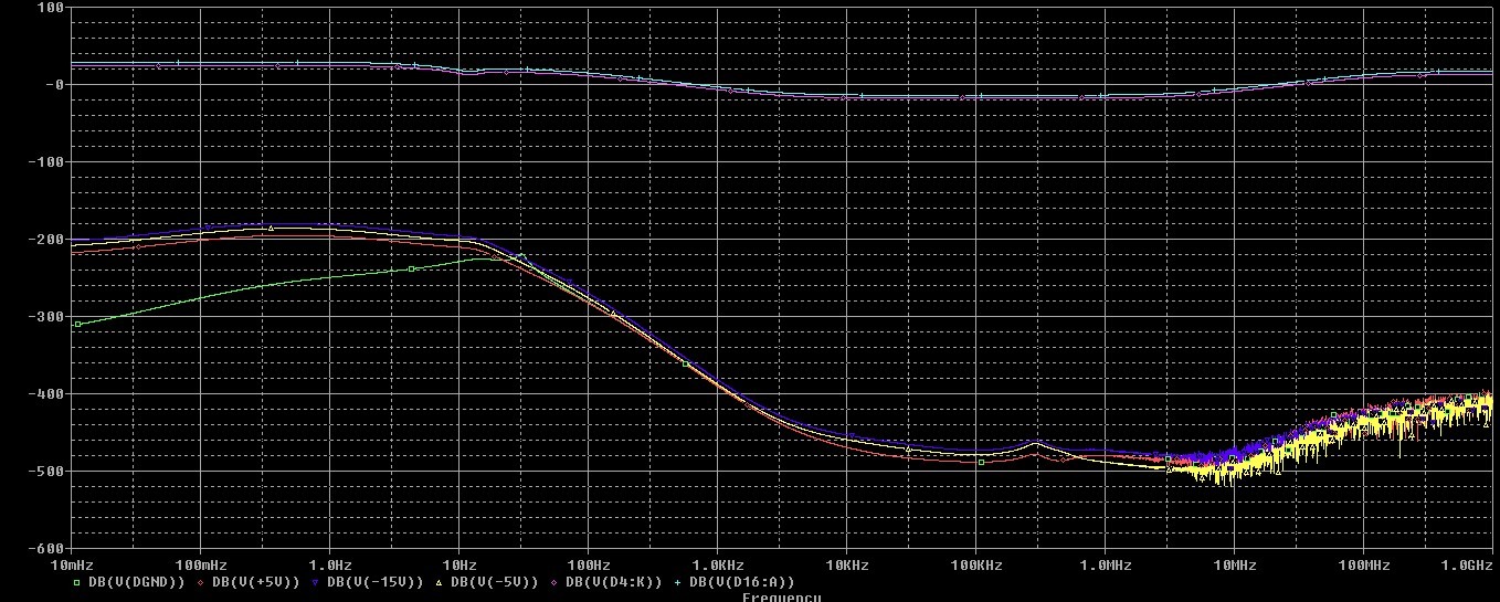

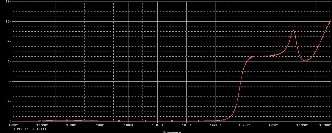

Somebody asked about power supply with lower values of capacitors. (As a complement to one with super-capacitors - battery concept.)
I finished power supply. The version with small values of capacitors. But very effective.
  • Extremely low output impedance.
  • Very good PSRR
  • Relatively simple (modules are repeating...)
  • Very adoptable, values can change, override some components etc.
  • No special parts, exept very low ESR few components absolutely needed for the best chrs.
  • Could be used as separate PCB with reasonably short connections because of the shunt operation end...
The color of the traces are match with probes in the PDF.
I know that this output impedance sounds as imposibile 🙁 but that is that... 🙂
I used few models to compare and with all of them results are very close.
PSpice models are attached. For LT spice users read the comments in lines how to adopt simple sintax for LT it is about AREA parmeter in one of the models.
Reactions: diyiggy

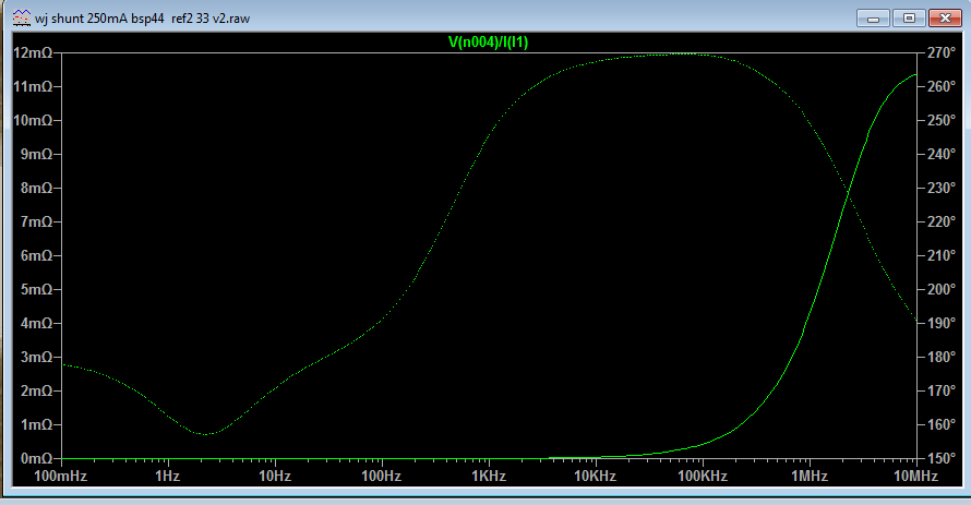

@Zoran, Why return to TL431 as a reference? Aren't there better ones today? The Walt Jung references that I use in my regulators are incomparably better than the TL431. Also, all CCS can be performed with depletion mosfets with much better results and at the same time it will simplify the circuit.
btw ,here is an example, shunt reg with depletion mosfets ,ADA4897 and GLED431 reference

@ Zoran , why would an almost zero millihoms output impedance will be better ( sound wise ) than an 10 to 20 milliohms one ( like the series regs ) , and does it still true with lipo battery supply having milliohms impedance ?
Hi it is not about "better", actually other party imputing a "better" implicate that it from first party referencing - is "better"?
It is discrete design with an elements in the ara of the DAC chip produced. It seems somehow logical to use these parts to find out what could it be that they used with TDA or other dac from the same era... 🙂
And I said it is not against ot opposing the battery or supercap aproaches - only a complement.
Hi
GLED is OK but it is "fixed" for 2.5V as zener part. And it needs special part LED to achieve that good performance. And low noise zetex BJT. (But off course that we can stack 2 x for 5V sequence i prsume? Even tried in spice...). I made it with 431 in "special" way because it is simple and available. And most of that it is adjustable to various potentials and different power suplies. Can be pretty much universal?
I tried it in praxis, this 3 part, (passive LC - simple PreRegulator - shunt). And it sounds very good.(I already tried in some preamps and DACs sa well.)
And 431 is only IC (with small number of BJTs inside) so it "can go" as discrete 😡.
