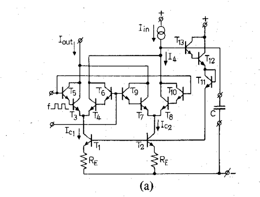

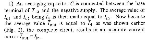

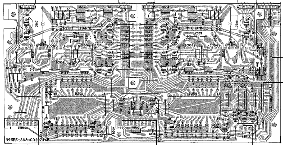

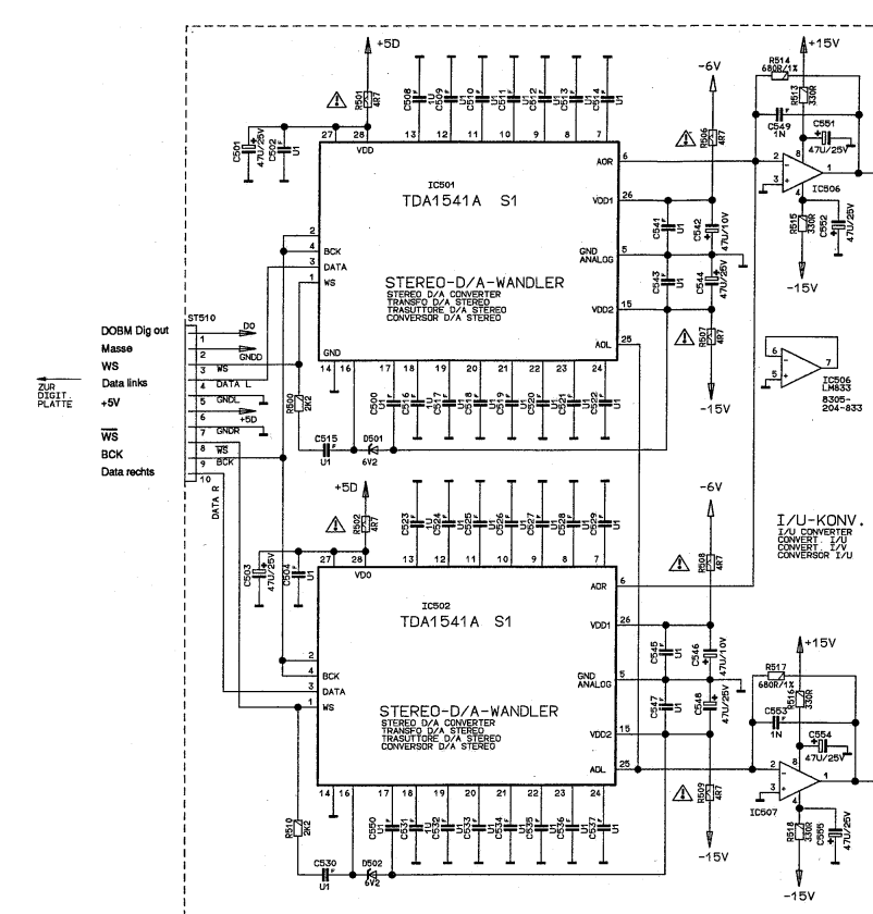

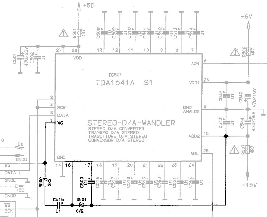

Groundig just implemented circuit from Philips book (or Patent judging by the font markings below the figures?)That R302 3k9 between WS and +5V... first time I see that if I am correct in the Grunding DEM mode. The Grunding mode is cleary biased with -15V as usual here also ?! Is there something to close is order it works better ?
Yes there is a difference with that R conn. to +5V.

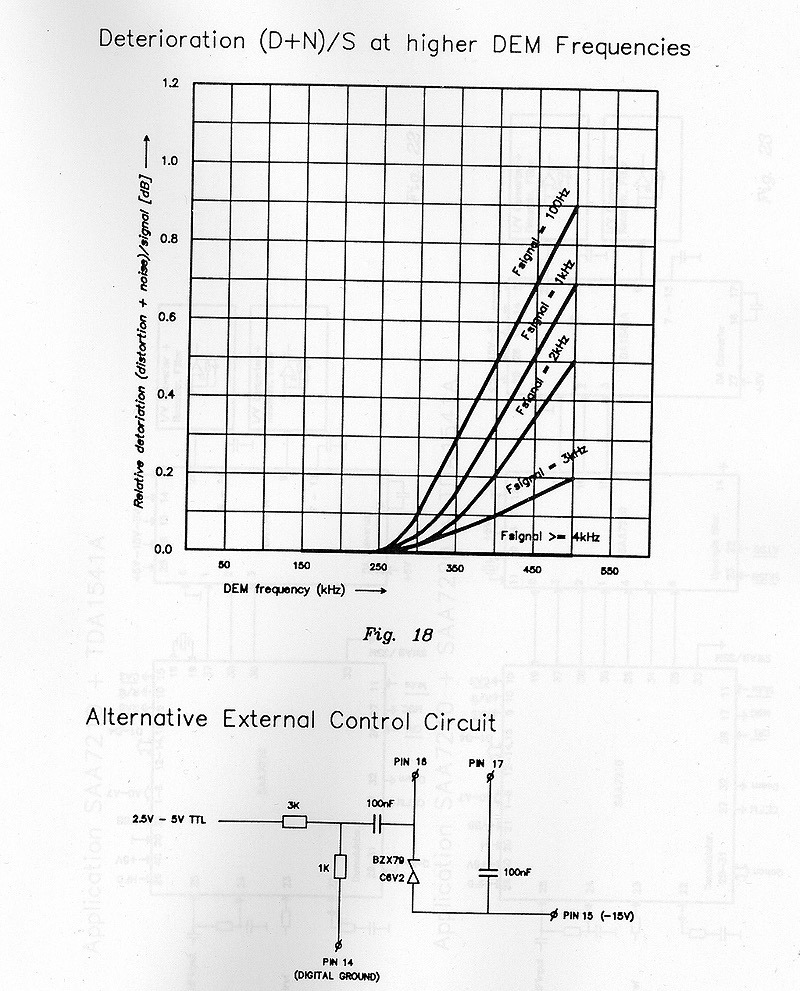

BTW
does anybody have whole Philips paper or book or else from where these 2 pages are extracted?
Or some information about the publication?
I searched in few Philips books on digital but couldn't find the se pages...

Edit thanks for fig 18 ! 🙂
Have you the long Philips book about the TDA1541A, I would be glad to have it for my education, will be appreciated. Was seen in PDF....
No Idea. This device is a fairly "late" Grundig TDA1541 design (1991-1993), so I think there are some "lessons learned". Download the service manual for the unit.

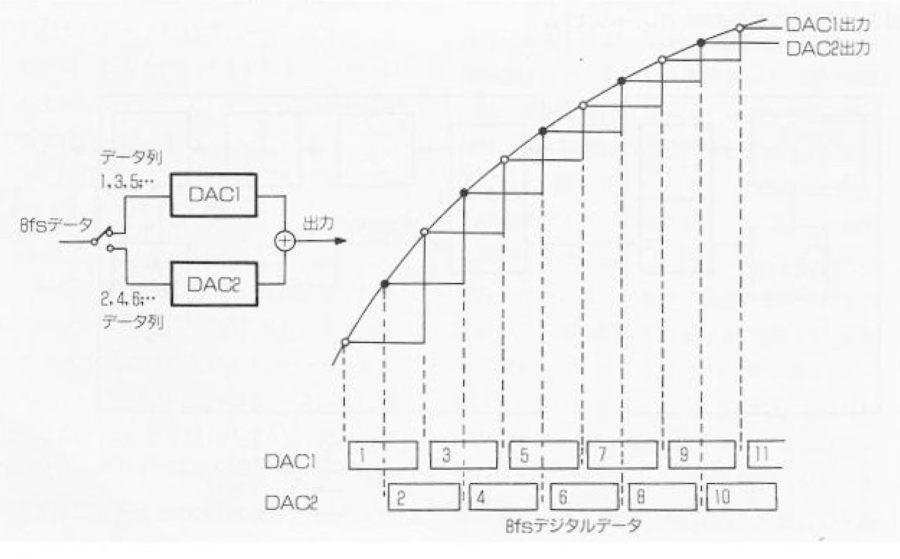

It's more complex than that. It's Grunding CD-9009 Fine Arts. It uses two interleaved TDA1541 to operate at 8 X Oversampling:
DEM sync is obviously 176.4kHz so within Philips recommendations.

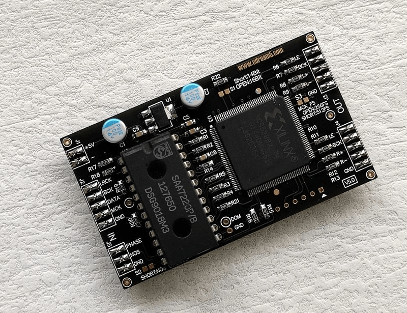

Many nice guys here made some efforts towards this about FGPA and those chips,
FPGA/CPLD is just a way to shrink this:
Onto a Chip.
To some people "FPGA" is some kind of magic that magically makes everything better.
There is no place for magical thinking in tech and war.
It is debatable if this "programmable gate array" logic is a better choice than either real hardware (which may be optimised over the above pictured) or some form of MCU, be it a "hardware equivalent" type like Transputer/XMOS or a multithreaded RISC CPU (e.g. ARM Cortex). In all cases except hardware programming is needed and the matching validation.

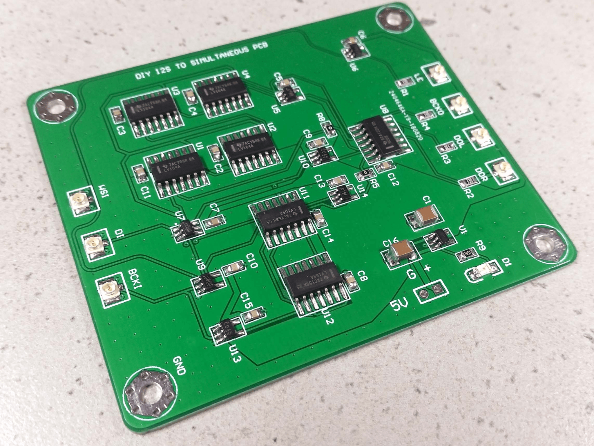

Needs someone to make a new generation TDA1541 PCB, optimum layout around TDA1541, I2S-2-SIM hardware conversion, signal conditioning.
Make it with the best suited parts and do a design that can be ordered from JLPCB as completely populated board, minus critical/through hole parts.
If there was a group effort, where everyone contributes a bit of time, it would be easy to do.
Like stone soup.
If one person does all, it is a lot of effort. Then it usually becomes commercial. Or dies before a MVP.
The base schematic has long existed:
DIY I2S to simultaneous converter PCB V2 by ryanj
Switching from 8 Bit 74XX164 shift registers to 74XX16374 16 Bit parts with much better Vcc/Vss pinout in TVSSOP will improve the results. Not many IC's left after this, giving 3 IC's instead of 6 with cleaner power.

CPLD is "real hardware". If you replicate logic ICs into that, it can work without oscillator exactly like the original circuit - actually even faster with lower "intrinsic" jitter 🙂It is debatable if this "programmable gate array" logic is a better choice than either real hardware (which may be optimised over the above pictured) ...
Here will be example for DIY community how to do CPLD "schematic based" - without writing code. It is clocking on external clocks (BCK, LRCK) and oscillators are for reclock - removing jitter from original BCK and LRCK.

I have already started making tda pcb a while ago, but this changes things a bit with all the new info...I don't mind starting a fresh, but i have only so-so free time on hands to dedicate.
I didn't really consider i2s to sim, since it's provided as is from jlsounds i2soverusb board, which mvaudio fixed with lyuben. And i have no need for spdif. But, if it's going to be a group effort, i don't mind optimizing it for more use cases. Use tssop shift registers, and with it a stack for chinese amanero clone to save some costs. Rough schem drawings of collected info would be nice, save some time. Also use case considerations, as pcb can be made as a stack for output stages, saves space for example. Perhaps marks reclocking project. I have also considered using more than one tda chip, since i obtained quite a few over time, but as stated, these are getting significantly harder/expensive to obtain, so single it is.

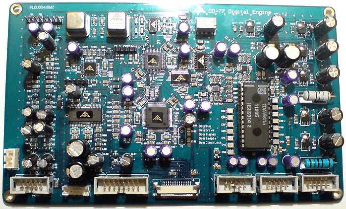

This PCB includes a complete CD Player control (left side and bottom, power supply, servo driver IC and CD Processor.
There is quite a collection of hardware, a low jitter clock PLL (top center) , TCXO Clocks (top left), an ASRC operated as SSRC for "Oversampling" (TSSOP IC near the CPLD), power supplies and not the least a CPLD.
I have worked in a fair few designs with CPLD and FPGA and they are neither low jitter nor inherently superior to discrete logic. That's just magical thinking or zweckoptimismus (this german word has no english equivalent).
As said, they are easier for mass Production where complex circuits are needed.
In the above design the CPLD added so much jitter over and above a PLL Clock Generator (which is hardly femto seconds to start with) that a 74ACT174 re-clocker was needed after it.
If a CPLD or FPGA replacing a discrete logic circuit lowers jitter, I have my doubts about the design and implementation competence of the original.

WM8805 gives very low jitter from SPDIF, implemented correctly. Shame cirrus nixed it.
I guess an Si5317 in narrowest bandwidth mode could be added as jitter cleaner So any I2S source can be used.
Too big.
TVSOP and use 16 Bit parts. Like this:
Texas Instruments SN74AUC16374DGVR
I know, AUC logic is aggressively low voltage, but it has advantages that make it worth it.
TDA1541 wants to see 250mV P-P swing around ~1.3V offset anyway, so whatever logic runs on at least 2.6V will be fine.
Make it all in AUC logic running at 2.6V.
Good call.
We can do two things:
Make a pure digital PCB including CS8416 SPD In; SI5317 jitter filter (or whatever out there is better) and footprint for any Amanero format input circuit from Aliexpress to ultimately SMA (I hate FL connectors) connectors so we get coax to TDA1541. Board offers balanced simultanious out from any I2S source up to 384kHz and for two TDA1541. Leave TDA1541 itself completeltly open, or make separate TDA1541 only PCBs.
Make an "all in one" with a second breakoff/plugin TDA1541 PCB and the ability to offer SE and BAL options.
I still like stuffing options for either 50/60Hz DEM clock or 4 X Fs or fixed clock as MCK (512X) / 16, as both options can be optimised.
Especially now we know that AGND and DGND can stay pretty much completely separate, running the DEM in "Fast/Sync" mode should reduce the problems we see in suystems with mixed (up) ground.
Thor
Which is why i said it was currently only me project, and that i don't mind redoing it for broader audiOence and more use cases 🙂Which cannot be connected via SPDIF which remains the lowest common denominator. I have multiple sources with SPDIF that would want connecting, from BT Receivers to TV's.
Makes sense.Make it all in AUC logic running at 2.6V
Wm8804/5 is still i belive up for factory order till end of the year, since it's not going to be commercial project, i belive it should be it, as it's still available in sufficient quantities. I have already stated it's superiority in miros thread. I don't mind buying a stash for future endeavor diy-ers, but tda is getting harder and harder to obtain, there probably won't be many more tda dac builders few years down the road.Make a pure digital PCB including CS8416 SPD In
Ohh i love making modular designs, so stackable tda would be quite nice. But additional logic/complexity for true differential?We can do two things
For -5/6V, decoupling to AGND but DC loop to DGND!
WTFudge! And is it -5 or -6V. What's up wit' dat!
Well, I found something:
Inside Classic Audio Arcam Delta Black Box 2
For reasons unknown to me, a handful of high performance devices supplied -6V to the -5V power input (VDD1). The DAC IC will tolerate this in the short term, but over time every TDA1541A supplied with -6V to VDD1 will fail.
So, -5V. Good. One more mystery resolved by the service tech. Likely deliberately build in lifespan limitation.
