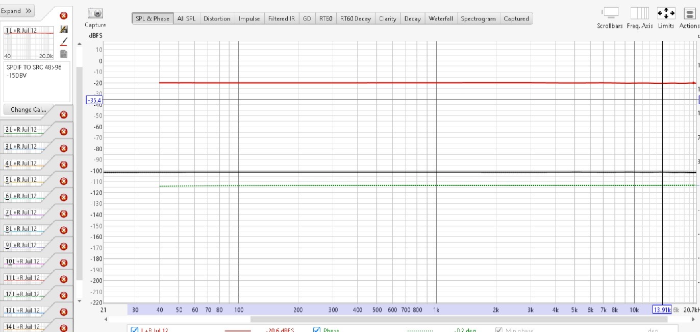

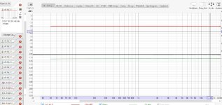

Here's my dual 1541 DAC. Input is spdif direct from a Behringer UAC222 into a SRC24/96 set to upsample to 96Khz, and output from the Sowter transformer into the 22k input Z of the UAC.
Show me where the frequency reponse is influenced by the inductance, and relatively low load impedance.
Green line is phase.
Rather than all the theory and opinions, I like to present actual results.....

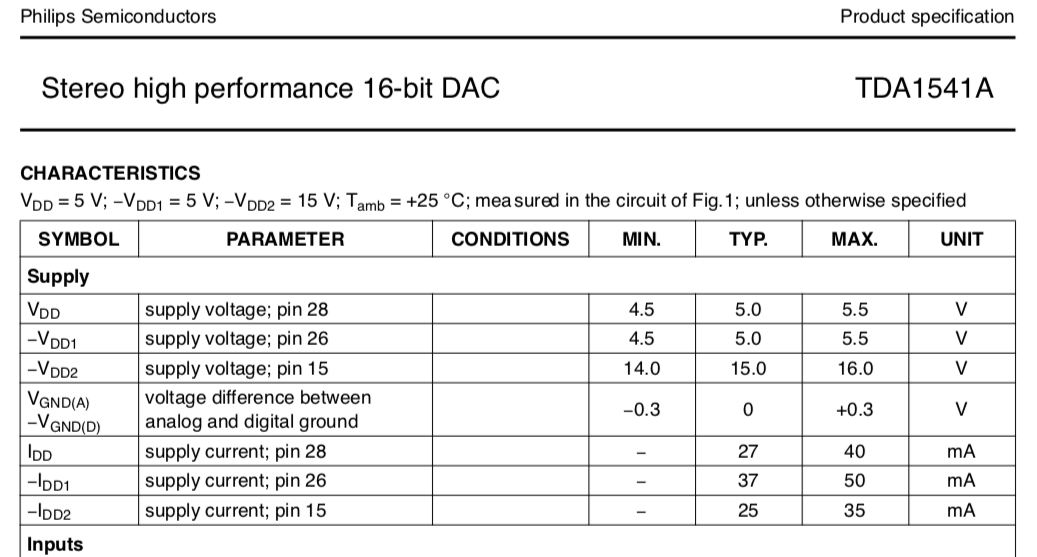

it is min -0.3V and max +0.3V
Where did you find that? Curious.
Thor
Reactions: Alexandre
In the datasheet?
But Vgnd(d) signed with "-" is that telling us that only negative PS are digital part
And Vgnd(d) is refering to +5V?
So that is obviously if the power suplies are separate. BUT which one or ALL of them.
+5V is digital for sure?
-5V ?
-15V ?
So if we can be for sure what the suplies are D and A, we can left open connection with AGND and DGND and measure eventual difference?

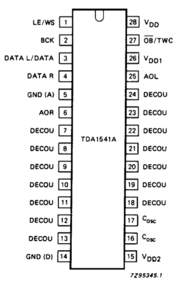

I dont know if it is from the importance but GND(D) is close to Vdd2 -15V (to decouple)
That can implicate that -15V is digital PS?
Also GND(A) is closer to AOR and AOL, somehow logical. But next close to Vdd1 -15V and Vdd +5V
The pins are far away from each other, diagonal, are Vdd and GND(D) which has to be closest to decouple?

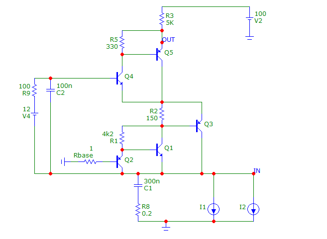

It is deliberately drawn a little misleading. It is the same as a simple Darlington, but with a J-Fet. As the J-Fet has a limited drain source voltage, it is powered by a zener diode. How this diode gets it's current without allowing "current escape" or adding extra current AND being able to have the circuit start is the magic trick, I wish to keep hidden. Sorry.
I could use one A23 alkaline battery to achieve low current escape, circuit below. Single digit nanoamp base current modulation on Q2. The circuit is biased by I1 which is 10mA, the signal is I2 which is 2mA P-P. The squarewave looks good with 300nF+200mohm.
HOWEVER, the simulated distortion is high, second harmonic is 60dB down from the fundamental (10 KHz). This shouldn't be, it doesn't make sense. What's happening here?
In the datasheet?
Too many floating around, it's not in the ones I have.
No, it is not.
It is:
Vagnd - Vdgnd = -0.3V ... + 0.3V.
No. It's just a line break.
No, it is referring to DGND.
I will agree, based on that.
Based on internal Circuit details published, AGND/-15V are one pair, DGND/+5V are another pair and -15V is kinda at loose ends but really loops to +5V.
No, it is MOSTLY digital but also carries the complement of Iout.
My best guess, DC and digital CCS common.
= True Analog Reference Pin
We can, but the risk is a dead chip.
We know no power pin draws > 50mA, so if we connect a resistor of 0.3V/50mA = 6 Ohm between the grounds (say 3R3 to be safe) we can measure current.
No, Vdd (+5V) and Vss (DGND) are placed in line with standard practice for (TTL/ECL) the logic IC of the era (still observable in modern 74HCXX CMOS logic).
No.
Not really.

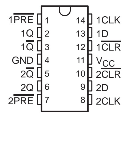

All TTL pinout derived IC's are like that.
Compare 74HC74 to 74ACT11074.
