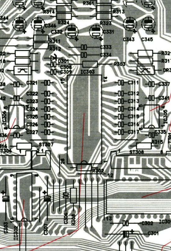

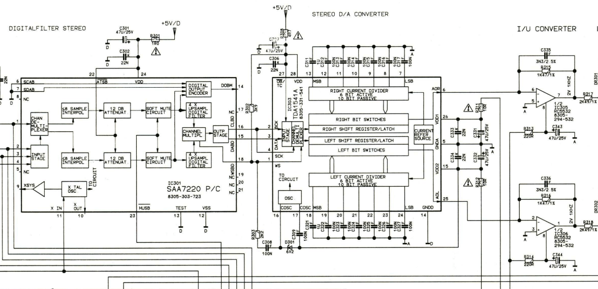

I came across a satellite radio tuner from Philips (Grundig Fine Art level design - Philips 70ft990 DSR Tuner) that showeshow they handled power supplies.
+5V is digital for sure?
For sure, Pin14 runs back towards the digital part and decoupling to pin 28 with no obvious link to pin 5 anywhere near the TDA1541:
GND A & GND D only link on the power board and are completely separate otherwise.
Notabene, -5V is treated as ANALOG supply (and actually -6V), but the actual power comes from the same winding as +5V D!
Calling the effort on the -6V supply vestigial is charitable. And it is not tapped off from -15V.
On the other hand, -15V uses an LM2990-15 which in those days counted as "premium" regulator.
-5V ?
Seems both but mainly a DC pin setting reference. Given it is linked to AGND here it suggests it doesn't make much noise.
The very basic power supply (and the high PSRR) suggests this unit is not very consequential for the audio or digital side.
-15V ?
Analogue and separate.
And it is absolutely clear that DGND and AGND are completely separate and linked only for DC.
So we can with a high degree of confidence conclude:
DGND & +5V D form a power pin pair. For this pair DGND is the "reference" for signals and power. Most annoyingly, +5VD is also the pin that carries the complementary current of the Output which is it's only analogue function.
AGND & -15V A form a power pin pair. For this pair -15V A is the "reference" for signals and power and AGND is actually the positive Power supply, as the entire circuit between AND & -15V is almost exclusively composed of NPN transistors.
The -5/-6V seems not particularly either digital or analogue. It draws the highest current of any pin though. More information is probably needed. But for now I call +/-5V still part of the same loop, with +5V being the collection rail for analogue currents as it needs to link to -15V for analogue decoupling.
So:
DGND & +5V D - treat as digital, with extra LF decoupling to -15V.
-5V/-6V decouple to +5V only
AGND & -15V A - treat as analogue/rf supply, -15V A is the actual collection / reference rail for analogue currents.

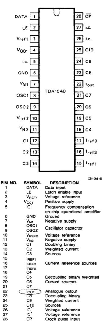

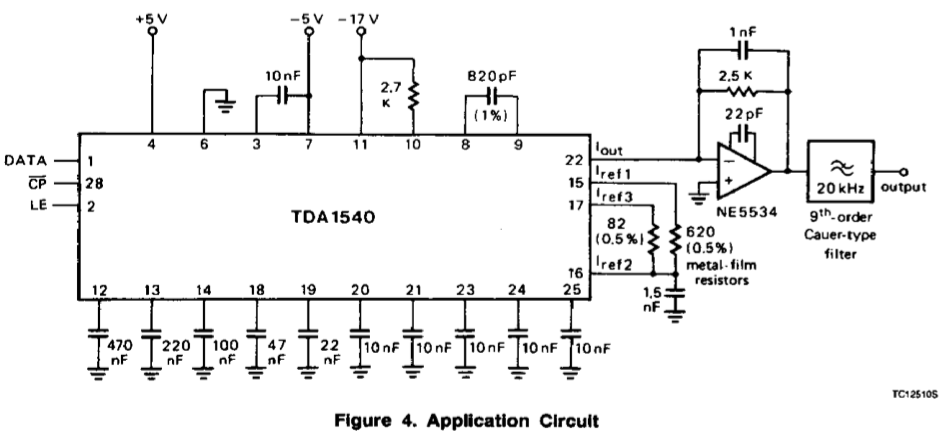

Here are pins marking and order for the predecessor 14Bit TDA1540
Ih has just one GND point on 6 pin.
And 3 DEM bit more MSB (10) than TDA1541A (7 dem bits per channel), probably because od dense pac in tha same DIP28 package?
Interesting I didnt know by now (somehow i miss the info) that TDA1540 has OP inside for frequency compensation at pin 5 which has to be remain unconnected.
