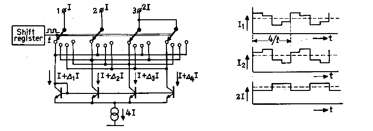

There is a common misbelief that DEM frequency should be >= 4x WS.
It needs to be 4 X WS IF using high frequency DEM clocks and low(ish) value DEM Filter capacitors.
This is because of the way the DEM current splitting works. Also, given the timing needs for the DEM circuit is pretty tight, the original oscillator is a bit too jittery.
In principle, running 4 X WS should allow to not use any DEM Filter capacitors, but the results of doing so seem interesting.

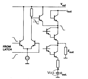

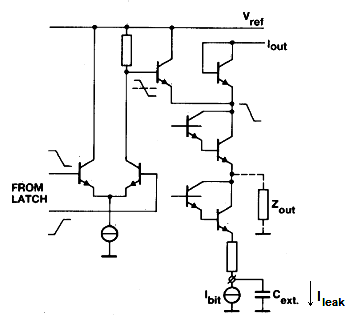

I think the DEM decoupling capacitors are there to filter whatever frequency the DEM oscillator runs on.
No, that is a "side benefit".
They are there to store the averaged voltage that causes the precise bit current to flow.
The switching current splitter sends a current into this structure (MSB's):
This current has actually 4 individual currents as components which may vary by as much as +/-5%.
The current causes voltage to be dropped across the "filter" resistor.
The resistance of this resistor and the capacitor form a moving average filter.
But the circuit composed of the cascoded Darlington transistor, resistor and Cext form a CCS in their own right:
If we replace Cext with a DC source we have a static CCS. This one is dynamic and the current passing is the moving the current "Ibit". Now Ibit is created using a switched "Dynamic Element Matching" system that uses averaging to eliminate errors.
Essentially the actual operation of the DEM circuit is that short time highly stable Transistor/Resistor/Capacitor current source that tracks the moving average of the current supplied by the switched current splitter:
If you prefer low DEM oscillator frequency (50 Hz) simply use higher value capacitors.
It is not that simple. Use higher value capacitors with VERY low leakage. Low leakage is not as easy as it seems. Check this for details:

Note, you can use any DEM frequency you like (< 6MHz appx, the limit of the transistors and circuitry in the TDA1541).
You can omit DEM filter capacitors. You can run the DEM oscillator stopped
You can make 14 precise Voltage sources with suitable thermal tracking to the TDA1541 die temperature and feed the DEM Pin's with low impedance voltages (must handle a few mA DC offset) with the DEM oscillator stopped.
It will work. How well, depends.
Running Fdem at 44.1KHz will create idle tones at 22.05Kz and 11.025KHz at levels that depend mainly on the filter capacitor value on the MSB filter.
You can do whatever you like. You can even get an ESS DAC Chip and use an AD797 as I/U converter and feed the IC with a jittery 125MHz clock and feed it with a high jitter source asynchronous to this and listen to the result. Nobdy is telling you what to do.
I stated that Fdem has a few technical strictures, IF we want to avoid idle tones within the Audio Range and get optimum linearity.
These are:
Fdem / 2 <= 20Hz
Fdem / 4 >= 20kHz
realistically we can probably relax this requirement to:
Fdem / 2 <= 40Hz
Fdem / 4 >= 15kHz
Not that it does much really.
Other frequencies will create idle tones that depend the match of each current source in the specific set feeding the specific pin and the capacitance of the capacitor and the fixed general DEM frequency switching glitches.

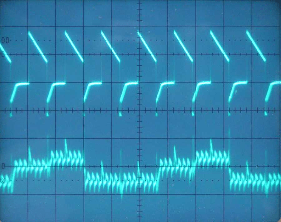

From John Brown, DEM Pin without capacitor and DEM oscillator
DEM system, observe the stepped waveforms similar to the oscilloscope trace
Now given that we have 4 different currents for each complete DEM cycle stating that Fdem should be an integer multiple of WCK and at least 4 X WCK so that all 4 states are used for a single sample.
This way any error folds back to DC. And as long as our capacitors have negligible leakage current (e.g. C0G ceramic or Film types) the DC error asymptotically approaches zero over time (though to get absolutely zero requires infinite time).
Mind you, I showed the Graphics earlier in the thread, where I made said assertions, to illustrate exactly why I made them. I already repeated them more than once. I would appreciate if you could not ask me to explain the same thing over and over again.
Above are my arguments why Fdem must be either < 40Hz (< 80Hz for the relaxed requirements) or 80kHz (60kHz relaced requirements) unless we want tolerate distinct idle tones within the audible range and why unless we use very large value DEM filter capacitors we want a DEM frequency of WCK * 4 which also is the integer multiple of WCK if greater than WCK * 4.

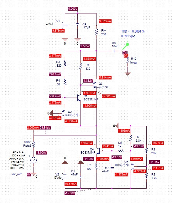

@ThorstenL thanks for the BJT IV.
+ Notes about power supply decoupling and grounds - very useful to me.
Very very good perorming. I just made quick probe and a bit rearrange circuit, just positions of few BJTs. Current is a bit higher. Zero offset on Iout pin can be adjusted (with R4 trim pot), Very low distortion,-160db floor, and 1Vp-p is more than enough. There is no Fr dips and it can go "infinite" high. Circuit well behave even with lower Riv (which is the issue with most BJT IV stages). So the tube gain stage can be added... Off-course probably has to be checked by someone with more knoledge on BJTs.

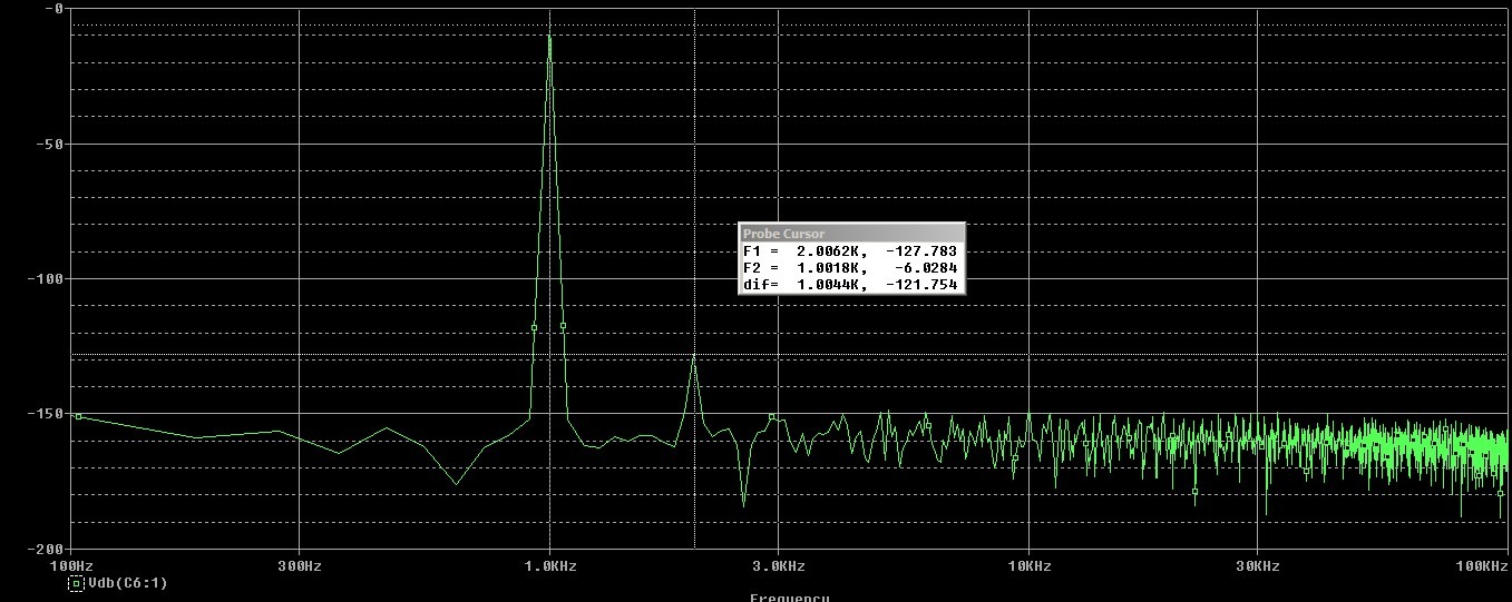

TDA1541 I/V Resistor Selection
Use a current conveyor with < 1 Ohm input impedance, I/U conversion resistor to +5V. Make it part of the TDA1541 circuit, so you get a sensible voltage output.
With 250R/353mV (as shown) a 1:5 transformer gives 1.76V from 6.25k source impedance, marginal but usable. Multiple suitable items exist, of course a DC blocker will be needed.
Try MPSA18 for the NPN.
PNP, look for the fastest you can get at the current that is running.
Thor

"superiority of DEM sync to WS (grundig)"
There is a common misbelief that DEM frequency should be >= 4x WS. I think the DEM decoupling capacitors are there to filter whatever frequency the DEM oscillator runs on. If you prefer low DEM oscillator frequency (50 Hz) simply use higher value capacitors. In NOS mode where the DEM is synced to the 44.1 kHz WS frquency as per the "Grundig" solution, just use a suitable film capacitor. Note the impedance of the DEM decoupling pins are in the order of 10 to 100 Mohms. It is just a simple filter function with the internal R and external C. I would like to see measurements or experiences of others about this sync/no sync/DEM frequency question. For now I use the so-called "Grundig" style DEM oscillator in NOS mode (44.1 kHz frequency synced to WS) and the capacitors are 220 nF film type. It works well.
Whoever stated first that DEM oscillator frequency should be >= WS frquency is due to give a technical explanation.
But if you use Grunding mode NOS, i.e. WS=DEM sync = 44.1 K hz ; then it is divided after in the chip per 4 and the noise is rigth in the audio passband.
So with the 0.220 uF film DEMx14 filtering, you measured no more noise ?Or at least different disto spectra ?
It interresting to notice you like it best with the ears after a listening test... It is a great information, I wonder why this post is not more talked !
