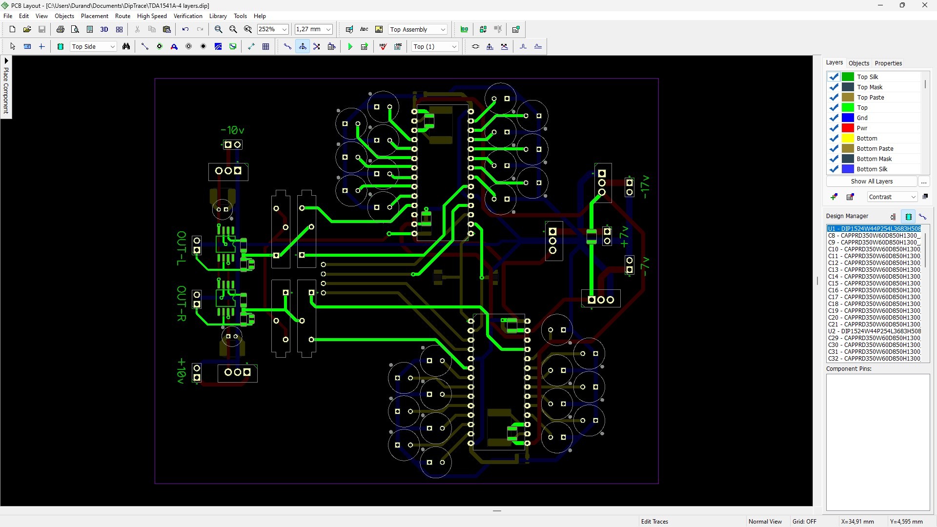

First shot of the TDA's board with 4 layers , including AD811 JRZ output :
easier than 2 layers but not that easy too
measurements of the previous board shows that staking 1 uf ceramic + 0.1 uf film at the supply's pin is ok
trimmers for the biais will remain , but the 20 ohms became 10 ohms and it will be an https://www.mouser.fr/ProductDetail/71-1280G-10-K
@fabrice63 , with the AD811 you must use decoupling, COG and an electrolyte of at least 10uF, otherwise you could run into problems. COG must be immediately next to pins 4 and 7.
I don't understand the use of those trimmers? It turns out that no active I/V conversion is needed and that the AD811 is redundant.
It may not be easy to see , but pin 4 and 7 of the AD811 ( smd type ) got their caps , 10 uf Panasonic FR + 0.1 uf ECHUX film , chips are 10 mm away from each other
trimmers are there for the biais and the equillibrium of it between the two chip , this is the "dual mono 17 bits signed magnitude version " , quite
different than a single chip setup , and as far as I dont know if it would works without biais , I'll keep it , I will easely bypass them if needed

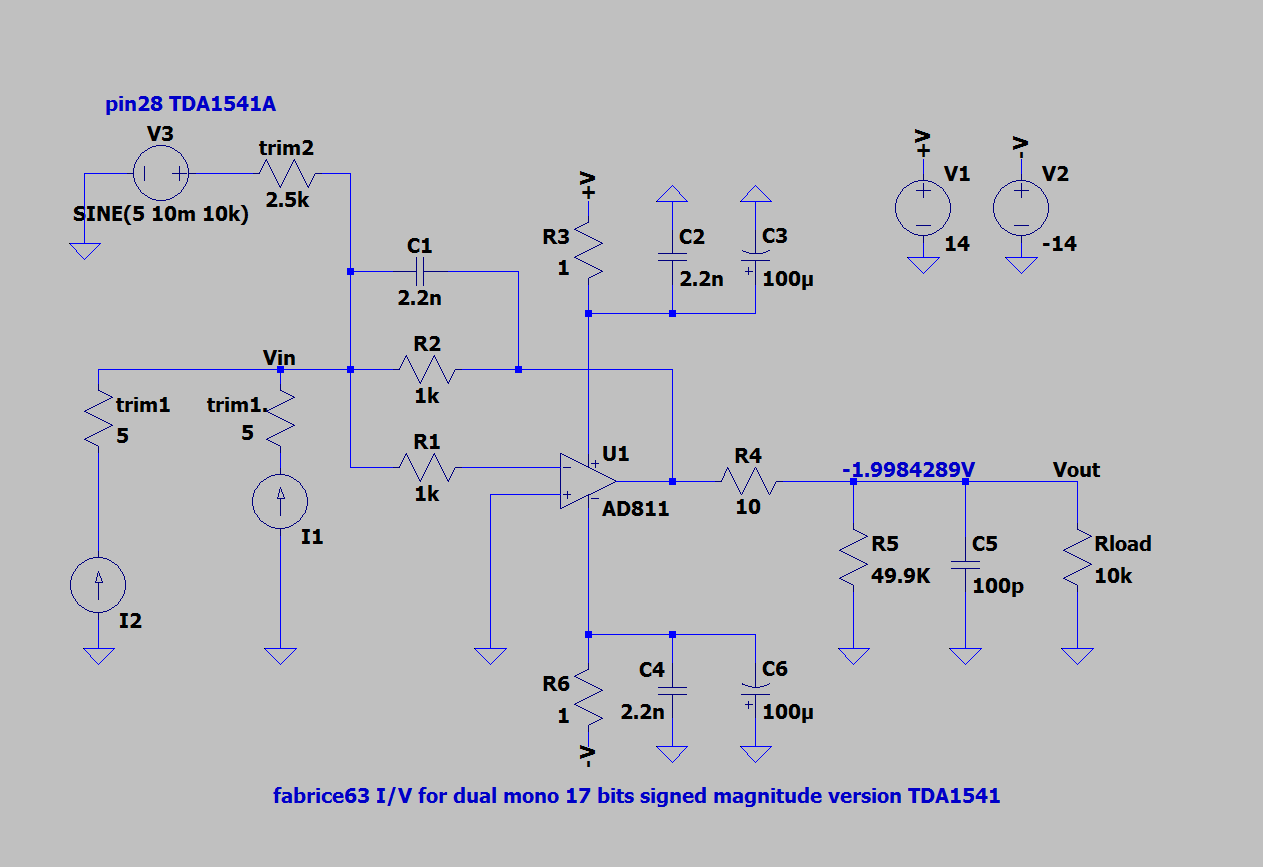

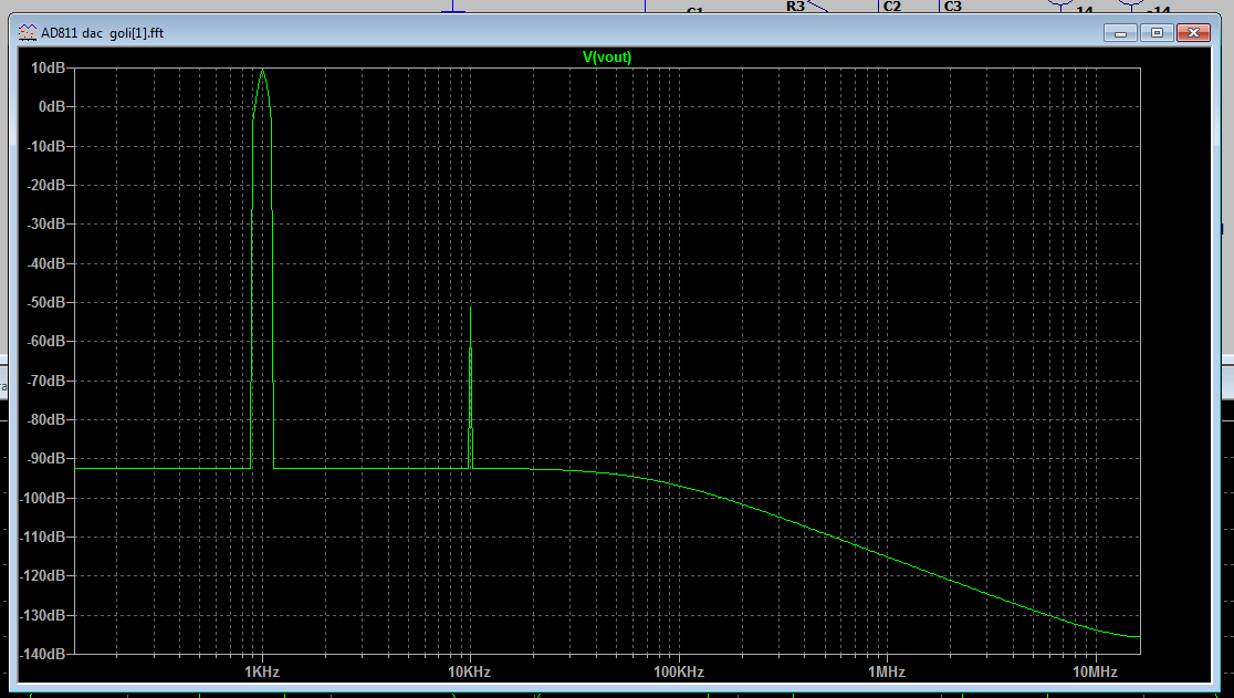

I hope I guessed the circuit as you imagined,so you get a DC voltage at the output, any noise at +5V(pin28) will be amplified in the active I/V, so you get an FFT as below in the picture. This is with 10mV/10kHz but in reality there will be HF noise that passes through the AD811 without any problems.

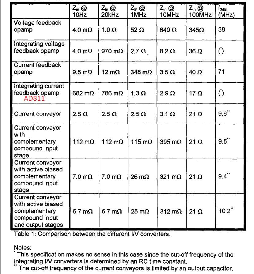

-Input Resistance of AD811 is 14ohm, so the first trimmer will surely have some influence because the active I/V is not designed with a resistor in series to input of the op amp. Until now, I have never encountered such a thing with active I/V, where the goal is for the DAC to see a resistance of 0 ohms, at least on paper. In reality Zin for AD811 is in the table.

As far as I've read, they managed to make it work with passive conversion. Trimmers are needed to zero the differences between the current outputs and the conversion is done with a resistor.
I did not include - current in my simulation so that it could avoid offset at the output, but any noise that comes from pin28 will be amplified in the active conversion and that 5V would have to come from a separate regulator.
To begin with, I would make a passive I/V as Koldby did, then maybe later try an active I/V, but I would zero the differences with a resistor in the feedback and avoid the trimmer at the input of the op amp itself. In any case you will need a precision trimmer in series with the resistor in feedback.

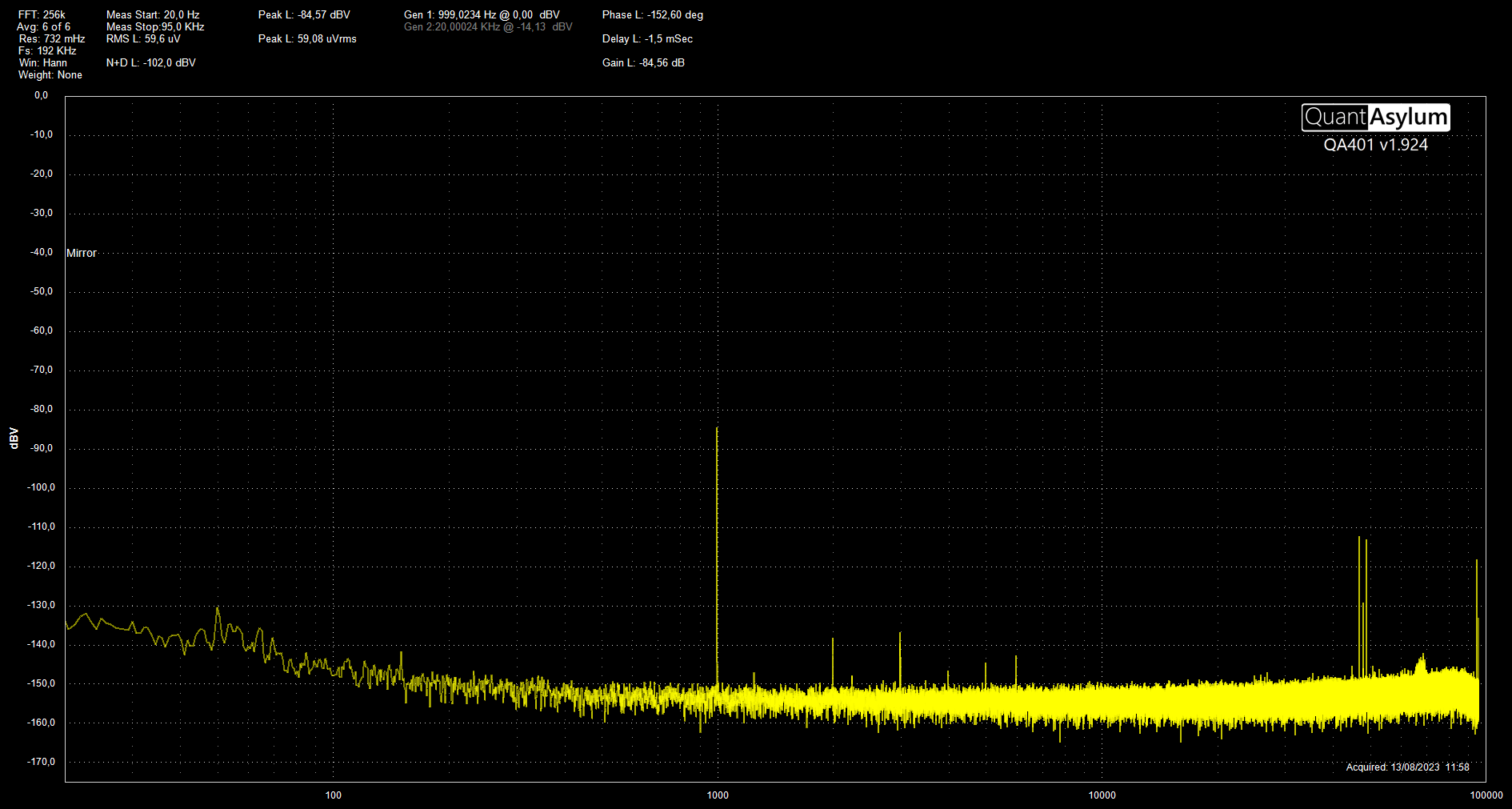

I made some measurement today , here is the FFT up to 100 Khz of the noise at pin 28 +5 v while DAC is running an 1 Khz sine at 0dbv , and as Grunf says there are some stuff that will go to the AD811 , not much but still too much :
