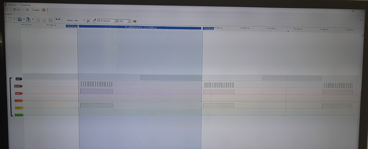

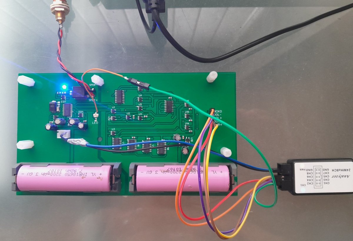

Second step , logic section is populated :
And here comes the logic frame , from the cd payer , playing :
it's time to see now if all the frame are in the ballpark , before starting to populated the DAC board

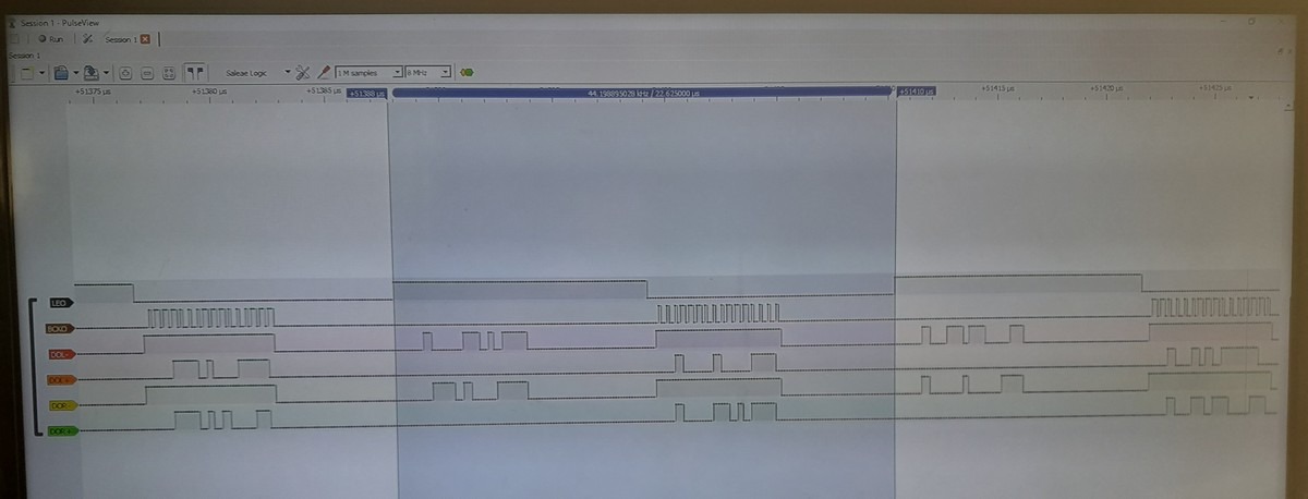

here are the frame , from the cd payer , NON playing , DOL + and DOR + are low , dont know if it's ok or not , any input will be appreciated 😉
Why not start your own thread ?
Because this thread is all about the TDA1541A , and its is what I am doing , following the path of John from EC-DESIGNS 😎
And wht about the spdif is ON, CD running?here are the frame , from the cd payer , NON playing , DOL + and DOR + are low , dont know if it's ok or not , any input will be appreciated 😉
try to connect the CKSEL pin of DIR9001 to the ERROR pin.
The PLL did not operate when there was no SPDIF signal,
so both the DATA signal and the LRCK/BCK pulse did not come out,
from this link, maybe it would be from help...

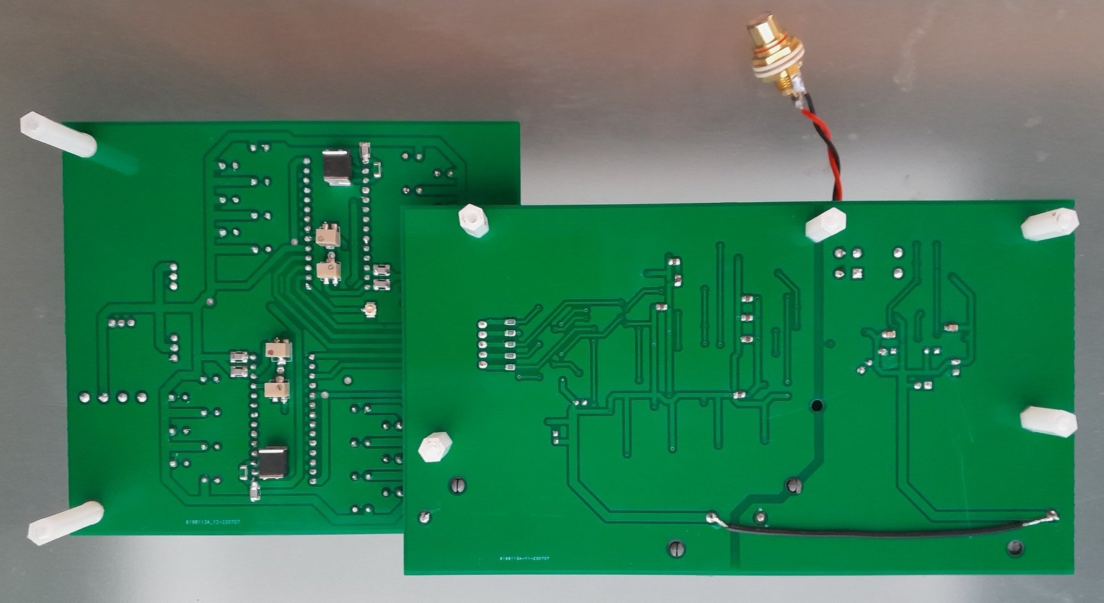

Continuation and almost end of the pcb buiding , waiting for the power supply parts to come
what you see ( the trimpots ) in the bottom DAC pcb are the Koldby trick found while testing he's setup , it seem to work well ( post 7279 )

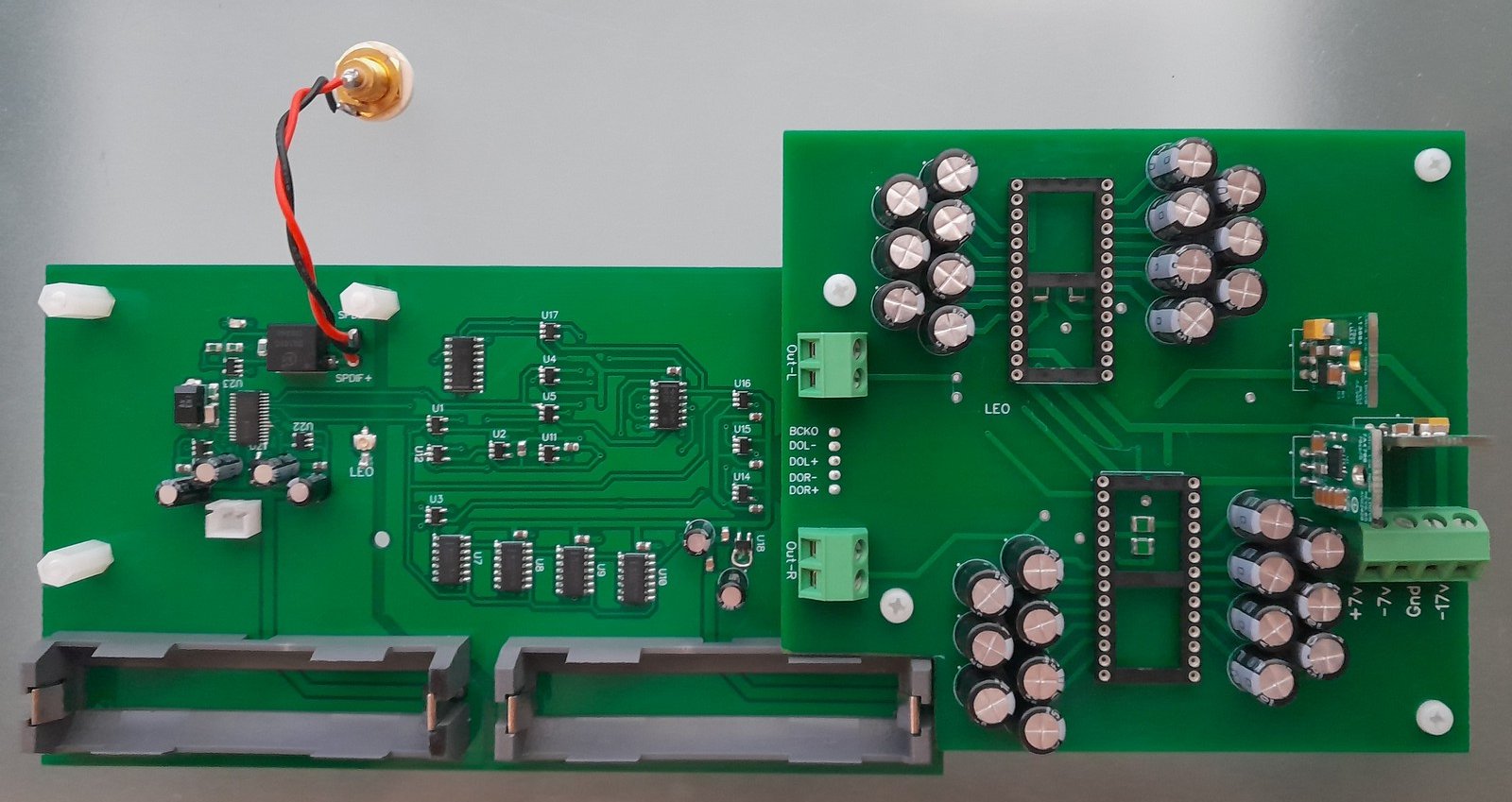

If the numeric logic is good, there are perhaps some path of improvment seen from my screen, surely details however that can be heard when the proto is finally working :
I am not a fan of the 100 uF DEM decoupling John introduced and I know several people thinking the same after a try. And the caps in your layout are way to far from the TDAs.
Try to look for Pedja Rogic DIR9001 shems on the the net, you may find some usefull shematics.
Year and origin of the production plant of the TDAs matter as well as the quality of the clock (same inputs as above about the layout and parts choice).
Just icing on the cake inputs, of course. A complicate trae off at the end but that matters ! 🙂
- spidf : I would choose not spidf from a RCA but a true pro connector from the good impedance and directly sold on the board for the futur proto as the source of course.
- from my experience, whatever the quality of those connector there is still some difference and I found the hot wire made from a solid standalone core - the same as TVs' antennas- to work well VS some more exotics
- the quality of the passive parts matters : the spidf traffo : try a direct connection to split it to understand its behavior.
- Caps on all signals, digital as analog... well all is analog for electricity and it can be heard according the quality of your loudspeakers. Can have a role on the final tones, according the way you play with them : inductance - pcb layout- or dielectric of the smd as the lythics.
- resistors on the digital path if they can reduce some bouncing problems can introduce also less transparency according the whole layout, and straigth digital path vs zero ohms vs 25R -for illustratioon- Sussumu resistor should be chose with ears... (I mean at the ebd as a icing of tthe cake).

@fabrice63 ,congratulations on the project, it looks good, although there are small birth problems that will be corrected in the future.It would be better if the tda1541 had slightly better and larger capacitors (OS-CON)for decoupling, as well as the shunt regulator being better suited to the tad1541 than the serial one. Decoupling and regulators are very important for DACs because they produce HF interference that really affects the sound.
Sorry but that might be not so good. Because the external connector should be the part of chases. Not a part of PCB. When the connector is a part of PCB could introduce all vibrations via cable mass. In case that on the other side is the same thing, then the 2 PCBs will be connected...spidf : I would choose not spidf from a RCA but a true pro connector from the good impedance and directly sold on the board for the futur proto as the source of course.
In his case connecter is part of chases only, PCB could be mounted on some anti-vibrational surface and then to the chases...
Bare in mind that on the pcb crystal oscillator is a part of DIR9001 circuit.
And if You take a look at the older devices they in majority way had the isolated connectors to the chases connected with soft vires to the dedicated PCBs

there wont be any spdif connector at the end , an board usb to spdif cm6631A will be on the top of the DIR9001 connected with 2 very short wire
I will make FFT measurements of the all thing once completed , if needed I will decoupled and /or modified as per measurements
ceramic caps are all COG , and résistor are all 0.1 % 25 ppm , DEM cap are nichicon UKL , all other are panasonic FR , timming cap of the TDA are film cap PPS
forgot to mention that the DAC board will be lipo battery powered too
