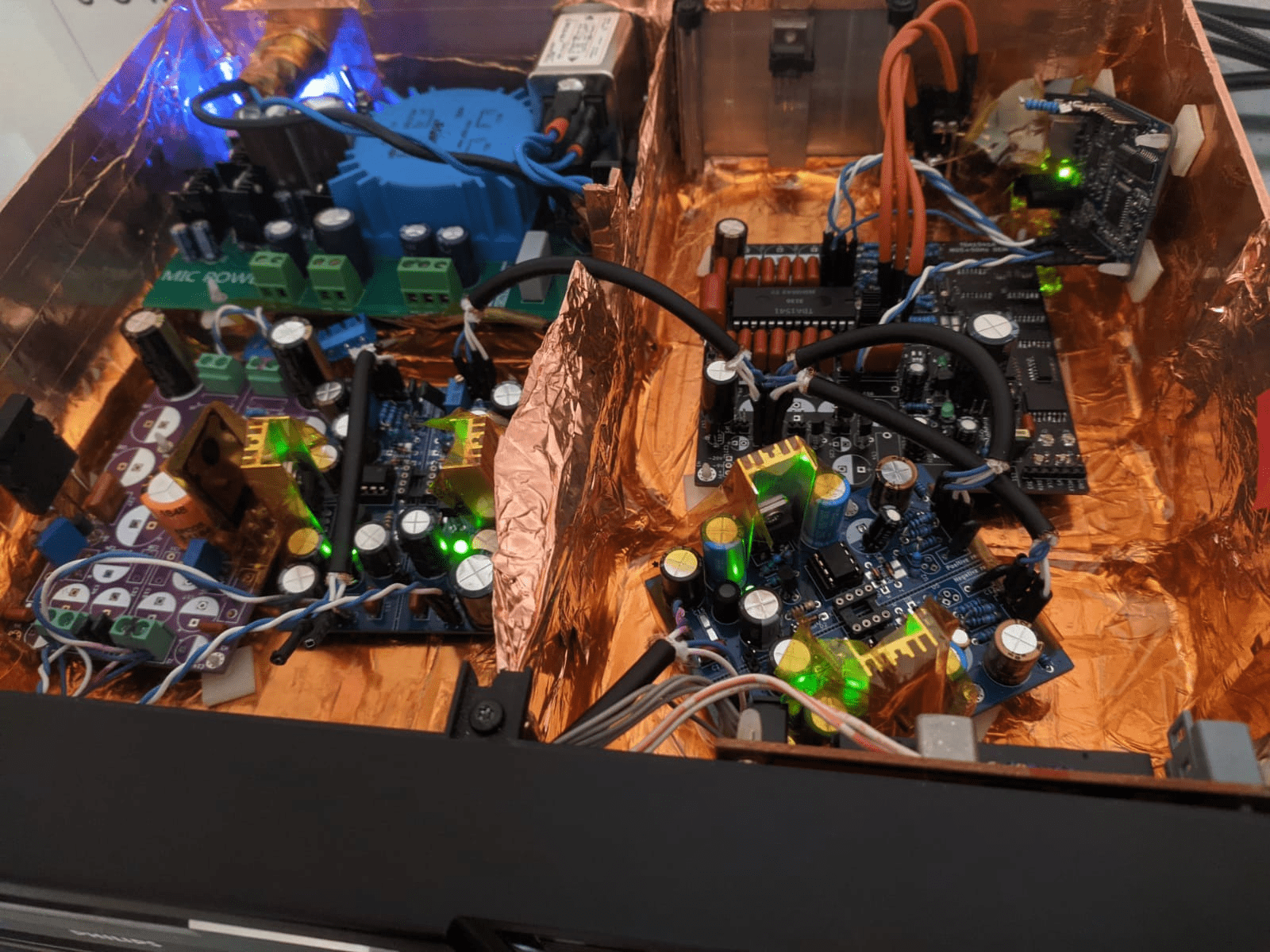

This is my balanced version
very nice indeed! how do you compare the sound with the dddac?Check the offering of Ryanj with his D3 dac board elsewhere on this forum. He made a very good dac board incorporating a lot of the ideas from this thread. He has also made an I2S to Simultanous pcb where the signal is split into +R, -R, +L, -L for a balanced drive of 2 or 4 TDA1541A dacs.
This is my balanced versionView attachment 1013413View attachment 1013414
The dddac is retired now😉very nice indeed! how do you compare the sound with the dddac?
The TDA1541A sweeps the floor with the PCM1794 delta sigma dac; it displays more resolution, more dynamics and better musical flow.
I build both dacs in a similar manner as far as possible, both are differentially used and fed with an I2S signal from the same streamer with the same clocks. So I am pretty sure the difference is in the dac chip itself. I love the TDA1541A🥰

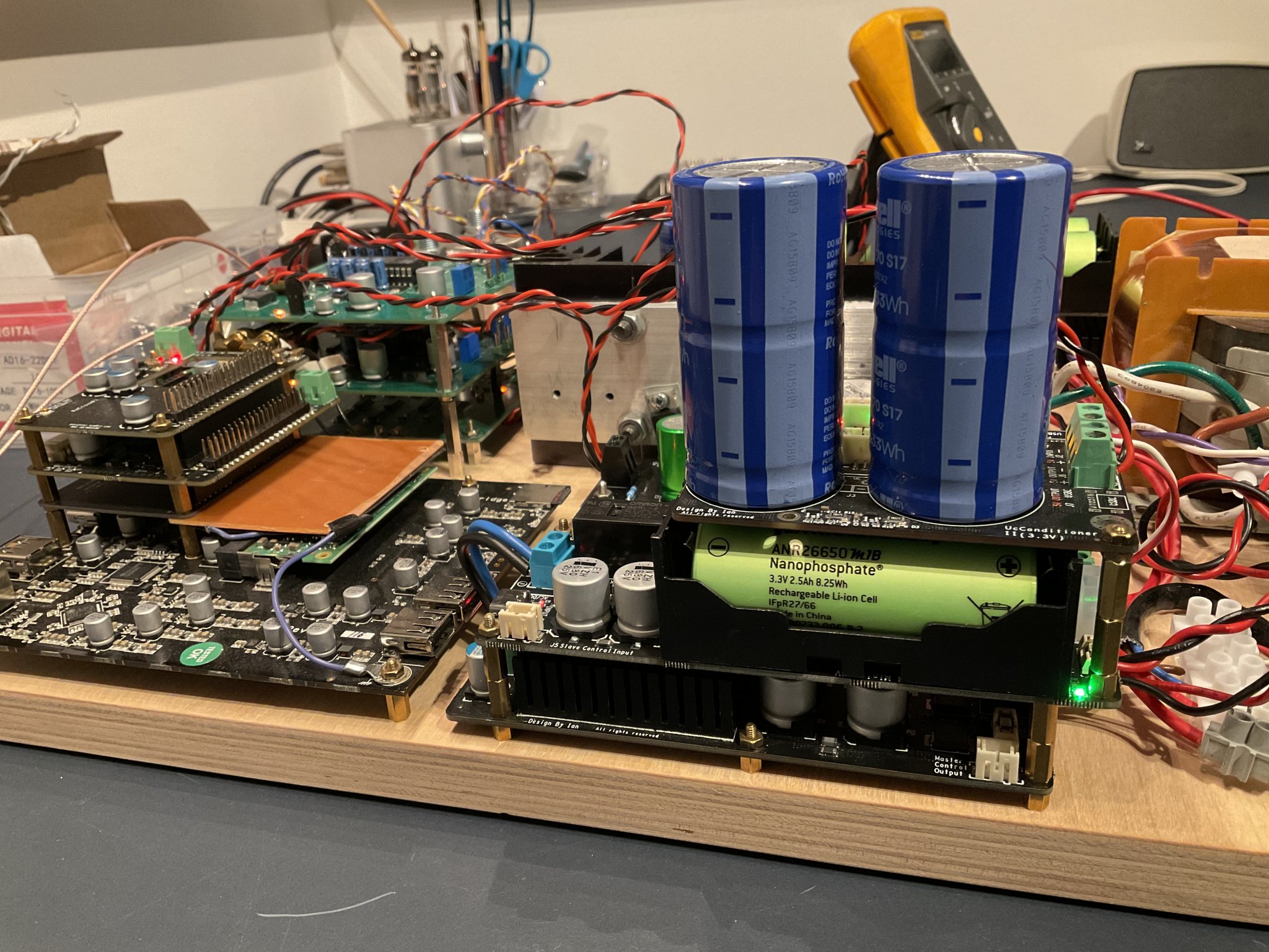

Any complete DAC offering? I gave up on my RP with Ian Canada Fifopi and Transport with LiFePO4 batteryCheck the offering of Ryanj with his D3 dac board elsewhere on this forum. He made a very good dac board incorporating a lot of the ideas from this thread. He has also made an I2S to Simultanous pcb where the signal is split into +R, -R, +L, -L for a balanced drive of 2 or 4 TDA1541A dacs.

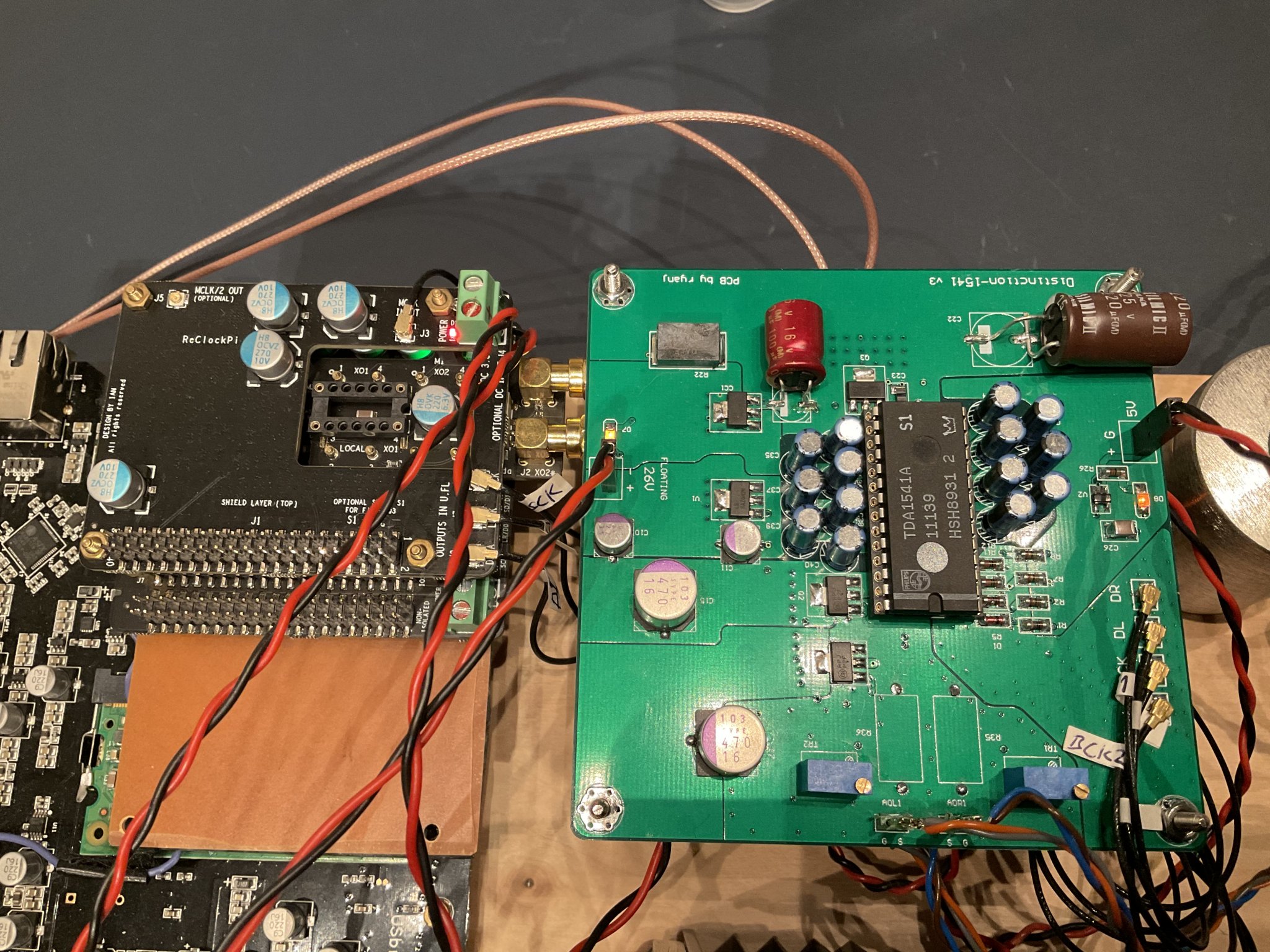

The tda1541A board i made has been put in.
Has a capacitance multiplier feeding 2 Didden superregs, and simultaneous mode output from JLsounds board. 100nf film on all 14 DEM pins, and additional 100uf muse on LSB of each channel. Put in the case of the old Philips that donated the chip, risen from the ashes (sort of). Sorry for untidy eyesore.

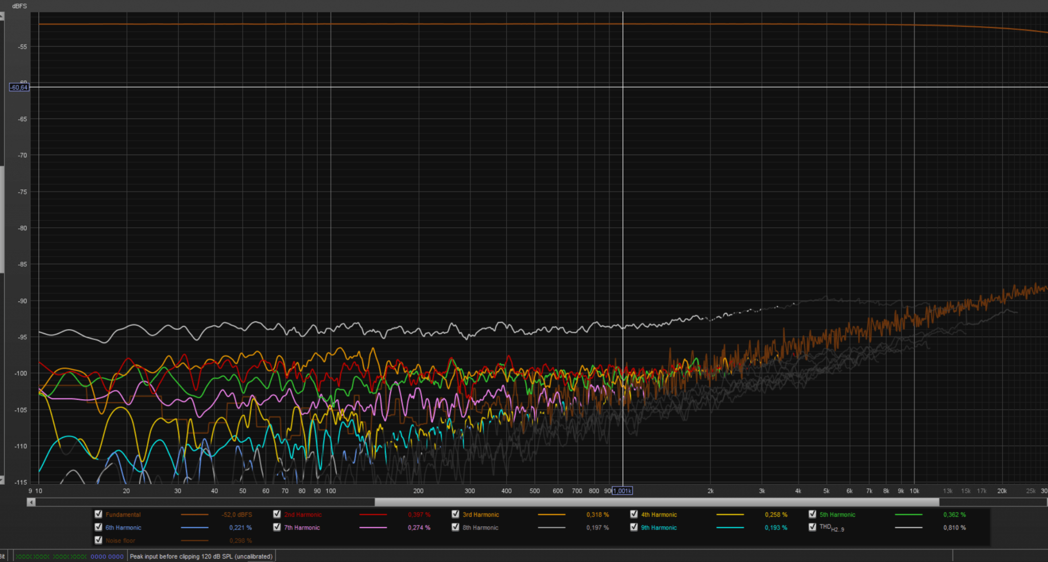

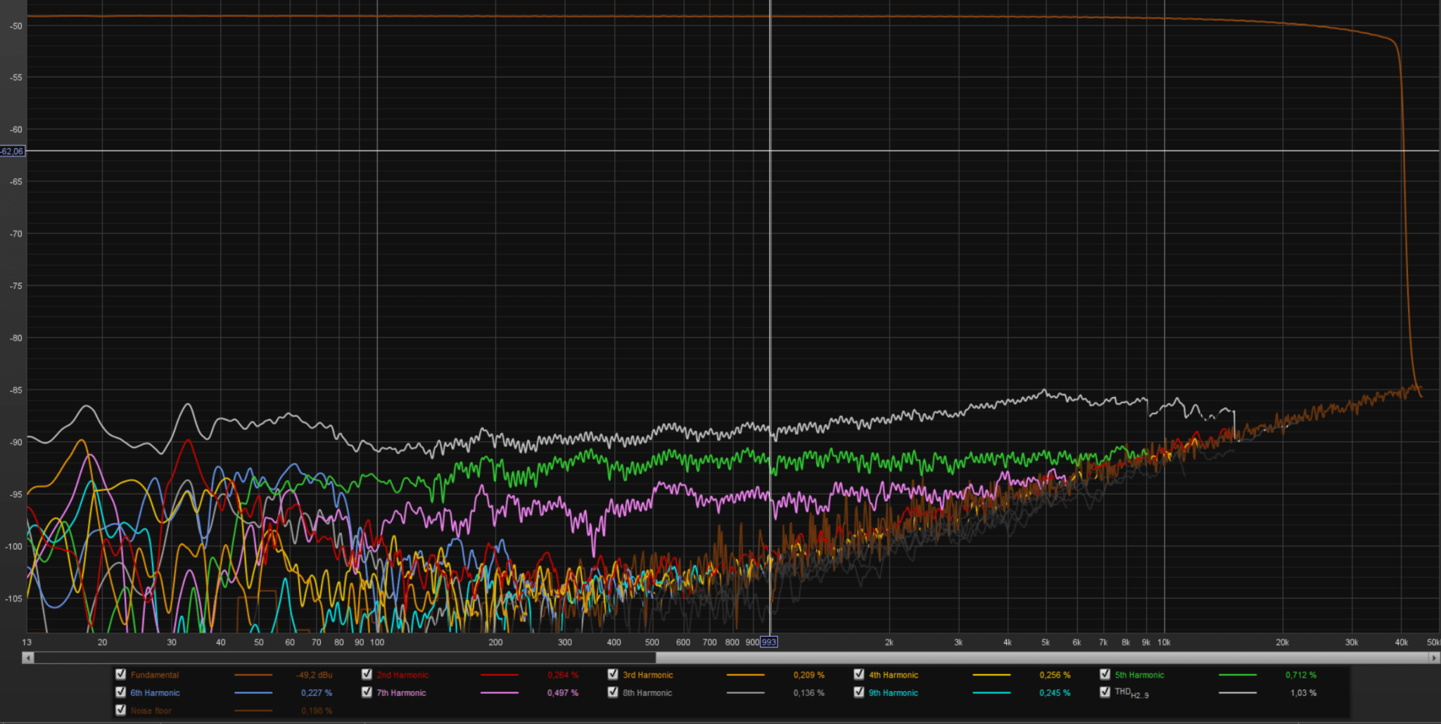

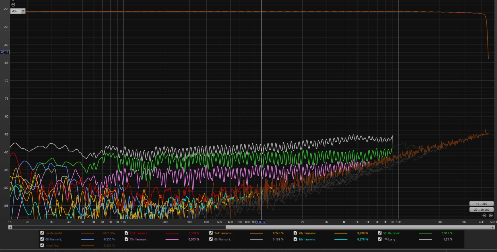

Anyway long story short, i have some sort of flutter sound. Almost like a triangle wave on top of the sine, so i was expecting maybe a high 3rd? I went to measure it and we see the following.
Volume is only -50dbfs, but ok expected for 100R I/V (and even this is too much, should be <68R
Running at higher sample rate minimises the droop and pushes images up, also good to see.
But finally, we see the higher order harmonics, 5th in particular is way louder than 2nd, 7th is louder than 2nd. 3rd is somehow buried under the noise floor where it should be. I wont quote numbers because the overall volume should be louder for that, but you can see their relative arrangement.
I have 50HZ dem but only the non-A chip. Sheet recommends to not connect those ports but somewhere i read they're actually internally connected, so i did it anyway. So first thing i do is remove the 12k resistor connected to -15v, but we get the same thing except the low frequency oscillation (probably 50hz) of the THD is now lower in amplitude, but noisier. Its interesting to see because clearly the non-A has it internally connected then.
Finally i remove the 1uF capacitor that is across the pins.
Finally, higher order junk seems to go down. But interestingly, overall 2nd order and 3rd order seem to go a bit up, so maybe it was doing something good as well. 5th harmonic, despite going down is still about as loud as 2nd. Of course the big problem with all this is how low the volume is , i really need to either a preamp or a different I/V scheme or something. But still what do you think? How to interpret all this 3rd, 5th, 7th stuff that is so high?

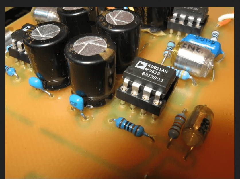

I think that the problem is not in PCM1794A itself, but in its implementation, PCM1794A is not designed to work in NOS and without any output stage, ie I/V conversion. As the PCM1794 is 192kHz, the absence of an HF filter in the output can be a problem, especially if it is pushed into NOS mode, which further highlights this problem.The dddac is retired now😉

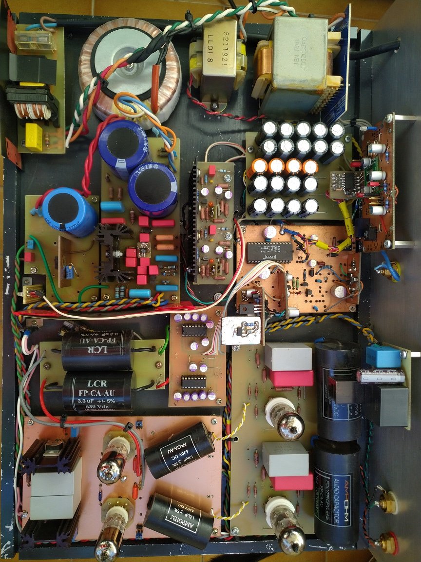

My first d.i.y DAC was with TDA1541, passive I/V conversion and tube output and it sounded great ,just as you described. I also tried it with AD811 as I/V but the sound of the passive I/V and tube output was better. Now I have been using the PCM1702 with PMD100 for a long time but with tube I/V conversion which is much better than a simple I/V with resistor. Unfortunately I haven't tried the same with TDA1541 but my friend is now doing DAC with TDA1541 so we will try tube I/V conversion on it.
I am now working on a new DAC with TDA1547 where I gave up of NOS mode precisely because of the problem with HF interference which further complicates the output stage itself. One day I will give PCM1794 a chance (I already have a couple), but only when I design a good tube I/V for it.
Just to add that TDA1541 loves shunt regulators, the same can be said for all other dac i.c. which I tried.
