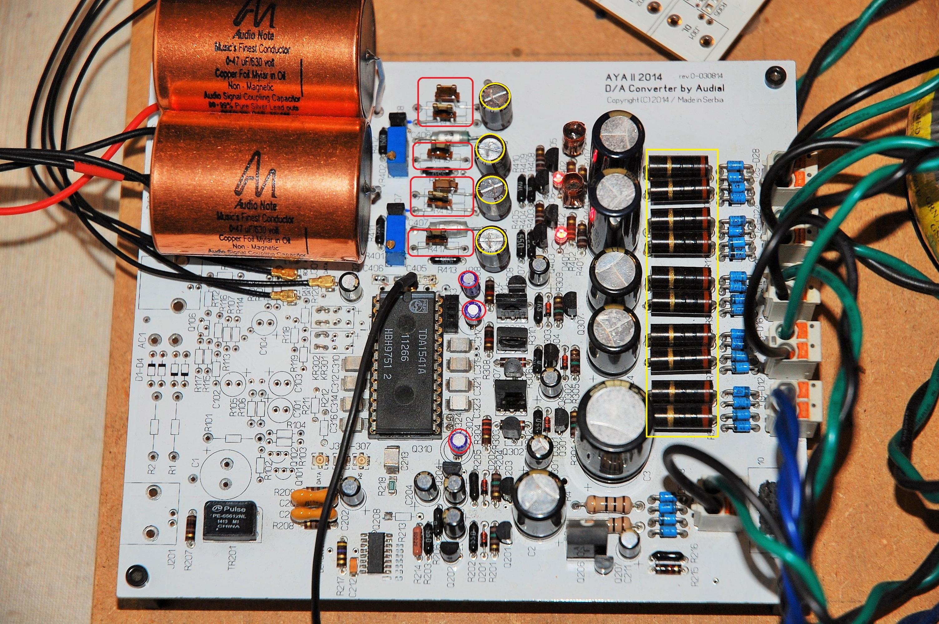

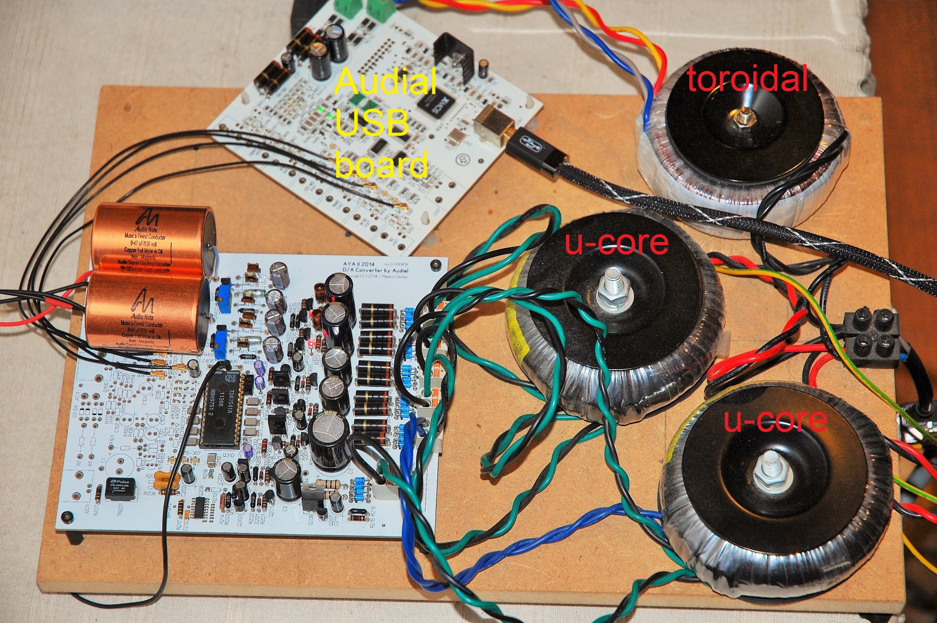

Hi all:
To refocus the debate on the topic I leave here a few pics about some of my latest attempts to improve (the already great) AYA DAC.
In my humble opinion what most improves the sound:
- Audial USB board in simultaneous mode;
- Vishay Z-Foil resistors;
- Audio Note copper foil capacitors;
- 1uf/50V Sanyo Os-con capacitors around TDA1541;
- 10uf/50V Elna Silmic II around I/V and buffer op-amps
- Allen Bradley 1W resistors after diodes.
I hope you enjoy it and that the authorities (like summotan) comment on this.
Long life to the TDA1541A!

That all looks really good!.. have to say that I also have an older version of the same board and it plays just as you know it does; wonderfully well.

Nice, did you perform a before & after sound test when you change the rectifier diodes & the AB carbon resistors, if so what's your findings ?
I suppose the AB's add warmth as your using naked foil resistors on i/v stage & after.

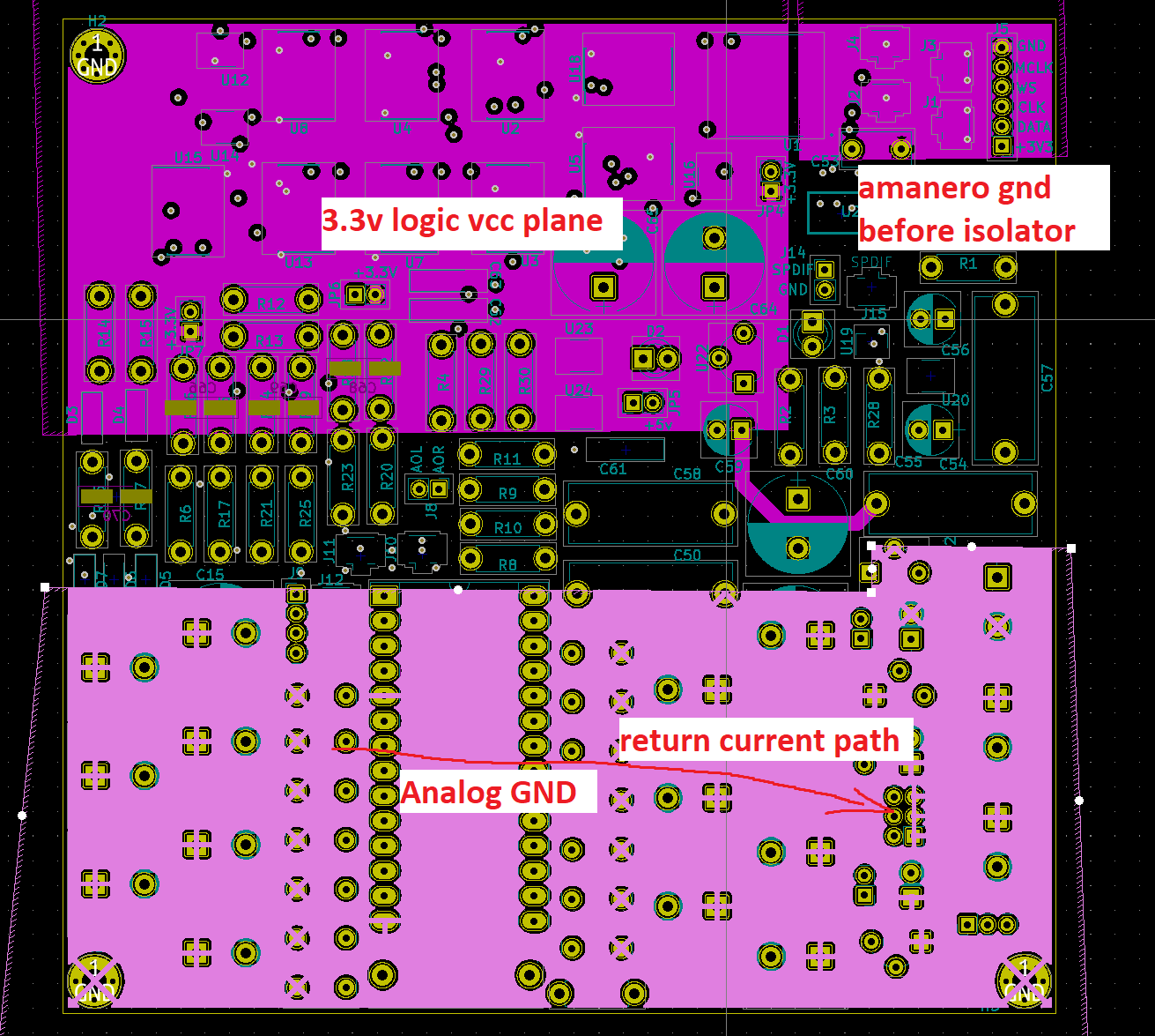

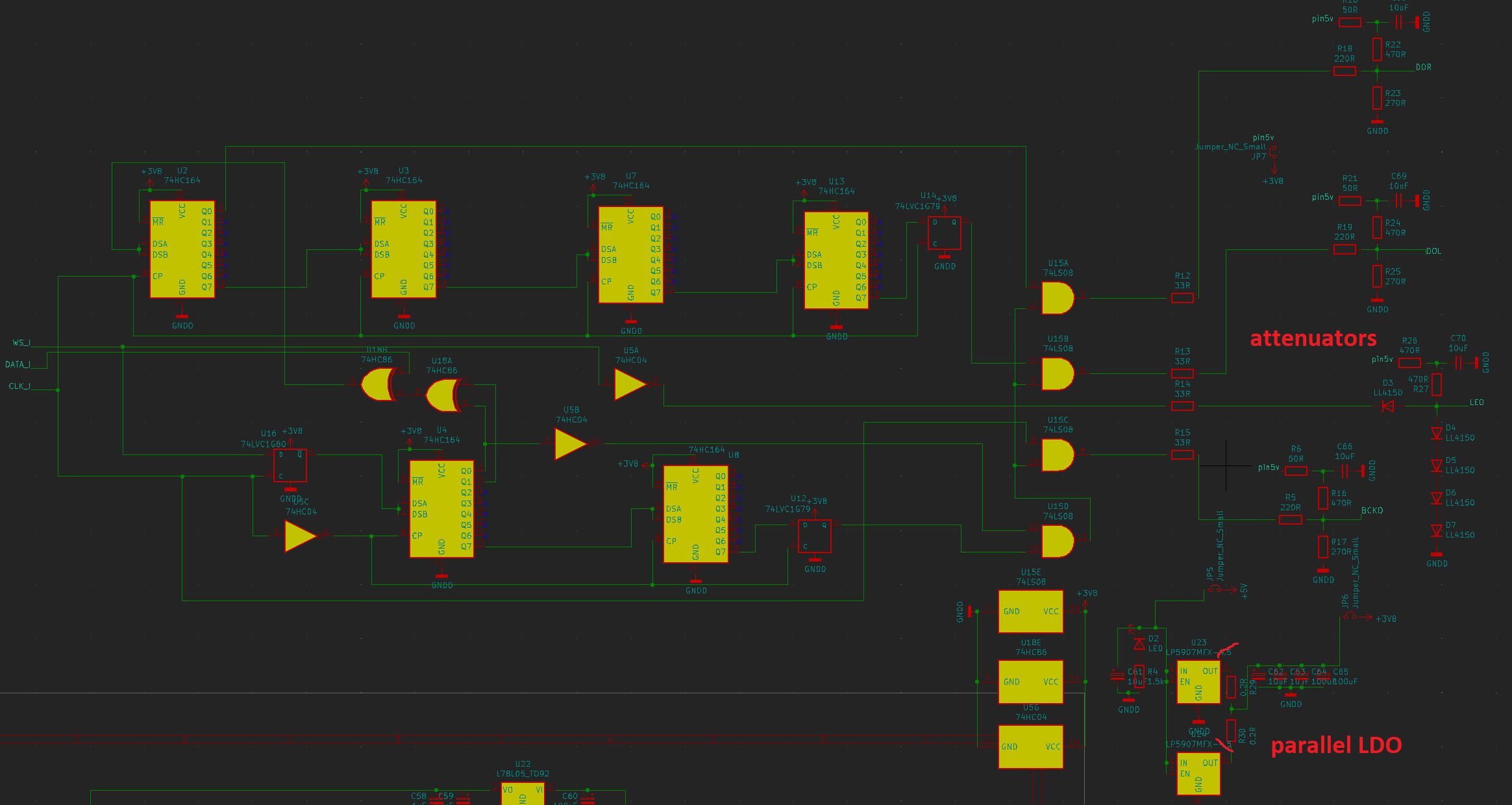

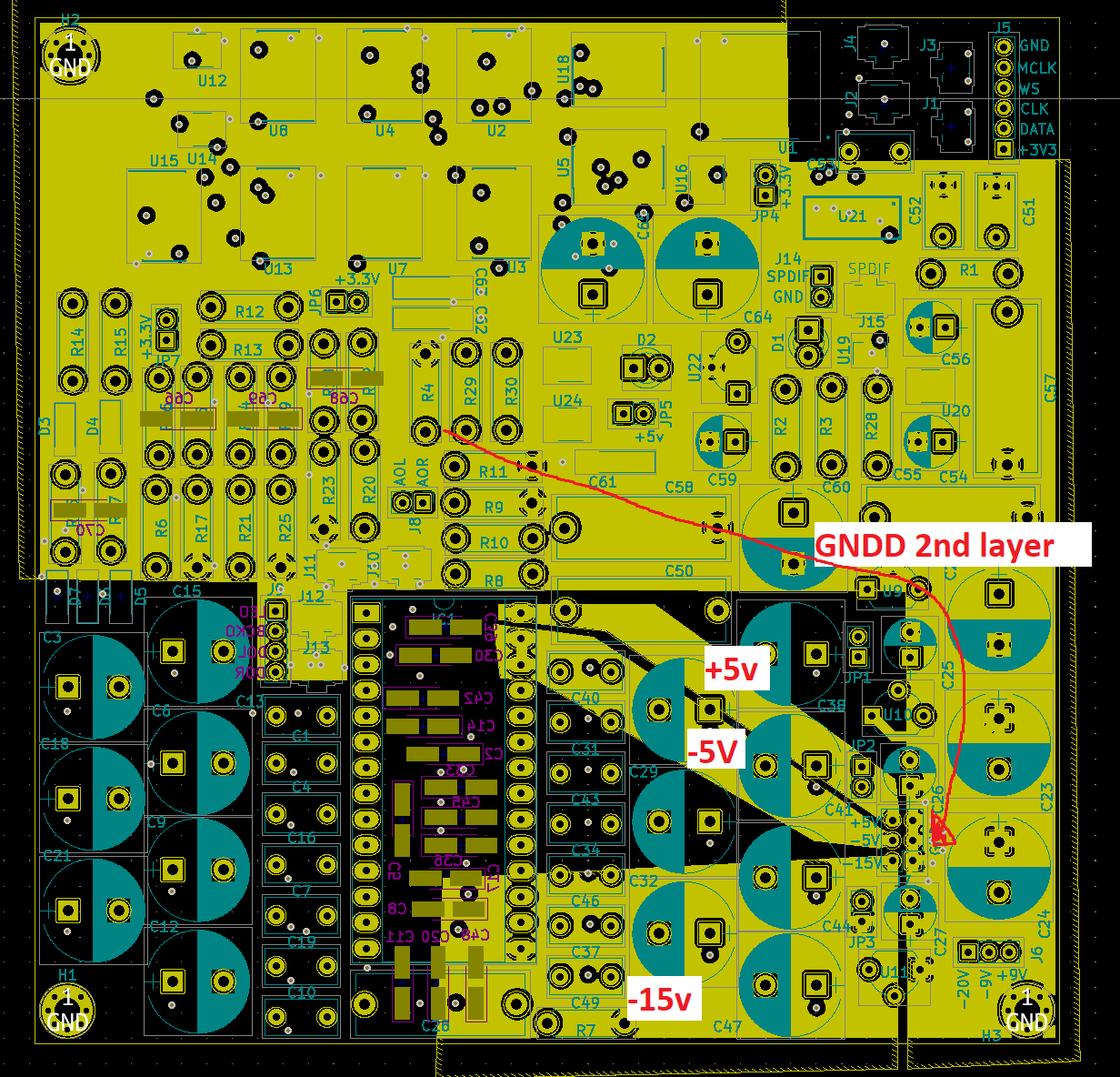

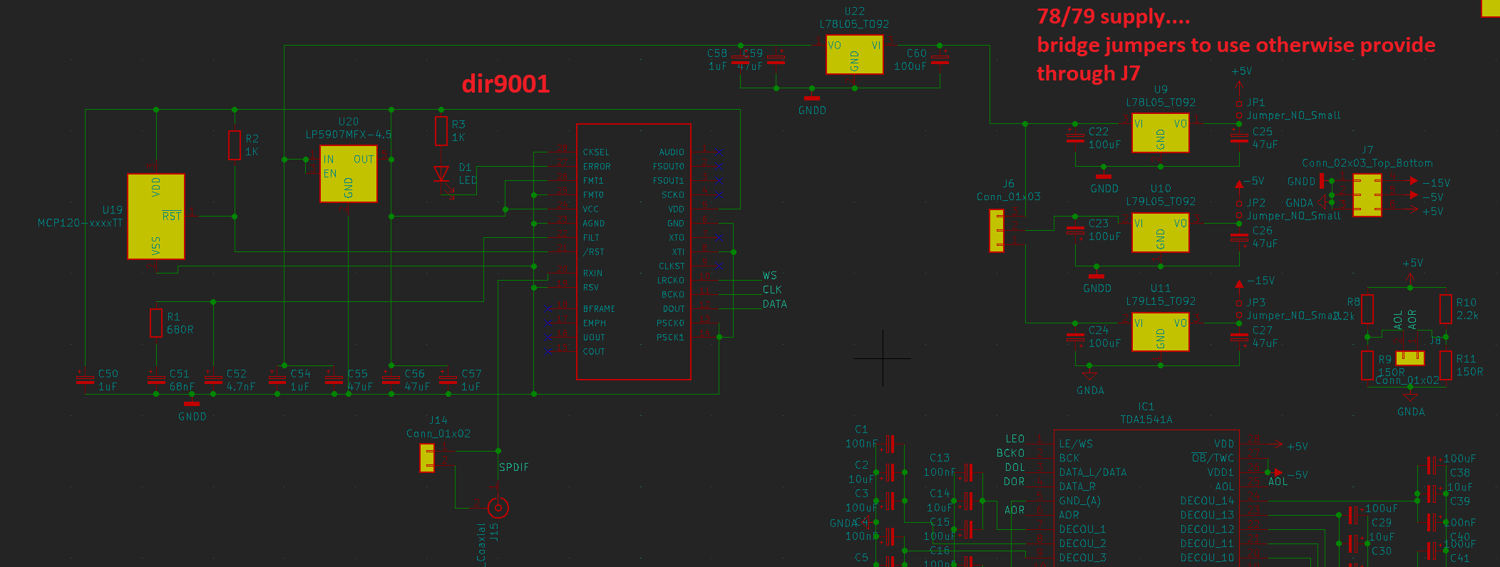

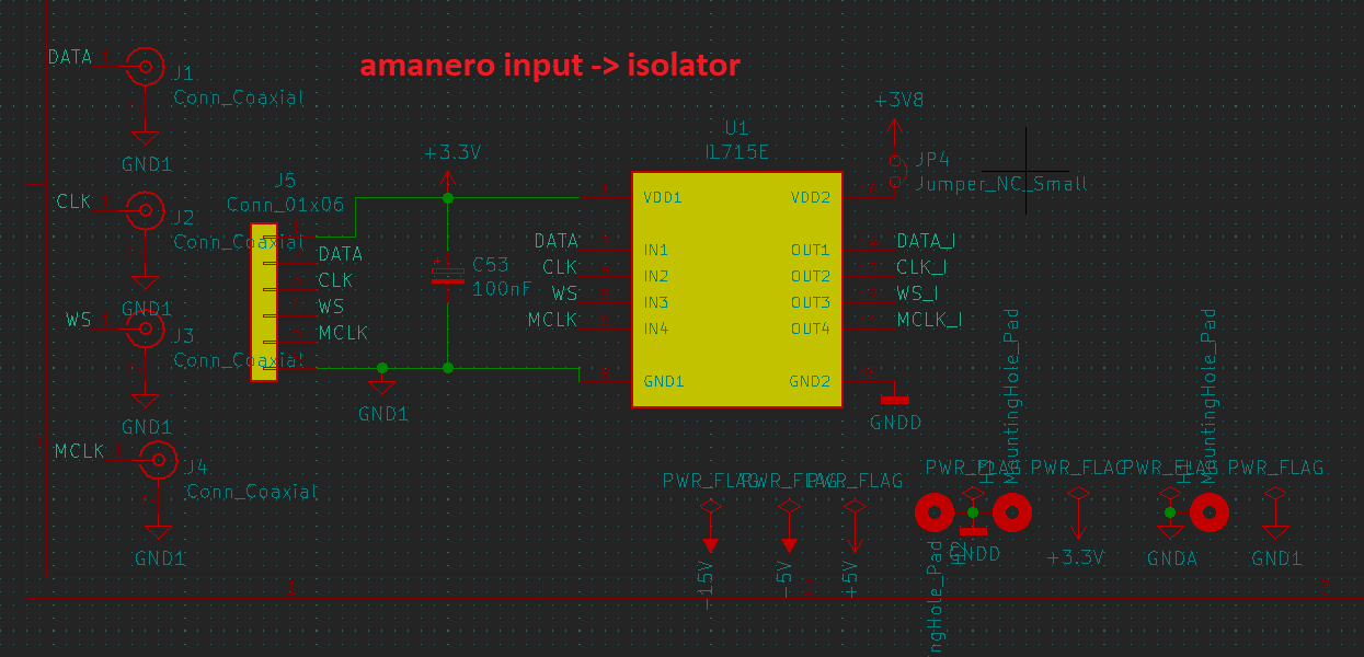

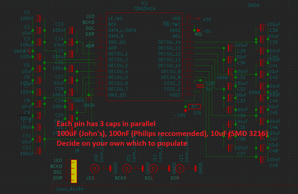

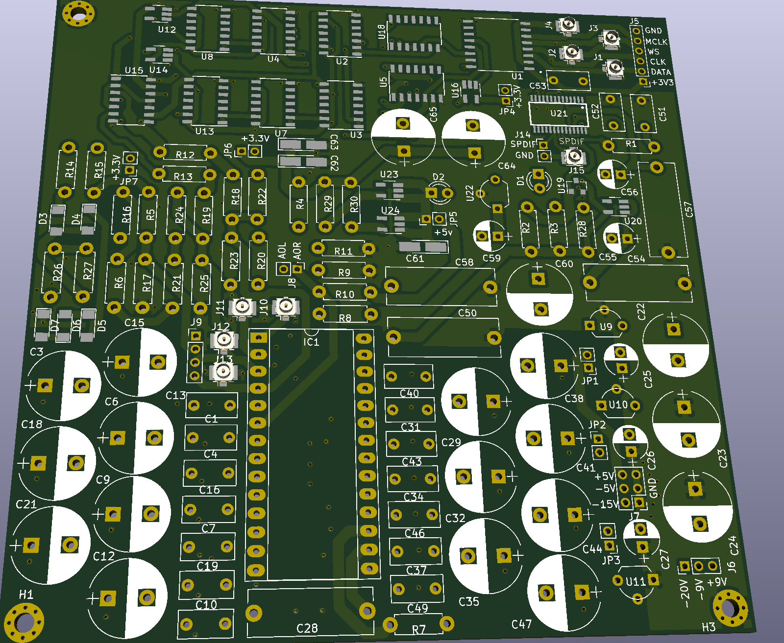

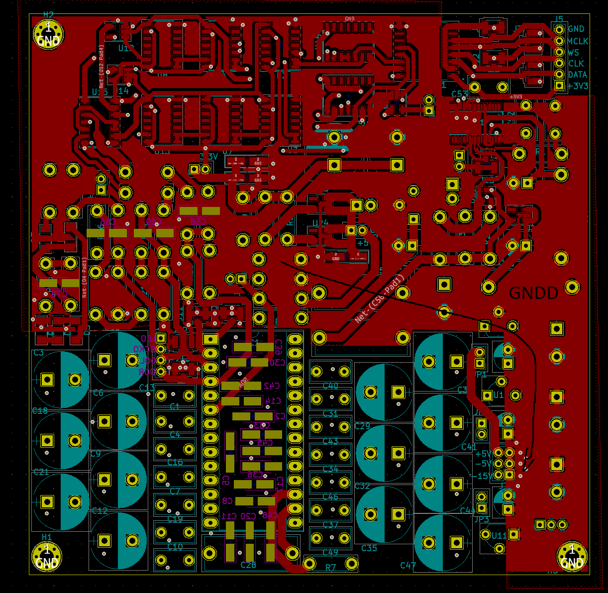

Finished the preliminary layout of the board, I would appreciate any input to see if i made any major blunders.
-4 layer board
-GNDA and GNDD is on different planes, but connected together at the source (afaik logic return currents should not touch the analog at all)
-3 different options of bypass caps, populate as you wish
-excesive number of headers, jumpers and u.fl's in case you want to bridge something, use external PSU's for everything, or bypass certain sections. For example you can keep the whole DIR9001 section off if your input is from amanero/xmos.
-i2s attenuation
-Il715 isolator on input
-plenty of stitching vias
That is it, you pretty much know the drill if you've been following the thread, thanks once again to John and others for their contributions!! 😀
The board is a bit tight because my absolute requirement was that it be 100x100mm or less, this is exactly 100x100mm.
I have posted images here on imgur album, and in the post itself.
Pictures album
I tried to write text on them to make it a bit easier to go through, and at the end are included screenshots of the schematic that this is based on. (on
I will wait for a couple of peer reviews, after that get the board fabricated, then test it, and then post the gerbers. Thank you!

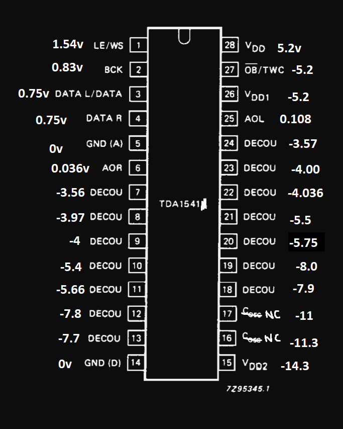

Built and assembled DAC in post #7972 (just above) but having bit of an issue..
Sound coming out is very distorted and crackling, almost like somebody blowing into the mic. Hard to tell even what music is playing really..
I am using Amanero as source and tried all bit depths and sampling rates, and bit depth doesn't change it much but 384khz sample rate improves it somewhat (but issue is still there).
When nothing is playing, there is a digital sounding "buzz" which im pretty sure is BCKO related.
Some voltages measured (also see on attached image):
LEO - 1.5v
BCKO - 0.83v
DOL&DOR - 0.755v
I am not sure what voltages it is expecting (maybe it is way too low)
so i thought maybe there is too much attenuation on I2S lines (i am using 33R from ecdesigns to limit slew rate but after that also the attentuation scheme from D3 dac (you can see schematic in post #7972), so i tried messing with it, bridging some resistors, and bypassing the whole i2s-sim thing by using the provided J9 header (next to up left corner on dac), but it sounds probably even worse.
Then i thought maybe it is because using non-A chip, and DEM reclock part is messing with it, but removing the 12k resistor makes no difference.
Maybe DAC chip is bad but it worked at the point when i gently removed it from a philips player (which is now torn down). Its not even heating very much, barely warmer than skin. Only decoupling caps installed are 100nF and 120uF for MSB. I/V is ecdesigns passive with 150R.
Anyway i attached a pic of voltages i measured on the DAC when nothing is playing. There is suspiciously more DC offset on AOL than AOR, and somehow some voltages are weird, example pin 12 voltage is lower than pin 13 (which i thought is MSB?).
Of course also checked for cold solders, bridges on the smd logic, but everything looks ok..
Would appreciate any help / thoughts..
LEO - 1.5v
BCKO - 0.83v
DOL&DOR - 0.755v
Hi Zbunjen,
In general it is best to build a breadboard setup and test circuits thoroughly before even thinking of routing a PCB.
I suggest to test sub systems to locate the problem.
First check if the TDA1541 (still) works correctly:

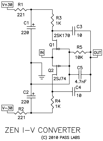

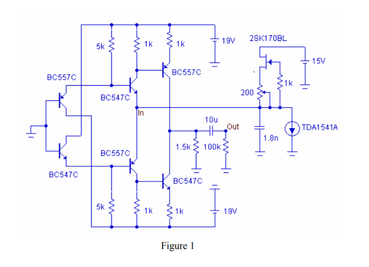

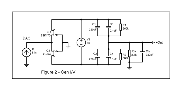

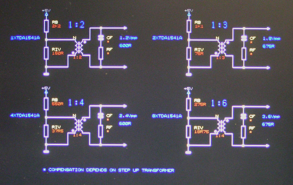

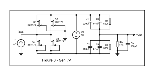

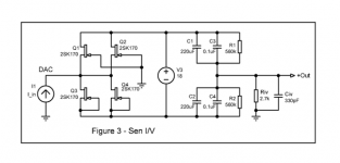

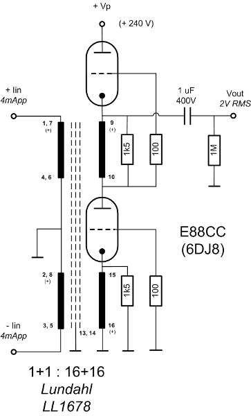

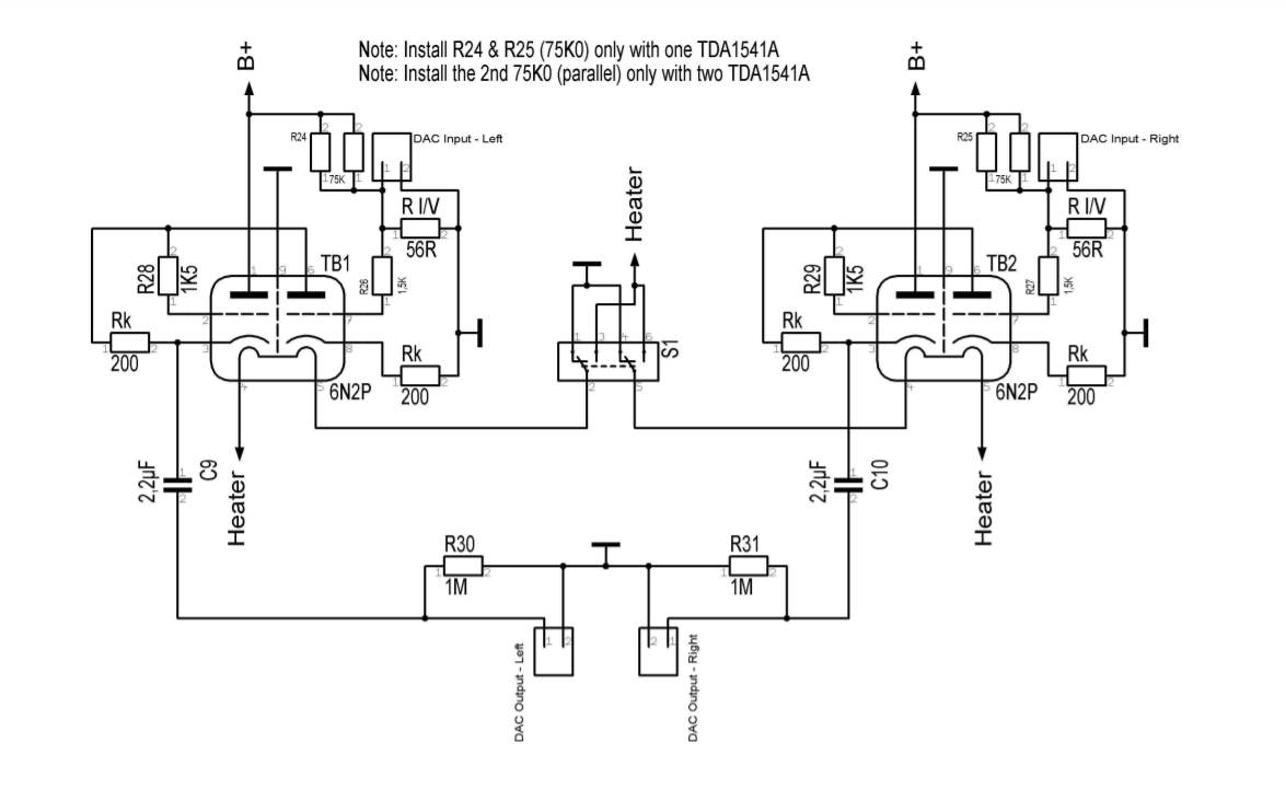

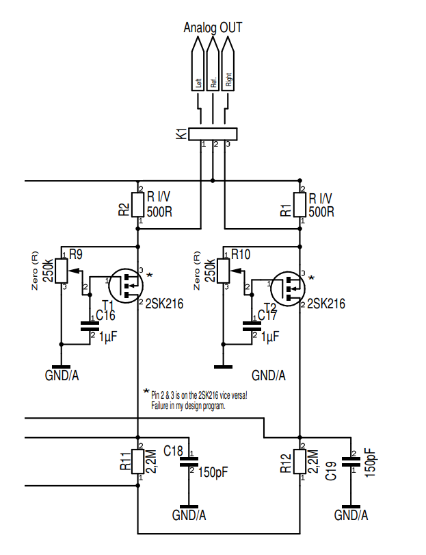

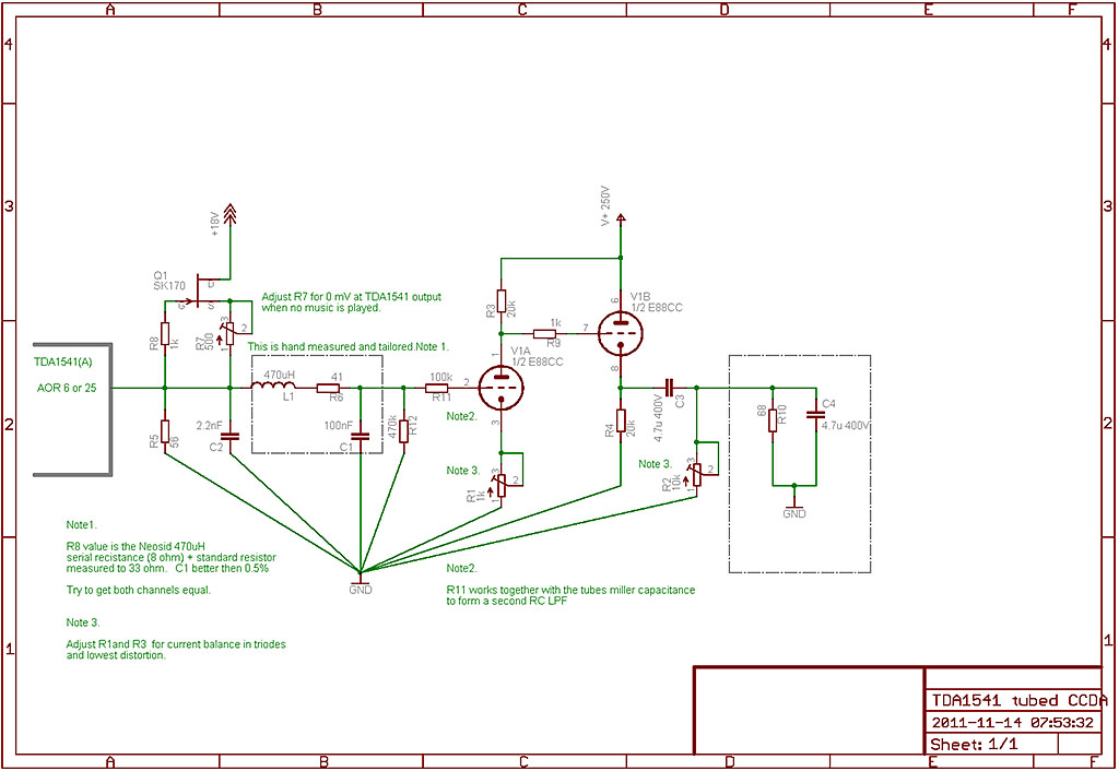

btw the IV stage is really challenging
since there are no one confirmed yet
which one is the best IV converter for TDA1541 dac
to be more concise
i collected some of them here,
which one of these iv are best for tda1541??
thanks.
Peter
and this vintage '80s dac still have a lot of fans today😀
including me...😉
to be more concise
thanks.
Peter
not sure which one would be the best but most of them won't work without nulling -2mA offset coming from TDA1541A, unless TDA1541 is different than TDA1541A in that matter.
