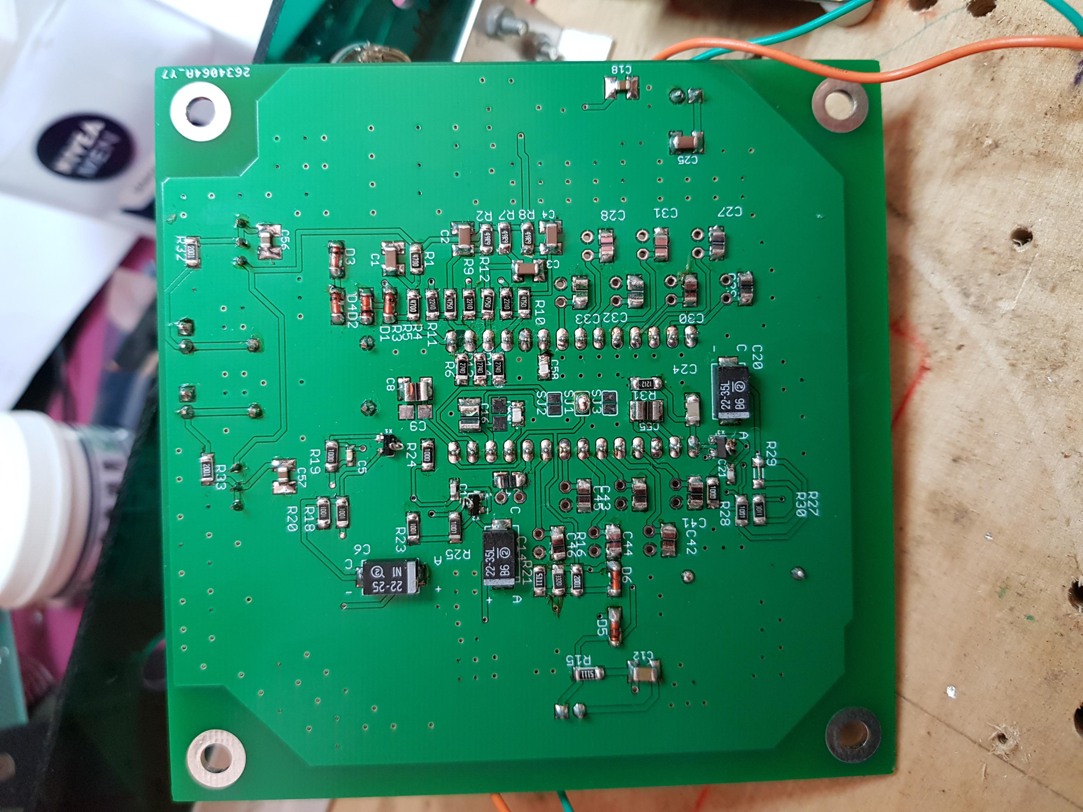

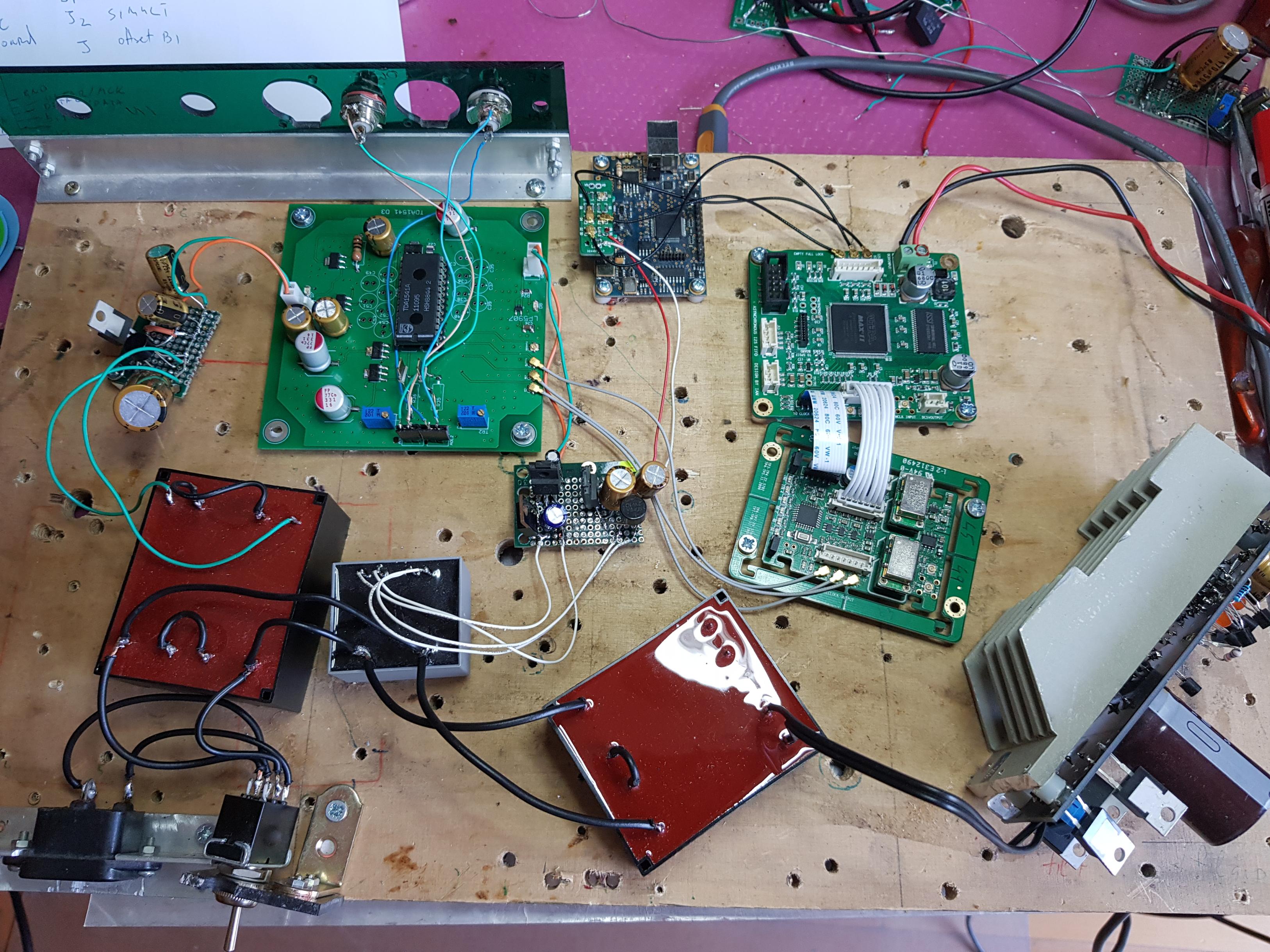

I for one fail to see any wrongdoings on Ryanj's behalf. On the contrary: a well documented and shared with the community project incorporating a lot of the current thinking about the 1541A design. Is it the best possible implementation? Perhaps not. Is it fully original? Certainly not, but Ryanj never presented it as such and always gave credit where credit was due.
Being curious after all the buzz i shamelessly used his design and tried out for myself how a modern 1541A implementation stacks against my '90s attempts and also against my other dacs.
Curiosity is now (mostly) satisfied for which i owe Ryan a big "THANK YOU"
The ugly board is of course not one of Ryan's.
