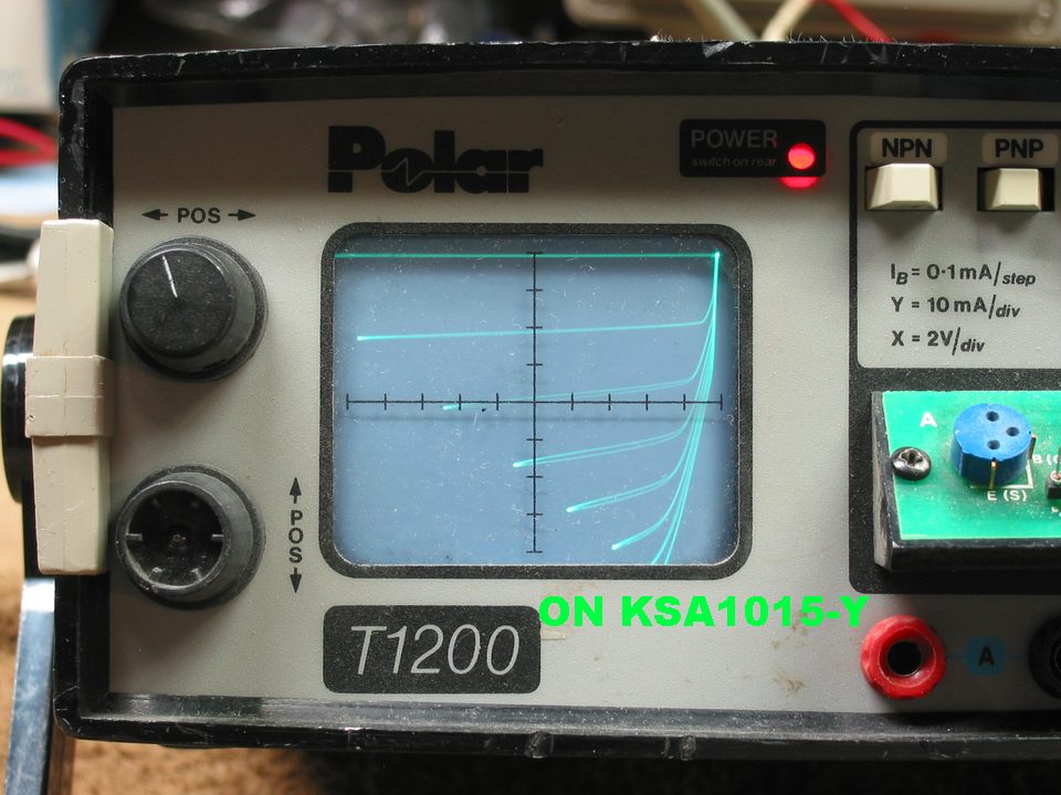

Now I'm looking at how to curve trace transistors with an analog scope in X-Y mode. I think this can be better than digitizing curve tracers, it will give an idea which transistors are the best (for example looking at the "return sweep" as mentioned here: https://www.diyaudio.com/community/threads/jlh-headphone-amp.159202/page-47). If the sweep forms a loop then there's memory distortion (thermal memory, that we have discussed a few times). I took the image from the link above where member jbau looks at curves of small signal transistors.

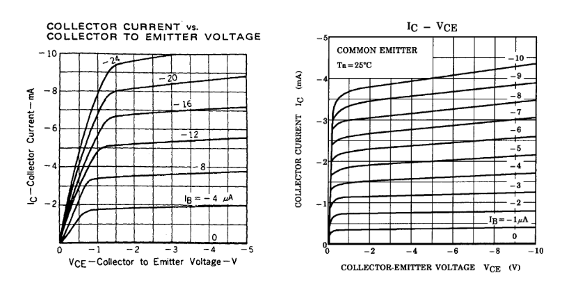

I didn't want to make it too complicated but the choice of transistors is important. What to look for in a datasheet? One important thing is Early voltage. Looking at Ic versus Vce, the more Ic variation over a Vce range, the lower the Early voltage (not good). When Ic stays almost the same over a large Vce variation then V Early is high (good). This is quite important if the circuit has PNP current sources because the PNP usually has much lower Early than the NPN. BTW we should avoid high beta transistors for a PNP current source because high beta usually comes with low Early. We want high early for high CCS impedance.What one should use for the transistors TO-92?
Below you can see data for the 2SA970 (right) and 2SA992 (left). From this data I estimate that A970 has higher Early, about double the Early voltage of the A992. But don't trust the datasheets - check the parts on a curve tracer if possible. An old curve tracer (CRT) shows a lot like I mentioned in the post above. I don't have one, I'm looking into using my analog scope as a curve tracer.

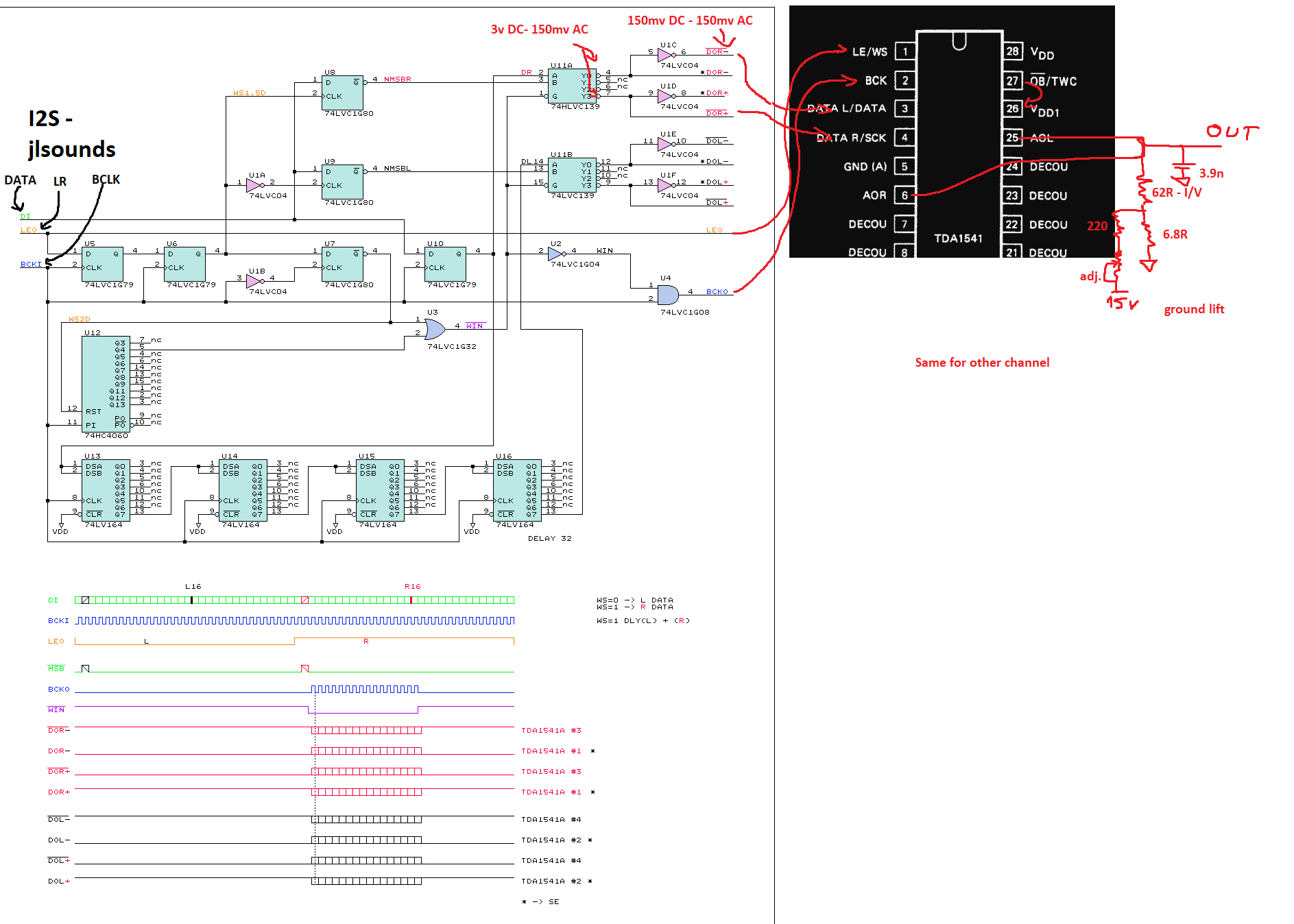

Can i get a sanity check?
I've checked it over and cant find the fault.
Basically i got the rest of the caps i needed, and hodgepodged a tl431 to output 3.3v, since i dont have the LDO i should have, and went to test.
Lucky i have all the "breakout" jumpers so i can switch things around for testing.
Dont think its the I/V section, so i dont know...
The "AC" measurements are just RMS by a multimeter, dont have a scope near me right now.
Data lines would go from 0 to about 150mv AC, scaling with volume, but i feel like it should be a bit more.
I also tried the DOR+ * and DOR- * (with the asterisks), indicated as SE on the diagram. And basically every other permutation i could. On some permutations i can get it to have an extremely distorted sound, but nothing more than that.
So just wanted to confirm if this should even work theoretically, before i go hunting for what IC is wrong..any hints?

I would first set TDA in I2S mode, add second channel output and test usb iteface-tda only.
After that connect TS inteface and measure with scope outputs?
Then if it OK reconnect tda for TS mode and check again?

Surely you checked timing or did a functional simulation before you had a pcb made ?So just wanted to confirm if this should even work theoretically,

Okay if schematic doesnt have gross errors (and its fairly simple so...), think i'll do that then.

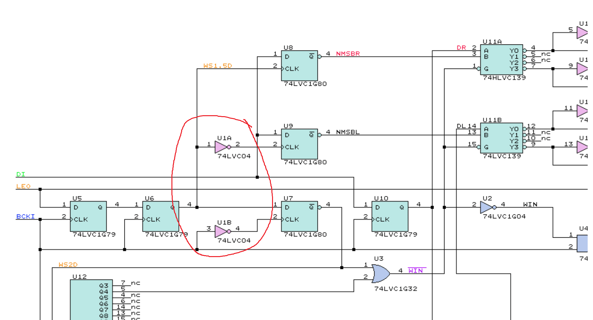

The only thing i changed from original post #7092 is made the two circled components separate (lvc1g04 instead of lvc04) for layout reasons, logic-wise they are the same.
I spent a lot of time on the layout, going through 7 iterations until it was elegant.
Are you sure that wasn't the design in post 7057 ?a couple of users already verified it works
