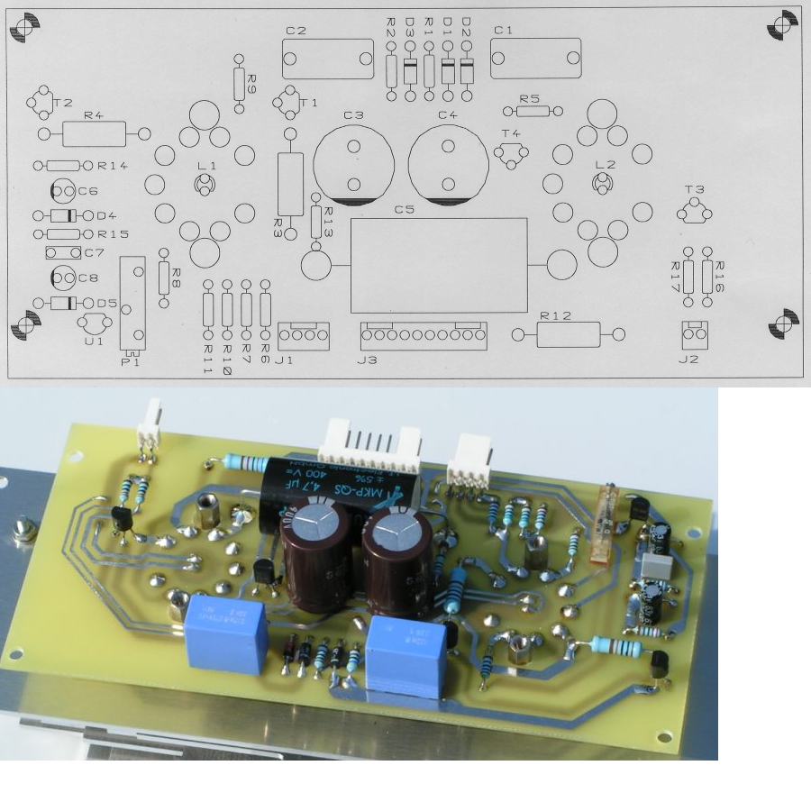

Tube sockets
Hi adhoc,
thanks for your reply [post#784]
The tube sockets are high quality ceramic PCB types, the pin's are directly soldered to the printed circuit board / no wires, so connections are as short as possible. The sockets are in turn fixed to the aluminum chassis using fixating rings supplied with the tube sockets and hexagon threaded spacers that enable easy fixating. In addittion, the printed circuit board can be fixated to the chassis as well using spacers. Mounting holes are already provided on the PCB.
The tube output stage module is very easy to build. Solder lug type sockets can be used as well, then short solid wires can be used to adapt the solder lugs to the printed circuit board.
I added both a silkscreen plot and a photograph of the tube output stage printed circuit board, the PCB tube sockets and 3mm high-brightness status LED's are mounted on the solder side, all other components are mounted on the component side. This way there is enough space between the chassis and the printed circuit board. All connections are made trough PCB connectors, so the module can be removed very quickly.
Hi adhoc,
Thanks for your reply EC.
The reason I asked that question was because I intend to mount the tubes horizontally (to fit low profile case - height around 2.2") and was wondering whether that was possible with your 'default' design. Now I know. 🙂
If there any other components that exceed 2" in height, it would be great if you could let me know as I intend to order the case soon. Thanks!

Housing dimensions
Hi adhoc,
thanks for your reply [post#786/787]
2" height could be a problem, transformers used in both power supplies probably won't fit. I placed the tube output modules above part of the analog mainboard, so that won't fit using 2" height. The 2mm thickness of the aluminum plates however is no problem, I used 2mm thick aluminum plates for most parts as well, exept for the sidepanels.
Maybe it's wise to wait with the housing, and check module dimensions first, I can measure the exact dimensions of each module if this could help. But a height of approx. 3" is the minimum. The grid around the tubes has a important function, screening, it helps to keep hum levels very low. Placing the tubes horizontally, close to other parts can cause oscillation. Long wires routed from the printed circuit board to tube sockets could have a similar effect.

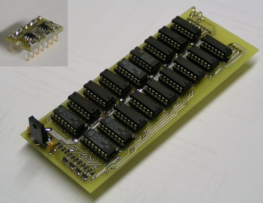

Time to start ?
Hi adhoc,
thanks for your reply [post#789]
Octal D-I DAC progress may have been slowed down lately because of the time I spend optimizing (jitter) performance, another factor is that I still have to run my company as well and have to complete some urgent projects, so there is less time available for the octal D-I DAC at the moment.
But you are right, I can imagine some people have already gathered components and can't wait to start building.
So here is a possible solution,
I could start ordering the first batch of printed circuit boards for the octal D-I DAC core only. This is basically already a fully functional DAC.
The other printed circuit boards could follow later, when design / testing is completed.
The octal D-I DAC core consists of the following circuit boards:
Analog mainboard (1X)
DAC TDA1541A module (8X)
Autodetecting dual format timing-chain (1X), new module
I/V differential amplifier module (2X)
Ultra high speed clock buffer module (1X), new module
I added a photograph showing both new modules, the ultra high speed BCK buffer module and the new autodetecting dual format timing-chain module.
