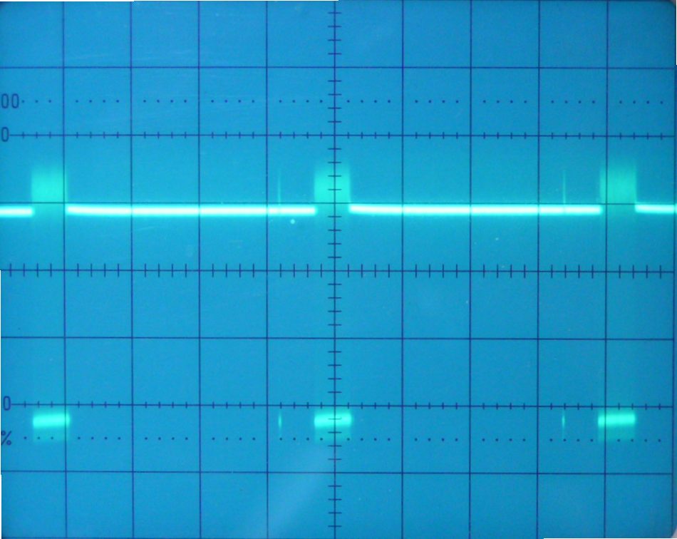

I added a oscillogram of how the USB audio stream data looks like. It consists of data bursts (packages) every 10ms. So it's quite difficult to obtain a low jitter BCK signal from this, without some form of reclocking or jitter reduction.

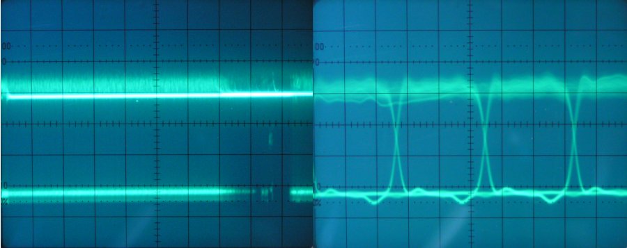

Hi all,
I added another oscillogram of the USB data, intervals are at 1ms intervals (I accidently noted the wrong value in the previous post). At the left a oscillogram of a single USB data packet in more detail, at the right, zoomed-in to view the data pattern. Note USB also uses a differential interface, the oscillogram only shows one of these signals, when both signals are combined in the differential receiver, common noise is cancelled.
There are some interesting articles on the internet about USB and jitter. Basically, with a USB to I2S interface, you need some form of reclocking to get low jitter values.
The USB audio stream doesn't have error correction, bandwith is reserved to ensure other USB devices don't interfere with the USB audio stream. According to information on the internet, when running a USB stream 24 hours a day, one error occurs once every month or so.

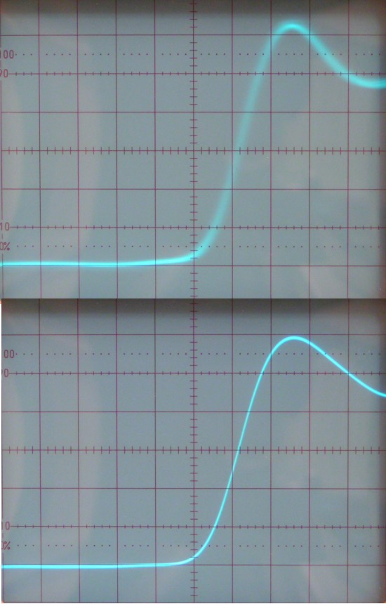

I added a direct comparison between a BCK signal dereived from a USB interface without reclocking (upper oscillogram) and with reclocking (lower oscillogram). The phase noise (jitter) in the upper oscillogram is a common value for a USB interface, without the jitter added trough ground loops (this occurs when you connect the USB outputs directly to a external DAC without isolation).
Oh yes, these are the received BCK signals in the octal D-I DAC, oscilloscope timebase settings are at maximum, .05 uS (50ns) with a X10 timebase setting so each division is about 5nS. Each subdivision represents approx. 1ns
Jitter from a USB interface without reclocking is about 1.5 subdivision so 1.5 X 1ns = 1.5ns or 1500ps! this is without the added ground loop jitter. This value is already to high and sound quality degrades.
Jitter after reclocking depends on the stability of the 48 MHz crystal oscillator, in the prototype setup using bus powered mode, it's already below 200ps, so it probably already meets the 173ps limit, by using a very low jitter oscillator and a very low noise power supply (self powered) jitter values can be lowered, but with self powered mode, special care has to be taken regarding power supply interference (ground loops). With the current setup, the pulse transformers used, have low capacitance between primary and secondary windings (around 5pF).
The 48 MHz crystal clock is divided by 4 (synchronous counter) to obtain 12 MHz clock for the PCM2706, the reclocking frequency relates to BCK as 48,000,000 / 2,822,400 = 17.0068.
