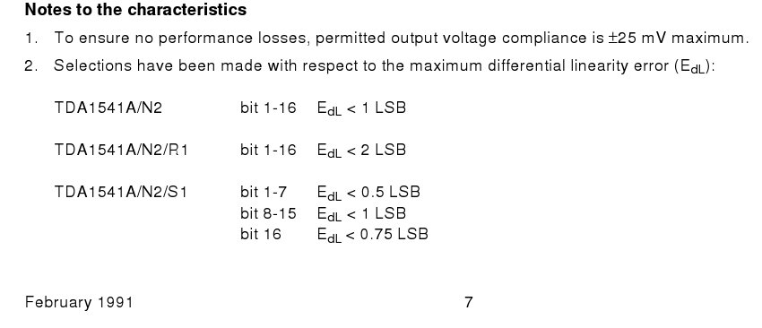

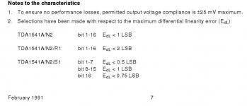

TDA1541A-$$
Hi all,
There seems to be some discussion about TDA1541A quality, again.
The same production date doesn't mean the chip's have the same specs, chances are they are not manufactured from the same wafer, and even a single wafer can have impurities that can affect individual chip specifications. Chip's are already classified, according to the measured parameters, regardless of production date. So if you order a R1, you get a TDA1541A that meets R1 classification, regardless of production date.
The marginal differences in TDA1541A quality are blown-up out of proportion. According to this the TDA1541A-R1 is so bad, it should be avoided. The double crown is the only one nearly good enough. But what are we talking about?
TDA1541A (standard): Edl < 1LSB ($10)
TDA1541A-R1 (relaxed): Edl < 2LSB ($17.5)
TDA1541A-S1/S2 (single/double crown): Edl < 0.5...0.75LSB ($90)
Yes I checked this many times now, R1 has Edl < 2LSB, R stands for "relaxed" specifications. Bernhard's measurement's seem to confirm this (thanks Bernhard). I have a relative that works at Philips semiconductor division in Eindhoven, I will ask him to verify this as well, as he knows one of the engineers that was involved in the TDA1541A design. I also added the selection specifications noted in the philips datasheet. It is dated february 1991, if the data contained in this datasheet was incorrect, they would have corrected it by now I guess.
So basically we are making all this fuzz, when the plain TDA1541A (cheapest one) already has a Edl of < 1LSB. As can be seen on the photograph of the analog mainboard [post#715], there is no R1 or S1 marking on the TDA1541A's. So if I am correct, all listening tests and measurements are based on the plain TDA1541A version. And it's sound quality is good enough for me.

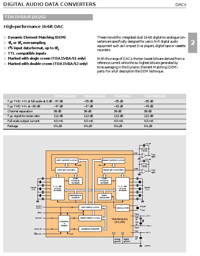

Hi Thomas,
Thanks for your reply [post#806]
I appreciate your effort to supply (TDA1541A) chip's for this and other projects, it's good to have a reliable source for this. As you can see in the specs below there is only 1dB difference at -60dB between the plain TDA1541A and the R1 version, that's all.
These should be the correct specs for the TDA1541A versions:
TDA1541A/S2 : Typ. THD+noise (0dB) -97dB, THD+noise (-60dB) -47dB, Channel separation 98dB, S/N ratio 112dB
TDA1541A/S1 : Typ. THD+noise (0dB) -95dB, THD+noise (-60dB) -47dB, Channel separation 98dB, S/N ratio 112dB
TDA1541A : Typ. THD+noise (0dB) -95dB, THD+noise (-60dB) -43dB, Channel separation 98dB, S/N ratio 112dB
TDA1541A/R1 : Typ. THD+noise (0dB) -95dB, THD+noise (-60dB) -42dB, Channel separation 98dB, S/N ratio 112dB
> I used the plain A version in my twin DAC (balanced/DATA inverted on one TDA1541A) with the 8th order Butterworth filter, it works fine, so your balanced DAC should work fine too using the TDA1541A. However when using only one or two DAC chip's, their specifications have more impact on sound quality of course.
> The main difference between TDA1541A versions is low level performance. So this does improve with both S1 and S2 versions, this also explains the better sound quality you heared, using these chip's.
I added the TDA1541A specs from philips that conflict with the TDA1541A datasheet
It is obvious that there is an error in that specs table as one can see from left to right S2 S1 plain selection grades go down and R1 is the last so it must be the worst. -60dB specs are mixed up between R1 and plain here, that could be the reason that people think R1 is a + grade.
