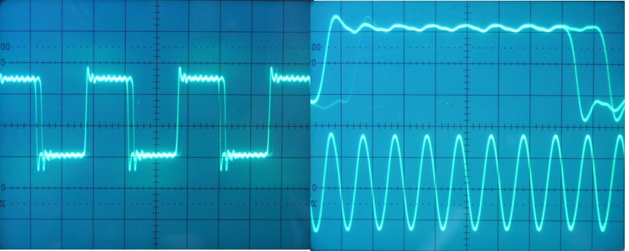

Tackling USB / I2S interface jitter
Hi Ulas,
Thanks for your reply [post736]
> I am measuring jitter correctly, yes I trigger on the rising edge of BCK, but I also look at a number of following transients as well (timebase X10), this way yitter on both rising and falling edge of BCK can be examined. I added a oscillogram to proove this. The left oscillogram clearly shows that the reclock side effects are concentrated on the falling edge of BCK and the leading edge of BCK is relatively clean and contains very low jitter. The oscillogram on the right shows the reclocked BCK signal and the 48 MHz reclock signal. Now see what I mean? The next experiment is to trigger a digital one-shot circuit on the relatively clean BCK rising edge and overrule the two phase trailing edge, then both transients are clean. Then we have both, optimal sound quality and a fancy looking BCK oscillogram
> Yes you can laugh, but the circuit I build improved the USB / I2S interface in a way it had about the same sound quality as a direct I2S interface comming form my CD changer. I am pretty sure many USB / I2S interfaces don't even come close as sound quality is concerned. The big difference with standard asynchronous reclocking is that the leading edge of BCK has lower jitter and the two phase jitter is concentrated at the falling edge of BCK.
> I already explained that a high amplitude 2 phase jitter has far less negative effect on the audio signal than the 200ps continuous jitter from a CS8412. But you can also read Kusonoki's article about this issue. Now I further improved this by reducing leading edge jitter.
> Adding a asynchronous reclocker replases the continuous phase (phase noise) jitter with a consistent two phase jitter that in turn is locked to a stable crystal clock signal. If this type of jitter was worse than 200pS continuous jitter, sound quality had to be very bad, but at the contrary, sound quality improves.
> Personally, like you I preferably like to remove all jitter and obtain a perfect almost zero jitter signal, but as I said, the used USB reclocking setup is a good alternative that works, and I am even experimenting on improving this setup. I am just exploring solutions to this problem, that's all. I also tried various PLL setup's (slowly averaging systems) but basically adding a PLL makes things worse. If I am correct, PLL output frequency has to vary a bit in order to maintain phase locking, so basically it always jitters. If you got idea's to tackle jitter, given this setup I am very interested.
My approach to the USB interface is to accept the (large) amount of continuous jitter and add a reclock circuit that eliminates jitter. Each computer connected to the same interface can produce different results, even it's switched-mode power supply affects jitter. Ground loops can add huge amounts of jitter, so the first thing to start with is to use isolation transformers for BCK, WS and DATA. Then construct a circuit to tackle jitter, this way the USB / I2S output signal is consistent, regardless of USB cable length, USB power supply or the interference produced by the computers switched-mode power supply. Using a "better" USB chip brings only marginal improvement. If I am correct, jitter that emerges from a USB to I2S interface is a fundamental problem, not a problem that can simply be solved using "better" USB interface chip's.
> As you already noted, the 12 MHz clock is used for USB bidirectional data clocking, so it has to be related to packet timing. The PLL recovers BCK from this packet data (is related to the 12 MHz clock). Now by adding a separate 40 MHz crystal clock, a interference source is added (12 MHz and 40 MHz). Since the 12 MHz clock was very noisy, it also add's interference to the circuit. That's the reason I used a single 48MHz crystal instead, one stable clock source, less interference. A side effect of this setup is the relatively clean BCK rising edge.
> In my humble opinion, the following types of jitter are "preferred" starting with the best:
1) Zero jitter
2) Low jitter (synchronously reclocked)
3) Low jitter with some sporadic glitches (semi-asynchronous reclocking with digital one-shot)
4) Two phase jitter at trailing edge of BCK (semi-asynchronous reclocking)
5) Two phase jitter at both leading and trailing edge of BCK (asynchronously reclocked)
6) Continuous jitter (phase noise)

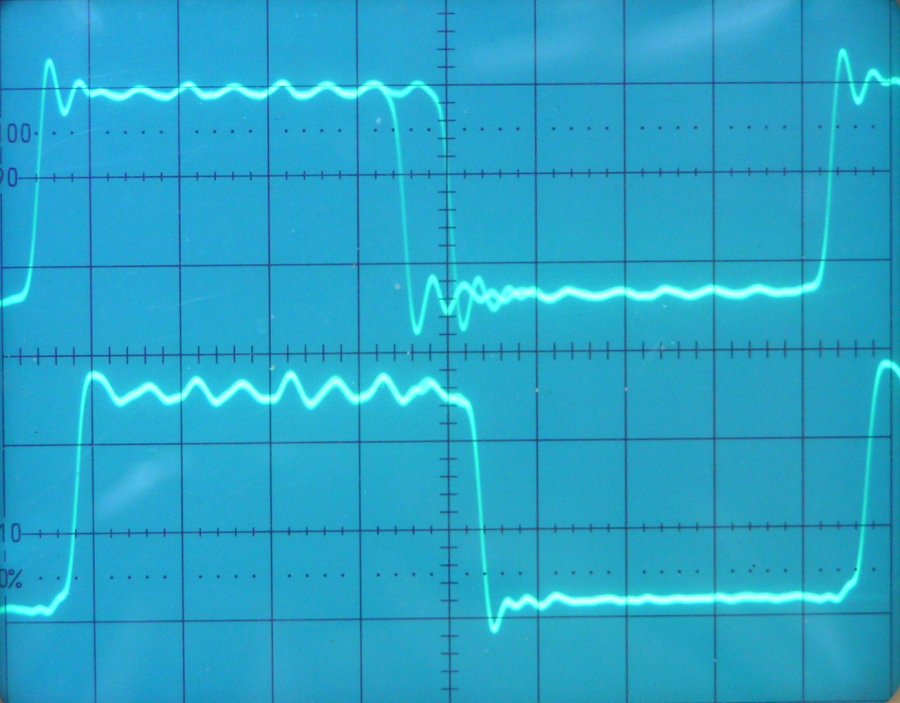

USB / I2S interface optimized
Hi all,
As just noted, I was planning to trigger a digital one-shot circuit on the leading edge of the reclocked BCK signal in order to get rid of the nasty looking trailing edge, well it's already working. The result is a semi-asynchronous reclocked BCK signal that has very low jitter, looks fany on the oscillogram and produces exactly the same sound quality as with the direct I2S output from my CD-changer. Good enough?
The digital one-shot circuit consists of a D-flipflop that is triggered on the leading edge of the already reclocked BCK signal, then it is reset after 7 clock pulses (derived from a synchronous counter). Out comes the clean BCK signal as can be seen at the lower trace of the added oscillogram. The upper trace shows the reclocked signal before trailing edge correction.
A nice detail is that the USB cable is about 8 meters long and the whole USB/I2S interface is powered by USB (no adapter necessary), sound quality is the same when using different computers.

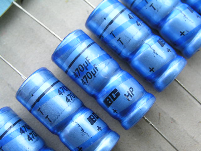

hi maxlorenz,
do u means where is the location of my chips come from.
some was china, mainly was taiwan.
mainly my 1541a chips was from philips hong kong. around 1998, philips hong kong will close some of dept & move to china. repair stock parts sold to public in good price.
my 1541a was taken that time. some of other parts such as BC caps & other parts were sold to two old couple. THis two old couple always go to large company to use good price to buy the remainstock & resell. This recent days I met them & ask for the old stock of philips parts. They told me that still had some, so I went back to their store 7 check. The most suitable for me was BC caps 40V 470uf. it means every my coming dac need 32pcs per dac. But will really very good for this caps. All caps was made in Holland.
my uncle was one of brand name computor monther board producer. His purchasing dept help me lot for chasing for chips & price not bad.
thx
thomas
