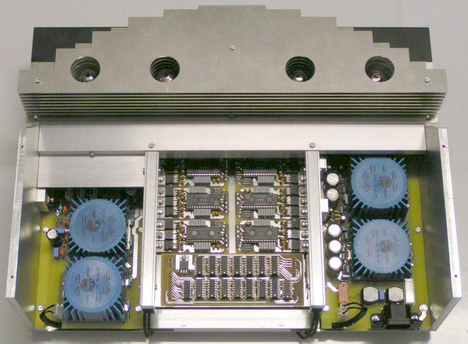

Today I rewired the octal D-I DAC, using high quality screened wire for both the I/V signals and analog output signals. Aluminum cable ducts and addittional screening was added, only few cables remain visible now. The mains connection between both power supplies also runs trough a aluminum cable duct.
I added a photograph of the octal D-I DAC. I am planning to annodize all interior parts and the tube grille using a gold colour.

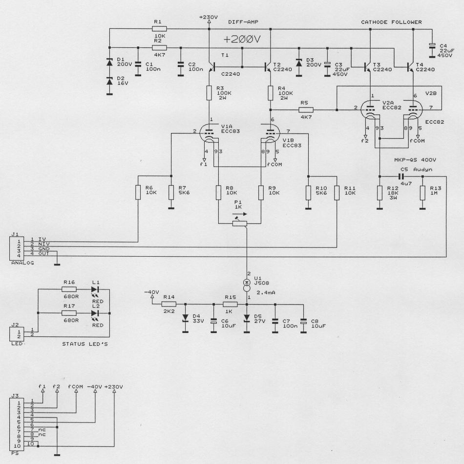

Hi -ecdesigns-,
So I would be correct to say that your tube output stage now utilises 1x ECC83 and 2x ECC82?
I just found it interesting that you chose the ECC82 as that is not exactly a very 'fashionable' tube. But I think it is a good choice not only due to the reasons you mentioned but another very important one - cost.

Hi adhoc,
Thanks for your reply [post#705]
> Yes, you are correct, the tube output stage uses a ECC83 and a ECC82. I promised it anyhow, so I added the new tube amplifier schematics. The 230V preregulated annode voltage enters a shunt stabilizer (R1, D1 and D2), then it is regulated again in a second shunt stabilizer (R2 and D3). This stable reference voltage is used for the annode voltage stabilizers (T1...T4). Due to this setup, hum levels are exeptionally low.
The differential amplifier (V1a and V1b) get's it's bias current from U1, a 2.4mA current source. This current source get's a stable voltage from a cascaded shunt regulator (R14, D4 and R15,D5). I/V output stage voltage is attenuated by R6 / R7 and R11 / R10. Gain is set by R8 and R9, P1 is used to balance the differential amplifier (same DC voltage on both pin 1 and pin 6 of V1).
The cathode follower (V2a and V2b) consists of two triodes in parallell, R5 is a grid stopper. R12 is dimensioned to allow for a high amplitude output signal. C5 is a high quality polypropylene capacitor from Audyn.
The LED's L1 and L2 are status LED's placed directly under the two tubes, mounted in the centre of the tube socket. These LED's are driven with a 0.5 Hz sinewave from a small microcontroller during power-up, and remain lit when the amplifier is operational.
The filament voltage is 12.6V (2 X 6.3V) as pin 9 is not connected, both filaments of each tube are connected in series. The stabilized filament voltage (-12.6V) is generated by the tube power supply, the fCOM is connected to ground, f1 and f2 are connected to -12.6V. During power-up a 18 Ohm resistor limits filament current for all 4 tubes, after gradually heating-up the voltage across the filaments rises due to the increasing filament resistance. Then when the filament voltage exeeds a treshold voltage, a FET shorts the resistor, applying full 12.6V to the filaments, at this moment the annode voltage is switched-on as well. When the tube stage is switched-on while the filaments are still hot, power-up time is much shorter as the treshold is now exeeded much sooner.
As noted before, I use the mixed mode (both op-amp and tube output signals mixed together) exclusively. At the moment I use a 680 ohm resistor between ground and the cinch output, the tube amplifier signal is connected trough a 3.9 KOhm resistor, the op-amp signal trough a 1.8 KOhm resistor. This "mixing" ratio was determined after many hours of listening tests and creates a subtle balance between both signals. Due to the attenuation of both signals, noise levels are reduced to a very low value.

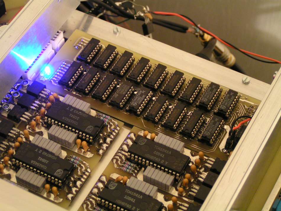

What have I been doing? I just completed the autodetecting dual format timing chain. It has the same dimensions as the old timing chain, yes I managed to get the 3 shiftregister WS timing-chain working. It can detect both Philips and Sony format, then it automatically enables or disables the format converter, configures all tap's and inverts the necessary clock signals. Detecting goes extremely fast, it only needs half a WS cycle. Two LED's indicate the detected format.
The housing is almost finished, the rear panel had to wait for a second problem to be solved. The differential I2S input switch (4 differential I2S channels) and connectors to be used. As you may have read, I tested very fast emitter coupled differential transmitters and receivers. They work very well, meaning almost no added jitter across the I2S interlink, so all I need for the I2S interface is BCK, DATA and WS. The I2S input switch module is almost ready, it uses very fast multiplexers and emitter coupled differential receivers. The chip's used are SMD versions. Channel selection is binary (S0 and S1)
Tomorrow the USB module has to be tested, basically it's the PCM2706 chip with a differential I2S output (emitter coupled logic). I plan to design a very small module that can be directly plugged in the computers USB socket and has a (long) cable that connects to one of the DAC's I2S input's. The most important thing is to obtain exactly the same sound quality with the USB interface as with the reference CD changer.
I added a photograph of the autodetecting timing-chain in action.
