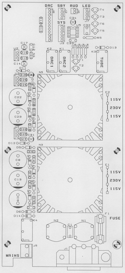

Main power supply silkscreen plot
Hi all,
I added a main power supply silkscreen plot.
Mains socket is at the bottom right of the circuit board. A fuse protects both power supplies. Both transformers are sealed torroid types (Nuvotem-Talema) of 25VA (N3) and 15VA (N5). Mains voltage selection is on the right of both transformers, for 230Vac the 230V jumper has to be soldered, for 115Vac, both 115V jumpers have to be soldered, the 230V jumper is removed. J5 routes the switched mains voltage to the tube power supply, a gap is provided in the circuit board to allow this cable to be routed trough a aluminum cable duct. Connections are on top, DAC are the DAC output voltages: -8V, +8V, -20V and +20V. SBY is the +8V stand-by and auxilary voltage, SYS is connected to the system controller, AUD is the tube operational switch signal and LED is the connector for the status LED's. This power supply is placed at the left-hand side of the octal D-I DAC when viewed from the front. U2,3,4 need some minor cooling, it's provided by a small heatsink. When the differential tube output is not used, components necessary for this part can be left out (C32..34, D14, J5...J7, K4, R3...5, T2...T6, U5).

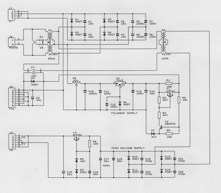

Tube power supply schematics
Hi all,
Next is the tube power supply schematics.
When the main power supply applies the mains voltage to the tube power supply, transformer N1 get's power. The ac voltage is rectified and split up in 2 voltages, +20V and -20V, but the +20V is connected to ground. So on the annodes of D2 and D4 we get about -40V, this voltage is used for the current source in the differential tube stage. The transformers centre tap now carries -20V with respect to ground, this voltage is applied to a negative voltage regulator for the filament voltage (U1), with the diode connected to common, approx. -12.6V filament voltage with respect to ground is obtained.
The filaments of the ECC82 / ECC83 use the internal series connection, so they run on 2 X 6.3V = 12.6V. However, R1 drastically limits the filament current, so the voltage across the filaments starts rising slowly. This is caused by the fact that a cold filament has a much lower resistance than a heated filament. When the filament slowly heat's up, the voltage at some time exeeds the reference voltage set by the zenerdiode D7. Now T2 starts conducting and pulls the gate of N-channel mosfet T1 to the plus (ground), T1 short circuits R1 (low RDSon) and the pre-heated filaments now receive the full 12.6V. But now the voltage is also high enough to trigger relay K1 (12V relay), K1 in turn connects the secundary winding of N1 (2 X 18Vac) to the secundary winding of N2, with this setup N2 now boosts the 2 X 18Vac to approx. 220Vac. This voltage is rectified and then pre-stabilized by the high-voltage mosfet T3 to approx. 220V.
This way a smooth sequential power-up of both the filament supply and the HV supply is ensured, and only two standard encapsulated torroid transformers are needed to run both tube output modules.
The output voltages for both filaments and HV are very smooth, avoiding hum.

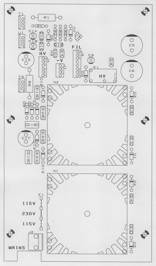

Tube power supply silkscreen plot
Hi all,
I added the tube power supply silkscreen plot.
Mains voltage enters J2 at the bottom left of the circuit board. Both transformers are sealed torroid types (Nuvotem-Talema) of 25VA (N1) and 15VA (N2). Mains voltage selection is on the left of N1, for 230Vac the 230V jumper has to be soldered, for 115Vac, both 115V jumpers have to be soldered, the 230V jumper is removed. Connections are on top, HV is the +220V supply, -V is the -40V supply for the current source and FIL carries the -12.6V filament voltage. This power supply is placed at the right-hand side of the octal D-I DAC when viewed from the front. U1 needs sufficient cooling and is mounted to the right-hand side aluminum side panel, together with T1 and T3. Just like the main power supply, the tube power supply is mounted on 2 massive aluminum bars using 3 screws on each side. Transformers are firmly fixed to the printed circuit board using M4 screws at the centre.

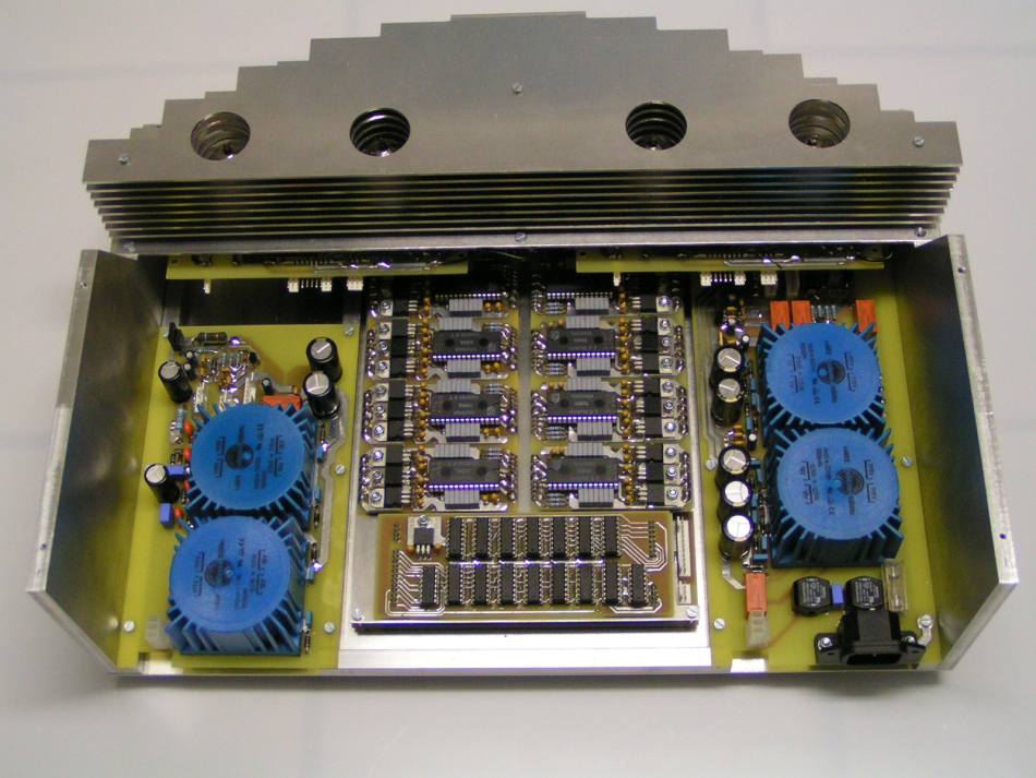

Today the octal D-I DAC migrated from the breadboard setup to the new aluminum housing. After some troubles with the main power supply module, everything is working perfectly now. I will post some more pictures later.

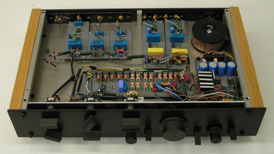

I added a photograph of this "oldtimer", one printed circuit board was removed to install a different op-amp. All printed circuit boards are double sided and sprayed with a grey primer. Only one channel is visible, the other channel is mounted at the other side for optimal channel separation. The coils are reed relays, I made them myself. I used coil formers from philips coils and put a new winding on them, I removed the ferrite core and inserted a reed contact. As you can see, I was already using modular setup's 20 years ago. The wooden side panels are of massive oak of course. I also made all chassis parts and knobs myself.
