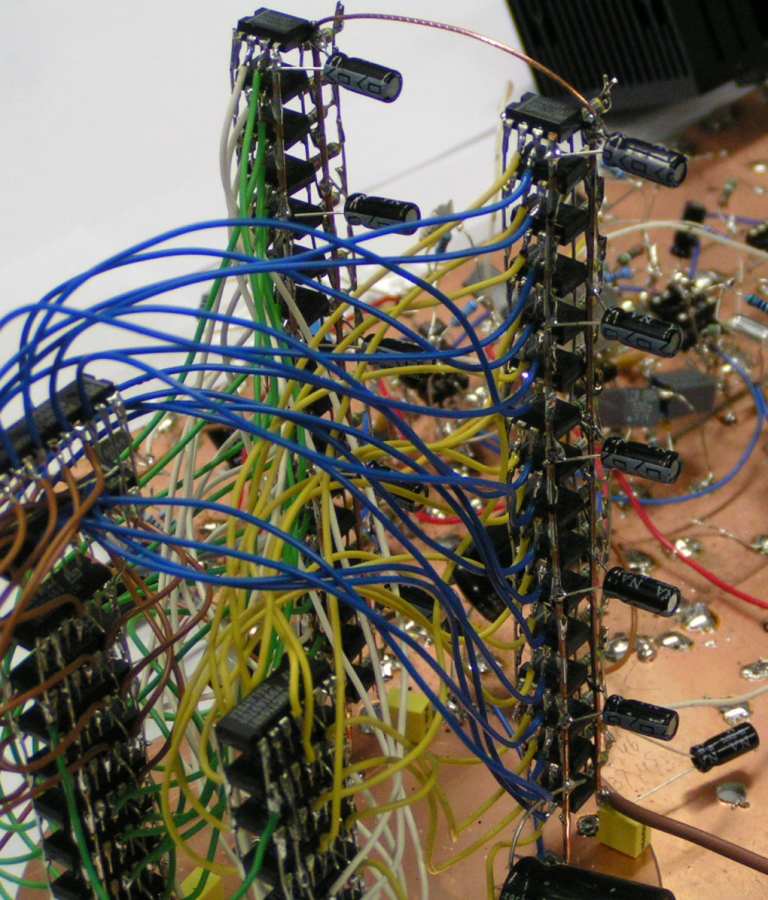

32 X TDA1543 D-I DAC photograph

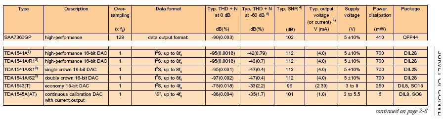

Then about the TDA1541A DAC chip's quality.
When combining all information gathered, philips datasheets included, TDA1541A spec's would be as follows:
N2/S2 (double crown) specification: bit 1-7 Edl < 0.5 LSB, bit 8-15 Edl < 1 LSB, bit 16 Edl < 0.75 LSB THD -95dB
N2/S1 (single crown) specification: bit 1-7 Edl < 0.5 LSB, bit 8-15 Edl < 1 LSB, bit 16 Edl < 0.75 LSB THD -97dB
N2 specification: bit 1-16 Edl < 1 LSB
N2/R1 specification: bit 1-16 Edl < 2 LSB
When parallelling DAC's, both noise and distortion can be reduced. Then performance is already very good without using the S1 version.
I am still not sure what the spec's of my TDA1541A DAC chip's are. According to the Philips TDA1541A datasheet it has N2 specifications (<1LSB) because there is no S1 or R1 indication. So if I am correct, the octal D-I DAC uses <1LSB types.
I added a photograph of the 32 X TDA1543 D-I DAC test setup. The 32 TDA1543's draw about 1.29A at 7V.

Looking at your published spec for the S1 and S2, there is no difference except for THD, with S1 having slightly better figure. Isn't that contradictory?
That's some setup for the TDA1543 DAC. I'm surprised you didn't get one of the wires mixed up.

Re: 32 X TDA1543 D-I DAC photograph
That is a gorgeous piece of industrial art 🙂
dave
-ecdesigns- said:I added a photograph of the 32 X TDA1543 D-I DAC test setup. The 32 TDA1543's draw about 1.29A at 7V. [/B]
dave
A 1541 classification too: (scroll down)
http://www.tnt-audio.com/clinica/tnt1541_e.html
Could be the same but i want to show anyway. The "A" version has <1 LSB accuracy, for better specs get S1 or S2, but i think this is not neccesary within the D-I setup.

Awesome, that pile of 1543's...... take a good look, somewhere in it must be a rollercoaster turning its rounds.....

> No I didn't mix up any wires, during prototyping I must work very accurate and concentrated, one little mistake can cost many hours of troubleshooting, or can destroy the setup within seconds. When I switched-on the prototype setup worked straight away, I just had to finetune the I/V converters for optimal performance.
It shows that the D-I technique still works accurate with many DAC chip's. The maximum would be 64 (philips format, taps 0...63). It also shows de octal D-I DAC is still a NOS DAC, as the actual sampling rate is not increased. The TDA1543 would not work with 32 or 64 times oversampling.

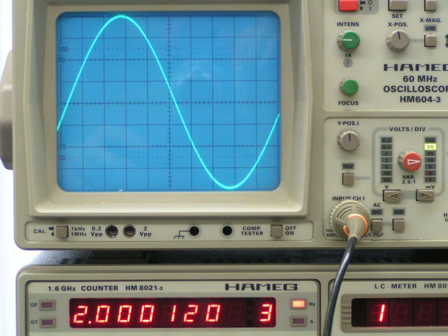

I added a oscillogram of a 2 KHz sinewave, output by the 32 X TDA1543 D-I DAC without filter, to give an impression of the obtained resolution

I did some measurements yesterday on both the 32 X TDA1543 D-I DAC and the 8 X TDA1541A D-I DAC. 0dB sinewave signals resulted in 7.5Vpp for 16 X TDA1543, I/V resistor across op-amp is 202 Ohm, so the full scale DAC current is (7.5 / 202)/16 = 2.3mA, that is the typical full scale current of one TDA1543.
The octal D-I DAC measured 9.5V for 4 X TDA1541A with a 0dB sinewave signal, I/V resistor across op-amp is 590 Ohm, so the full scale current here is (9.5 / 590)/4 = 4mA, again a typical full scale current of the TDA1541A.
So according to these measurements, both D-I DAC setups seem to perform similar to the same amount of parallelled DAC's. The differential op-amp and tube output stage double the output amplitude, as one DAC group has a inverted audio signal (serial data is inverted). So we have (+v1) and (-v2), these are now summed, +v1 goes to the op-amp NON-inverting input, producing +v1 at the output, -v2 enters the op-amp INVERTING input and produces - * (-v2) = +v2 at the output. So the total output amplitude is v1 + v2.
Hi MGH,
Thanks for your reply [post#652]
> Printed circuit boards now have to be RoHS compliant, so options are limited. If you want a circuit board that can be soldered with both lead-free and leaded soldering tin, the best option to use is gold-plated pad's. Cost is increased 10% by using gold plated pad's.
> The balanced DAC design is mainly used to create a fully DC coupled output without capacitors or transformers as they can affect sound quality. A wire still has the lowest distortion. When the DC coupled output is created, it is applied to a single ended RCA connector.
PCM56
Hi Bernhard,
Thanks for your reply [post#653]
The PCM56 cost about 13...16 euro's each, so when it's performance prooves to be equal or better than the double crown TDA1541A during listening sessions, it's a good alternative. The PCM56 uses a resistive ladder network for D/A conversion. Problems occur especcialy at the 011...11 to 100..00 changeover, the datasheet also includes a deglitcher circuit, so problems of this nature are already expected.
The TDA1541A however uses a technique to avoid these errors. The linearity errors are a different aspect. You mentioned the TDA1541A used in a NOS setup produces a sound that's too warm. What type of output circuit was used?
The octal D-I DAC setup is modular, so modules for the PCM56 or other suitable DAC chip's could be designed as well.
Hi Bernhard,
