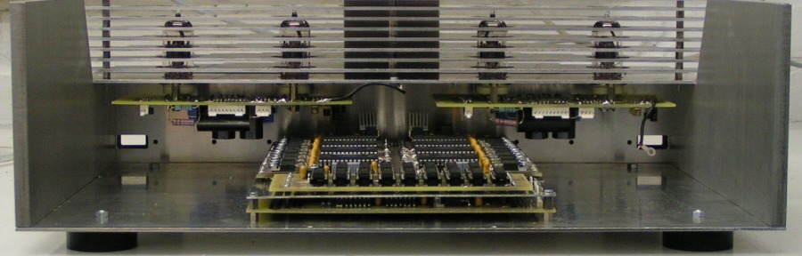

Hi all,
After all the electronics, something completely different, the octal D-I DAC housing.
I will post some more pictures of the octal D-I DAC housing later. This is the first one, it shows the massive 8mm thick aluminum sidepanels, the bottom plate and the keyboard / indicator frame. At the center, the analog mainboard with a thin aluminum screen plate already fitted. It is placed between both the analog mainboard and the modules. On top of the screen plate is a thin polyester foil for insulation. The 4 round feet are made of acetal copolymer, with a embedded 3mm thick neoprene rubber disc to avoid scrathes.
All parts, polyester foil included were manufactured using a CNC milling machine.

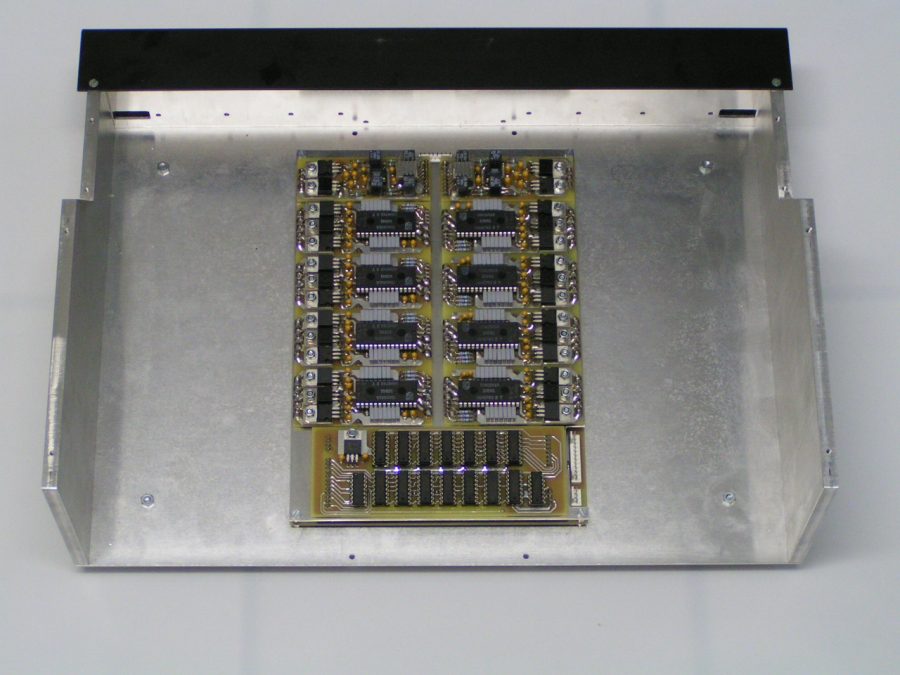

Hi all,
Picture 2 of the octal D-I DAC housing.
Here the modules have been placed, as indicated, a thin polyester foil will prevent possible short circuits. The screen plate is used for addittional interference reduction. The massive aluminum side pannels are the base of the entire housing, all plates are attached to them using M3 screws. The M3 thread is tapped into the aluminum sidepanels. The aluminum parts are annodized later for a professional finish.

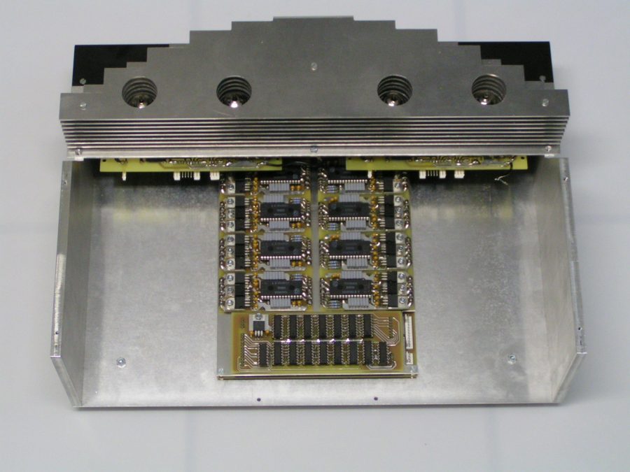

Hi all,
Picture 3 of the octal D-I DAC housing.
The tube output frame is put into position, special care had to be taken to ensure there was enough clearance between both the analog mainboard and the tube output stage circuit boards. Also the I/V stage outputs had to be located close to the tube output stage, to avoid hum. The entire tube output module can be taken out, by just removing 4 M3 screws, and pulling some connectors. The grid plates are mounted using 5mm spacers. The entire grid can be taken off by removing 3 screws. The tubes can be changed either with a special tube pulling tool (similar to the tools used to remove pilot lamps from switches), or by removing the protective grid first. Power supplies will be placed on two sub-chassis, both left and right from the analog mainboard.

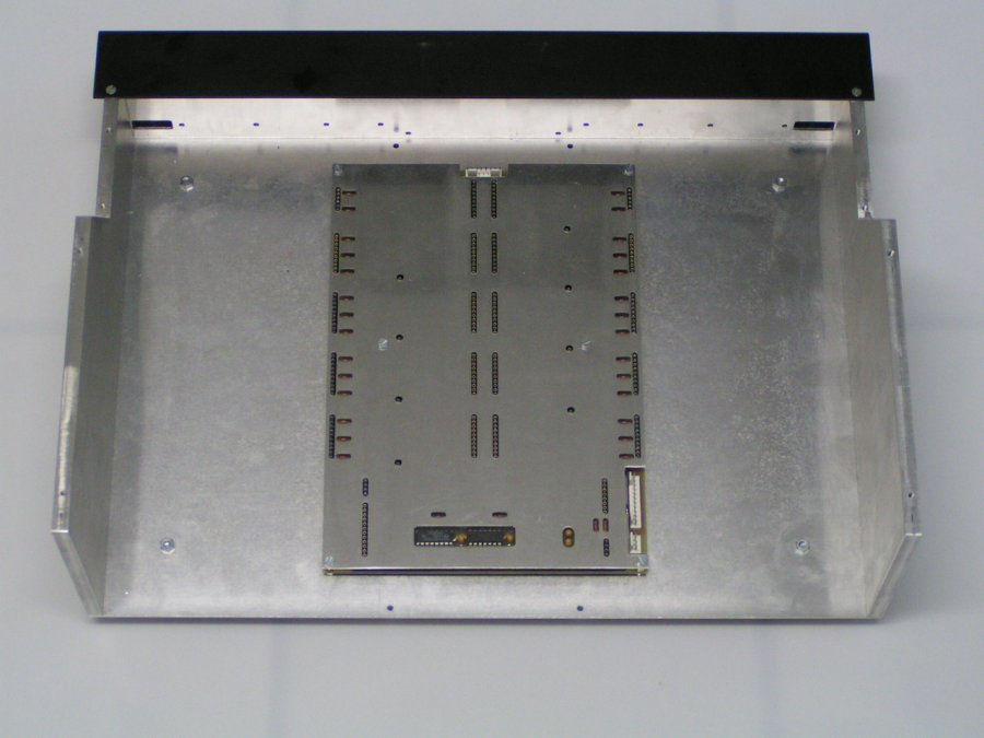

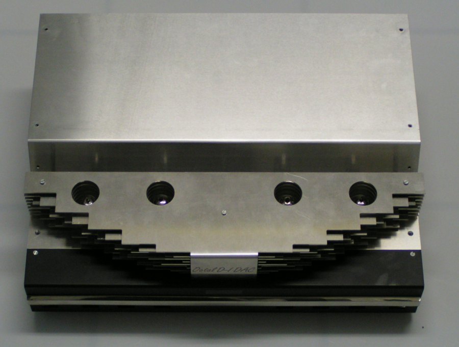

Hi all,
Picture 4 of the octal D-I DAC housing.
A front view, notice the sloped cover, I had to bend it myself. All screws will be hexagonal countersunk types. I am planning to annodize the entire housing black, exept for the protective grid. The grid will be annodized natural (aluminum color), so it stand's out. Other colour combinations are possible though, perhaps annodized gold colour for the protective grid would look nice too. The shiny bar on the front panel is 5mm thick massive stainless steel, polished to high gloss.

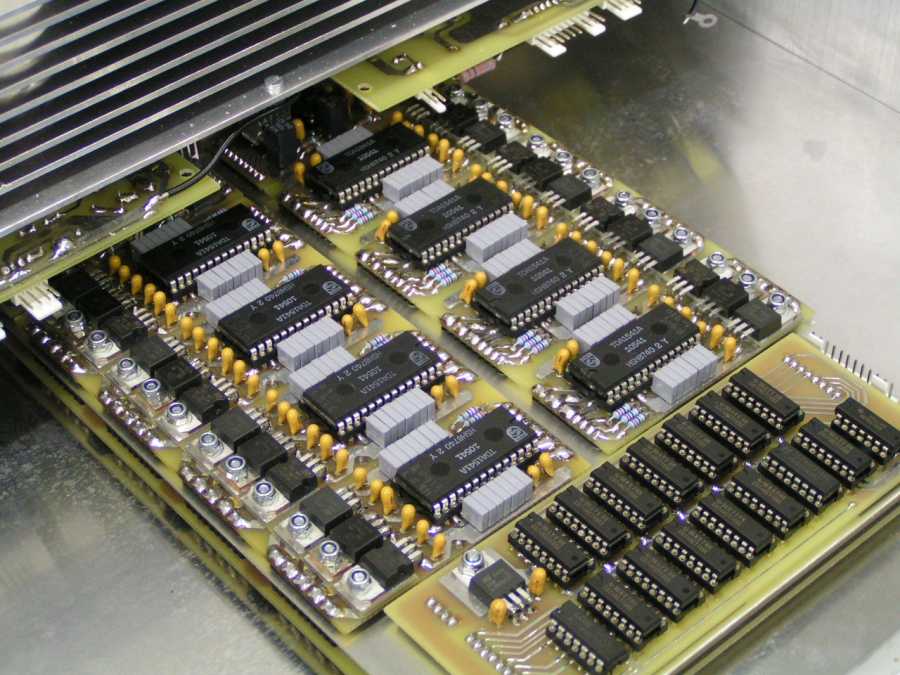

Hi all,
Picture 5 of the octal D-I DAC housing.
Rear view of the housing, now the position of both tube output modules and analog mainboard can be seen. The rectangular holes at the left and the right of the keyboard / indicator panel are used for routing wires. At the moment I use a combination of both a power metal film and a carbon resistor for the cathode follower resistors.
To answer NjoyTHEMUSIC's question, yes the 3 regulators located at each DAC chip are dedicated for that chip only. The 3 pin regulators have been selected for close tolerance. This technique is used troughout the entire octal D-I DAC design, each chip basically has it's own separate power supply. These supplies are thouroughly decoupled on the analog mainboard. So crosstalk between power supplies is very low. The regulators are also placed very close to the chip's.
Hi tubee,
Thanks for your reply [post#611]
The I/V op-amp needs to be very fast (short settling time) the OPA2132 isn't fast enough for this particular application. So your conclusion is correct. Now I use a faster AD823 (Dual) that works much better. But as already noted, I saw another interesting OP-amp for I/V conversion on this site, the Linear Technology LT1469. So the op-amp specifications for the I/V stage differ considerably from the one used in the diff-amp. However, the OPA627 seems to work very well for I/V conversion too. But the LT1496 could proove to be a better choise. Discrete setups are sometimes less accurate (linearity) and have problems with stability (drift). I already tried some of them, but still prefer a high quality OP-amp.
note that I currently use the OPA627 for I/V conversion in the octal D-I DAC and the AD823 in the 16 X TDA1543 D-I setup.
I added a close-up of the analog mainboard,

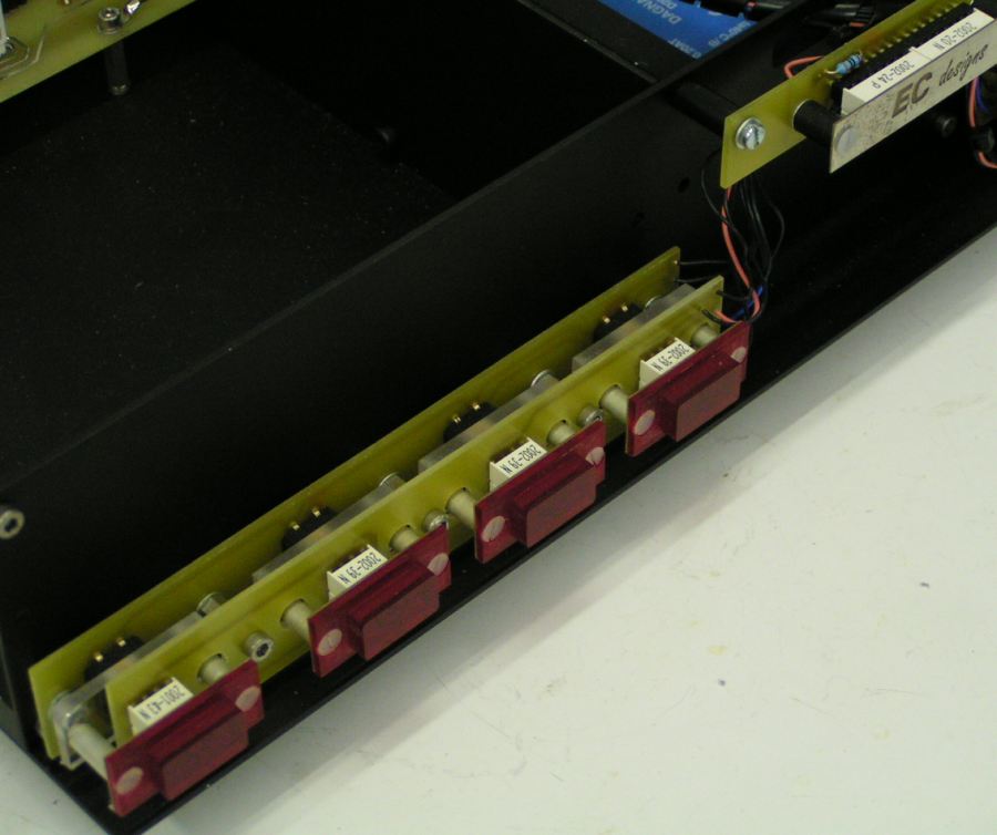

Hi all,
Next picture shows a close-up of the self made keys with backlit symbols. The rear PCB holds the actual short travel switches. They are mechanically connected to the CNC machined red transparent Plexiglass keys, using a polycarbonate frame, two aluminum spacers and countersunk M3 nylon screws . In between there is a second fixed PCB holding the LED blocks for backlighting. This way symbols can be perfectly illuminated trough the moving keys. Oh yes, the symbols are etched in a 1mm thick printed circuit board, the copper block's off the light, and the etched pattern becomes visible. The EC designs logo on the right is made in a similar way. I tinned it to prevent oxidation. The keys will fit in the rectangular holes of the front cover.
This setup will also be used for the octal D-I DAC, the system controller module will probably be mounted on this chassis as well. This way it's located in a Farraday's cage to avoid interference from the microcontroller.

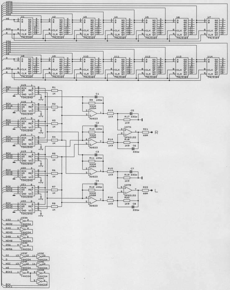

TDA1543 octal D-I DAC schematics
Hi tubee,
Thanks for your reply [post#616]
Well I used the OP-amps this way (see added schematic diagram). It's a rough setup for a single board octal D-I DAC using the TDA1543. The timing chain has plenty of taps to build a 16, 32 or 64 D-I DAC using the TDA1543. The setup is balanced / DC coupled since output capacitors are too expensive 😀 . Decoupling cap's can be added between each AD823 NON-inverting input (reference) and ground.
Enjoy.
DC-coupled, yes!
This looks good, no coupling cap.
Is I2S reclocked and made differential? (WS & WSI)
Don't show those inverters to a specific diy member. John, you'll get comments about it.:smash:
Btw is the 74LS164 fast enough? I use the HC164.
