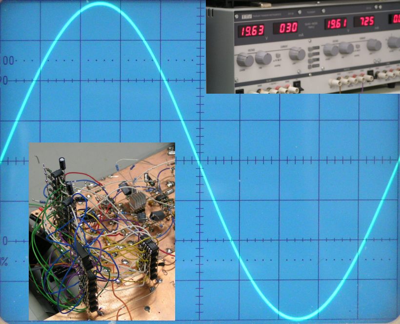

exploring the limits
Hi all,
Project update,
In order to explore the limits of the Direct Interpolation technique, I have setup a 16 DAC version using the sony format. Taps on 3BCK multiples...using the TDA1543. The TDA1543 is specified for 4 times oversampling. Now it's running at a virtual sample rate of 705.6KHz comparable to 16 times oversampling! (so the sample rate is virtual, otherwise the TDA1543 wouldn't work), and a 20 bit theoretical resolution. I am pretty sure it will also run on 1.4112 MHz virtual sample rate / 21 bit theoretical resolution (32 DAC's comparable to 32 times oversampling). What about the TDA1543 reference pin? seems it musn't be connected directly as high frequency interference occurs. So I connected a 1 KOhm series resistor between each reference pin and the summing point (reference for the I/V converter). This also caused a significant drop in power consumption. 16 DAC's running at 7.5V only need around 750mA. Power consumption is down to 5.6W (0.35W / chip). The I/V OP-amp resistor had to be lowered to 360 Ohms. The setup is differential, so the output is fully DC coupled / no output capacitor needed. Oh yes, I used cheap OPA2132 op-amps.
Somehow I get the feeling this is no oversampling since the TDA1543 can't run at 16 times oversampling. So it looks like both the octal D-I DAC and the 16 DAC version are NOS DAC's afterall.
They meet the NOS DAC criteria, NON oversampling 44.1 KHz sample rate and filterless. But it has such high resolution, that the problems associated with NOS DAC's are practically non existent with this setup. It also has true phase linearity, very important for natural sound reproduction. The low 705.6 KHz residu is no longer a problem for both power amplifier and tweeters. High frequencies are reproduced crystal clear now.
The output signal looks very smooth on the oscilloscope, even with high frequencies. Frequency sweeps from 20Hz to 20KHz sound ok. The sound quality, despite the (economy version) TDA1543 DAC chip's, is very smooth and relaxing, crystal clear and open, it's doesn't sound like a digital system anymore.
So now it appears a very cheap D-I DAC can be constructed, using 8 or 16 DAC chip's that could fit on a euro sized board, timing chain, I/V conversion, diff amp and power supply regulators included that is. Both a philips and a sony version could be made, so it can be directly connected to a CDPRO2 using I2S.
Hi all,
Project update,

I added a photograph of the messy prototype setup, it's clean unfiltered 1.25 KHz sinewave 564 sample point output, and a view of the power supply to give a indication of power consumption of the complete 16 DAC setup.
