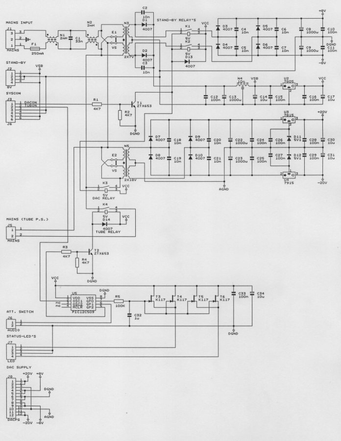

Hi all,
Project update,
Currently the octal D-I DAC power supplies are being developed. There will be 2 separate power supply modules, the main power supply for the DAC and the separate tube power supply. The main power supply also provides the stand-by supply by using a addittional rectifier. The main power supply generates the following (pre-regulated) voltages:
-10V, +10V, -25V, +25V and +10V stand-by voltage
It also includes a small microcontroller (PIC12F629) in a DIP8 package (similar to the TDA1543) with a on-chip oscillator (no crystal needed). It will drive the 4 LED tube status indicator's (2 Hz sinewave pattern during warming-up). It also controlls the tube power supply start-up and shut-down sequence for both filament and HV using PWM output's and relay output's. A input pin is provided for shutting-down the tube stage (op-amp mode only).
Relay's are used to shut down the main supply in stand-by mode.
The tube power supply provides the stabilized filament DC voltage, the -50V for the current sources and the stabilized 250V HV. Both HV and filament supplies have separate relay's for sequential power-up / power-down. In addittion PWM signal from the microcontroller ensure correct soft-start operation for both, the filament and HV supply.
Both power supply modules are mounted on massive 1 x 1 cm aluminum bar's that support the circuit board's on both sides for optimal mechanical strength. Neoprene rubber strips are placed between circuit board and the aluminum bar's for suppressing mechanical noise (transformer hum and relay switching sound's)

Re: PCM56
The PCM56 works very good without deglitcher.

Great work, ecdesigns,
Can I take the output from the balanced stage opamps directly to my transformer based volume control, DC coupled?
Will the + and - signal from each channel match exactly?

Hi MGH,
Thanks for your reply [post#663]
> Yes the printed circuit boards will have track's on both sides. I am not sure if only the pad's are gold plated or the track's as well. If the track's have to be gold plated anyway, a transparent anti solder mask would look nice.
> The output impedance of the octal D-I DAC using mixed mode is about 600 Ohms, however if necessary, it can be lowered. The main "problem" is the tube output stage, if I put a addittional buffer (opa627) after the mixed mode output (same happens already in my control amplifier), the output impedance can be much lower. In this case, the mixing ratio between tube and op-amp output signal has to be changed. I now use a very short interlink (40cm) between DAC and control amplifier, The average input impedance of my control amplifier is 40 KOhm. So the 50 KOhm input impedance of your stepped regulator should not be a problem.

I found a very interesting buffer for I2S signals, it's the NC7SZ125 from Fairchild. It has a very small 5 pin SMD housing with one single buffer, typical delay is 2.6nS, it can run on 5V as well. I already designed a adapter circuit board containing 3 of these buffers (14 pin DIP size). So it can be used in the existing timing chain, or as a modular high speed I2S buffer.
The mini clock upgrade circuit board has been modified too, it now has the NC7SZ125 integrated.
Both the program for the PIC12F629 and the printed circuit board design for the main power supply are ready. The tube status LED's are driven with a 0.5 Hz sinewave, produced by the microcontroller (PWM), this looks very impressive. The LED's pulsate slowly until the tube output stage is operational, then they switch-on and the tube output signal is added to the op-amp signal.
Yet another technique is used for limiting the filament inrush current, as the constant current sources used too much power. After switching-on the filament current is limited by a resistor, as the filaments start heating-up, the voltage across them increases. Now at a specific treshold, the resistor is bypassed by a mosfet switch, and the full 12.6V is applied to the filaments. At this moment the filament voltage suddenly increases, driving a 12V relay that switches-on HV as well. Due to power supply modifications, power consumption of the complete octal D-I DAC, including tube output stages is down to about 40W. Stand-by power is very low <1W.
As the TDA1541A's get quite hot with the current high temperatures over here at my place (32 degrees centigrade). I looked for IC heatsink's and found them at Farnell, they come in two versions, for 24 pin and 40 pin IC's. Both types can be used with the analog mainboard setup.
I also found a very interesting article about the Non-oversampling Digital filter-less DAC Concept (Ryohei Kusunoki) on the internet.
It notes jitter values for NOS DAC's should not exeed 173pS, and for a 8 times oversampling DAC jitter should not exeed 1.35pS!

Hi all,
Project update,
Both power supply circuit boards have been designed now. I added a schematic diagram of the main power supply. This supply is used for the DAC itself, the second power supply is used for the tube output modules.
The current setup consumes about 44W, this could be slightly lowered by some optimizing.
The mains enters trough a PCB mount socket and passes a double mains-filter. Voltage selection for both 115Vac and 230Vac is provided by means of wire bridges. Transformer N3 also serves as stand-by power supply (system controller interface provides remote control functions). When in stand-by mode, relays K1...k4 are switched-off. D1 and D2 now provide the stand-by voltage and feed the on-board power supply (U2) for both the small microcontroller (U5) and the 5V relay's. When the system controller switches DACON "high", relays K1...K3 are powered and switch-on the main DAC supply (output's on J8). High efficiancy (ZTX653) transistors are used to get full 5V power for the relays.
Both U3 and U4 are pre-regulators for the 15V supplies, 5.1V zenerdiode's are used to obtain approx. 20V.
When the tube output is selected as well (tube or mixed mode), by bringing TUBON "high", microcontroller U5 now switches-on relay K4 that feeds the mains voltage to the tube power supply. It simultaneously output's a PWM 0.5 Hz sinewave signal. This signal is used to drive the 4 tube indicator LED's. R5 and C32 smoothen the signal, and JFET's T3...T6 make sure the maximum voltage is applied to the LED's. Due to the sinewave shape, the LED's start pulsating slowly indicating the differential tube output is being powered-up. After the LED's have pulsated 20 times, they remain on, indicating the differential tube output is now operational, simultaneously a switch signal is generated to connect the tube output to the main output.
When deselecting mixed mode or tube mode, the 4 LED's are slowly turned-off, relay K4 interrupts power to the differential tube output and the switch output disconnects the tube output signal from the main output.
Note, the microcontroller U5 is changed to a PIC12F629 now.
Project update,
