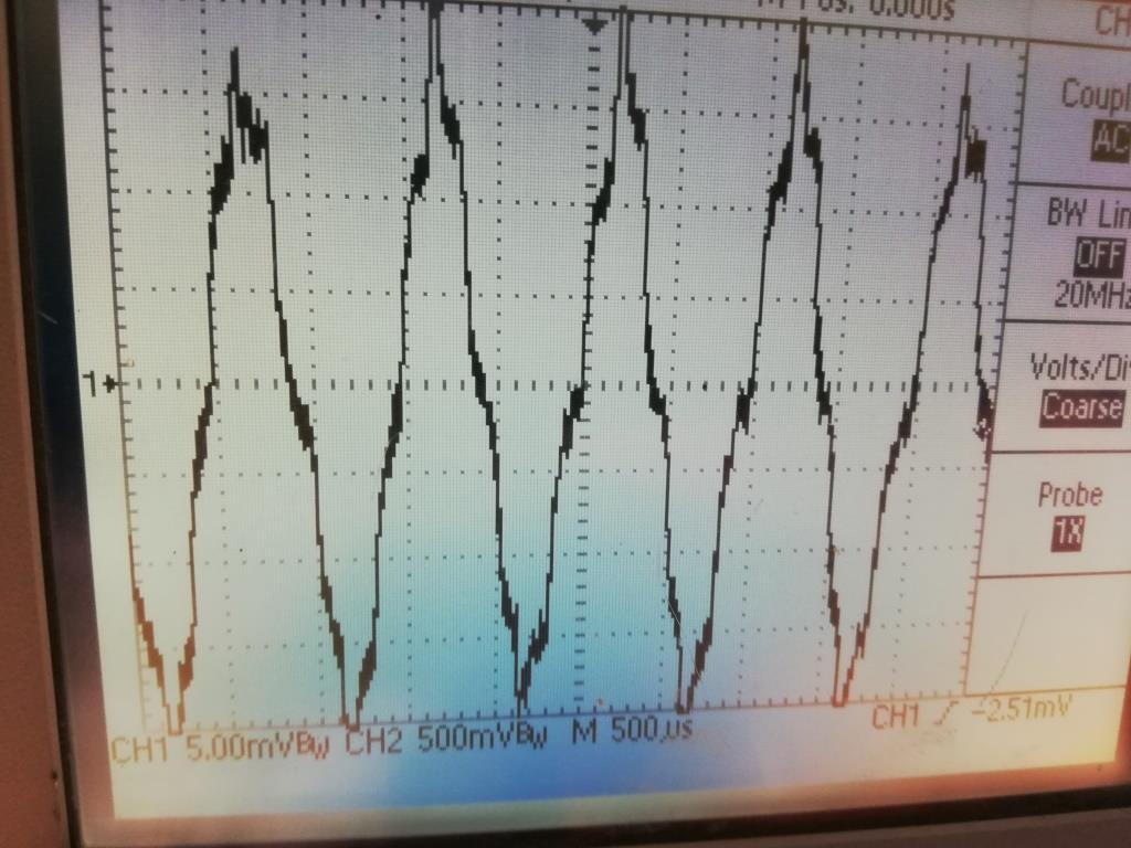

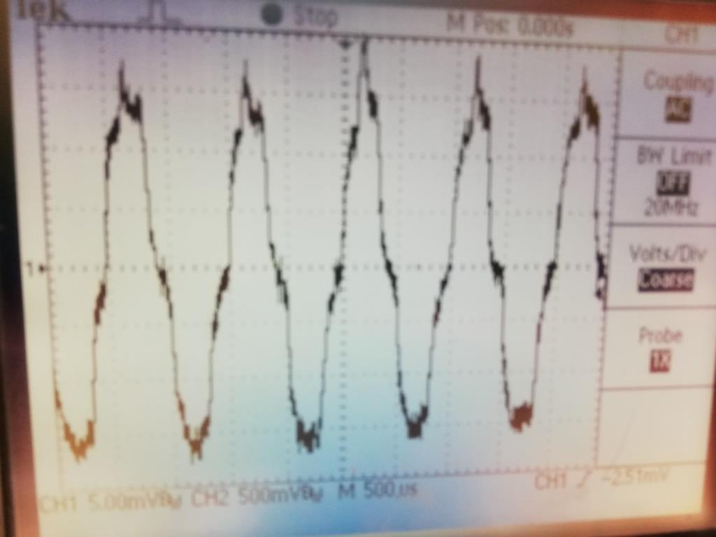

Pic 1 is 16 bit
Pic 2 is 24 bit
I think I need a -96,31 24bit file to see if bit 17 is resolved
By the way I fed the DAC with a -60dB signal an looked at it with the spectrumanalyzer software.
All harmonics are more than 40 dB down from that, so small signal behaviour is fine.
As it is a file that is repeated in Jriver, the 1 Khz dissapears for a moment, and of course the fundamental dissapears too, but the two "harmonics " @ 2 Khz and 3 Khz was still there without changing amplitude (-40 db from the fundamental);-) It must be spuriouses and the actual marmonics are much further down..
I could see on the scope, that the noise increased , when I connected the output from the x100 amp to the input of the soundcard even though the USB port that supplies the Wave IO USB to I2S had an USB isolator before it.

Now we have to do some calculation to understand your image.
The negative Dac goes from 0mA to 4ma while the positive Dac stays at 0mA.
The positive Dac goes from 0mA to 4mA, while the lower one stays at 4mA.
So output current goes from 0mA to 8mA.
When you have a 75Ohm resistor, output voltage is voltage is 600mV +/- 280mV and 1 bit means 560mV/2^16=8.5uV.
(I don't understand the 1k1 resistor, pulling the signal to 600mV in rest, but anyhow.)
On your scope I mean to see 8x 5mV is 40mVpk-pk,
Divided by your 100x amp, this means 40mV /100 = 400uVpk-pk, or almost 50 bits, which seems to correspond with your image, where I really see +/- some 20 levels up and down around zero.
1) With so many levels, signal should almost be impeccable and even better with 17bit.
2) What is not ok is that you get so many bits with this signal.
3) Also the zero crossing looks a bit strange and not sinus like.

Well I do not know what you are talking about when you are saying you see levels in my scope pictures? I can only see three + zero and - the rest is random noise...I don’t understand what you mean, but in fact this resistor is not all too important.

Why do you think you have +/-2mA instead of +/-4mA ?
And what are you using as an oscilloscope, how many bits ?
All the different steps I see are obviously not from your dac but from your scope.

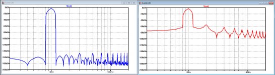

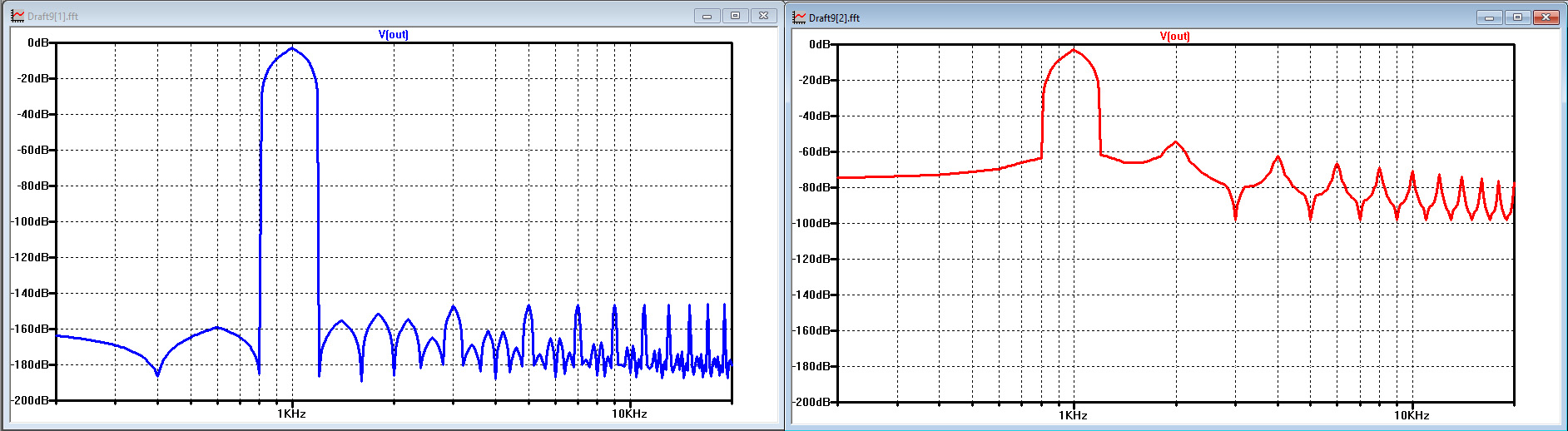

But in search of possible distortion I found something interesting.
I simulated a perfect 1 kHz Sinus composed of two halves.
Playing with the amplitude of one halve only changed the even harmonics, just as expected.
But then I realised that there is a possible time difference between both outputs of 0,2usec max according to the specs.
When shifting the lower halve with this time delay, the spectrum changes completely.
Only this super little delay has dramatic effects.
See below the spectrum at the left for two perfect halves, and at the right when these halves are shifted by 0.2usec.
I didn't pay further attention to simulating the same effect when using 16 or 17 bit resolution.
Hans

Very interesting Hans, with the timing between the two halves.
Interesting to see how the noise level also increases.
It is not I think, what happens in the DAC I am dealing with, as the noisefloor is below -110 Db . There is a lot of spuriouses, but the floor is not elevated.

I will do the same sim, but now with 44.1/16.Very interesting Hans, with the timing between the two halves.
Noise floor is dependant on the filter bin width, when you give me the length of the FFT and the sample rate you used, I will use these same figures.
Let's see how this works out.
Hans
Data Right is delayed 0,2 Usec vs Data Left because Data R goes through the 'Control & Timing' circuit that Data L doesn't at the input of TDA1541A.
