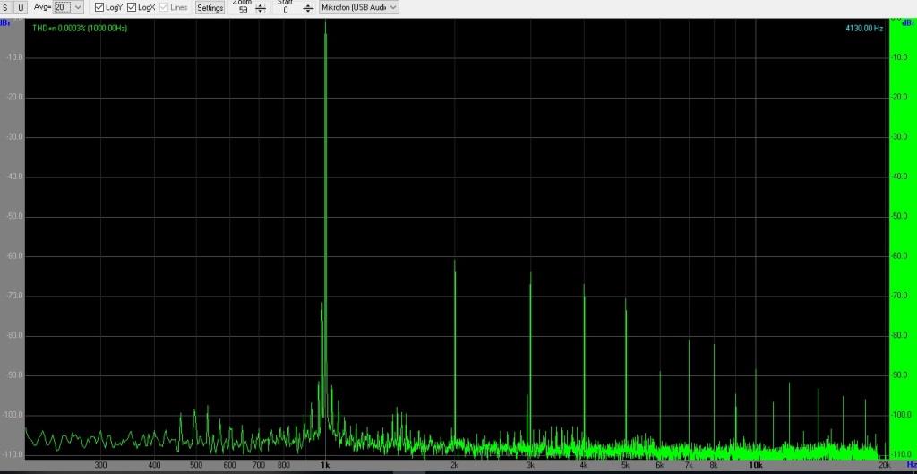

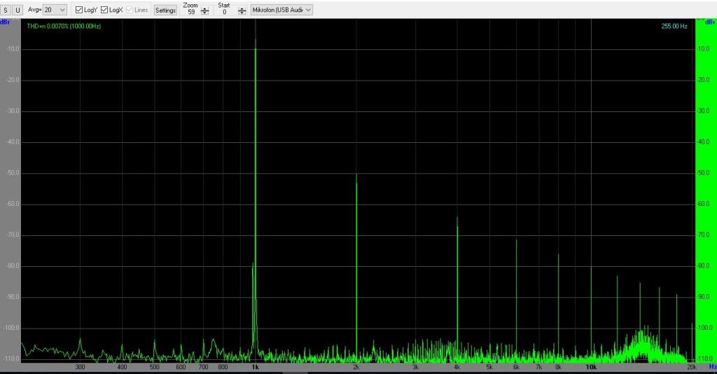

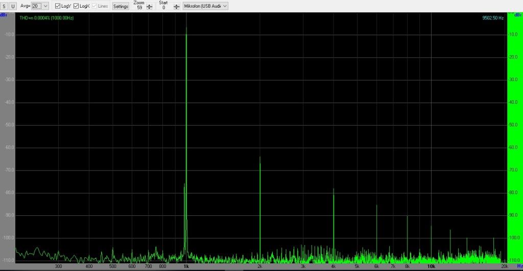

I changed my input soundcard to a Behringer UCA222. It has a little bit higher noise floor, but no spurious.
The two pics are FS and FS -6dB.
Signed Magnitude TDA1541A with 75 Ohm I/V resistor and about 1K45 to +6,28V Vcc.

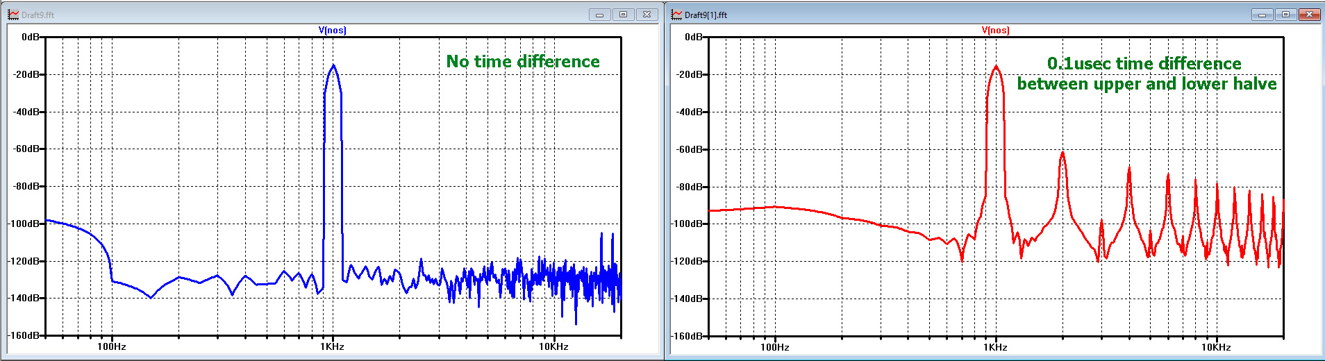

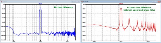

Here is the effect of a time shift between the upper and the lower halve after sampling and digitizing 44.1kHz/17.
Images below: left no time difference, right a 0.1usec shift.
Effect of such a small time shift is already quite dramatic as can be seen.
I used a time window of 20msec, giving 50Hz bins from the FFT.
Using a larger time window, will let the noise drop by the sqrt of the time window and make the "feet" of the harmonics much smaller.
Hans

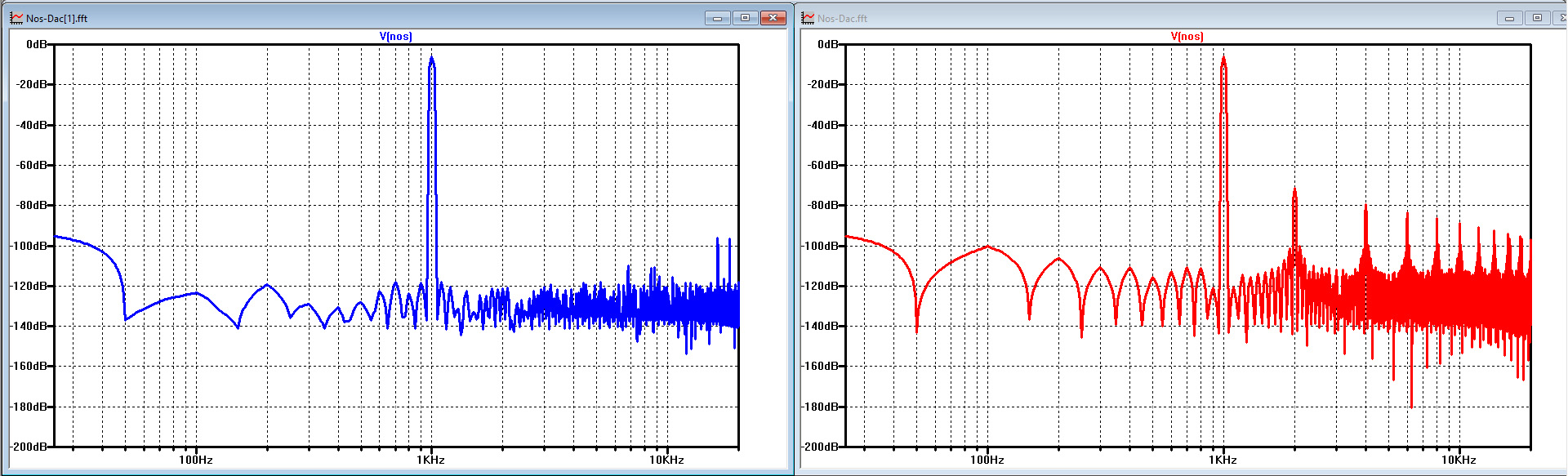

I extended the time window for simulation from 20m to 40msec, now showing more detail and I also corrected a small inaccuracy.
Now again the spectrum without time shift left, and for a time shift of 0.2usec at the right, taken with a 1kHz -6dB signal.
It corresponds remarkebly good with Koldbys -6dB spectrum in #7202.

Yes this could be the reason for this even order harmonic pattern. If it is an internal timing difference, then perhaps it is better to use the same side (right - left) DAC in two different TDA1541A , so you use one TDA1451A for the two positive halves (right and left) and the other TDA1541A for two negative halves (right and left)?
On another note. Like weissi say , this could actually be a spectrum from a DAC that sounded really good. The precense of only even order harmonics and the very linear decay of higher order harmonics is much what the air does to sound preassure. I am not at all sure that the spectrum SSerg is showing, would result in a better sound.

Hi Hans
Your simulation and my measurements along with Phillips data on TDA1541A seemed to point at a time difference between the two dac's inside the TDA1541A.
The strange thing is , that Phillips has no values for typ. and min. for the time difference between the two channels, only max. (0,2 us) . That could lead one to the conclusion , that there always was this timing difference between the channels, supported by the fact that the spectrum I measure is the same even if I switch the TDA1541A I am measuring.
So I thought to myself , if there is a consistent time difference between R and L dac, this problem could be solved by using two R dac's to convert the two halves of the R channel and two left dac's to convert the two halves of the left channel.
So I switched the DATA in so one TDA1541A recieved DOL+ and DOR+ and the other TDA1541A DOL- and DOR- . Then I took the I out from the two TDA1541A's R channels and combined them and the same for the two L channels.
Bingo that worked!
Unfortunately, the result is quite unconclusive, as the spectrum is almost identical to the FS -6dB , when using one TDA1541A to convert both halves. It is in fact a little worse, but still only even order harmonics.
What could be the next step?
