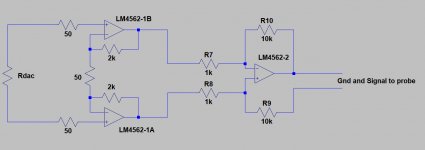

what's the real schematic of this dac's i/v stage?what's the schematic of lm4562 amp?Is that a classic i/v amp?Is that a buffer for a resistor as a load for iout dac?

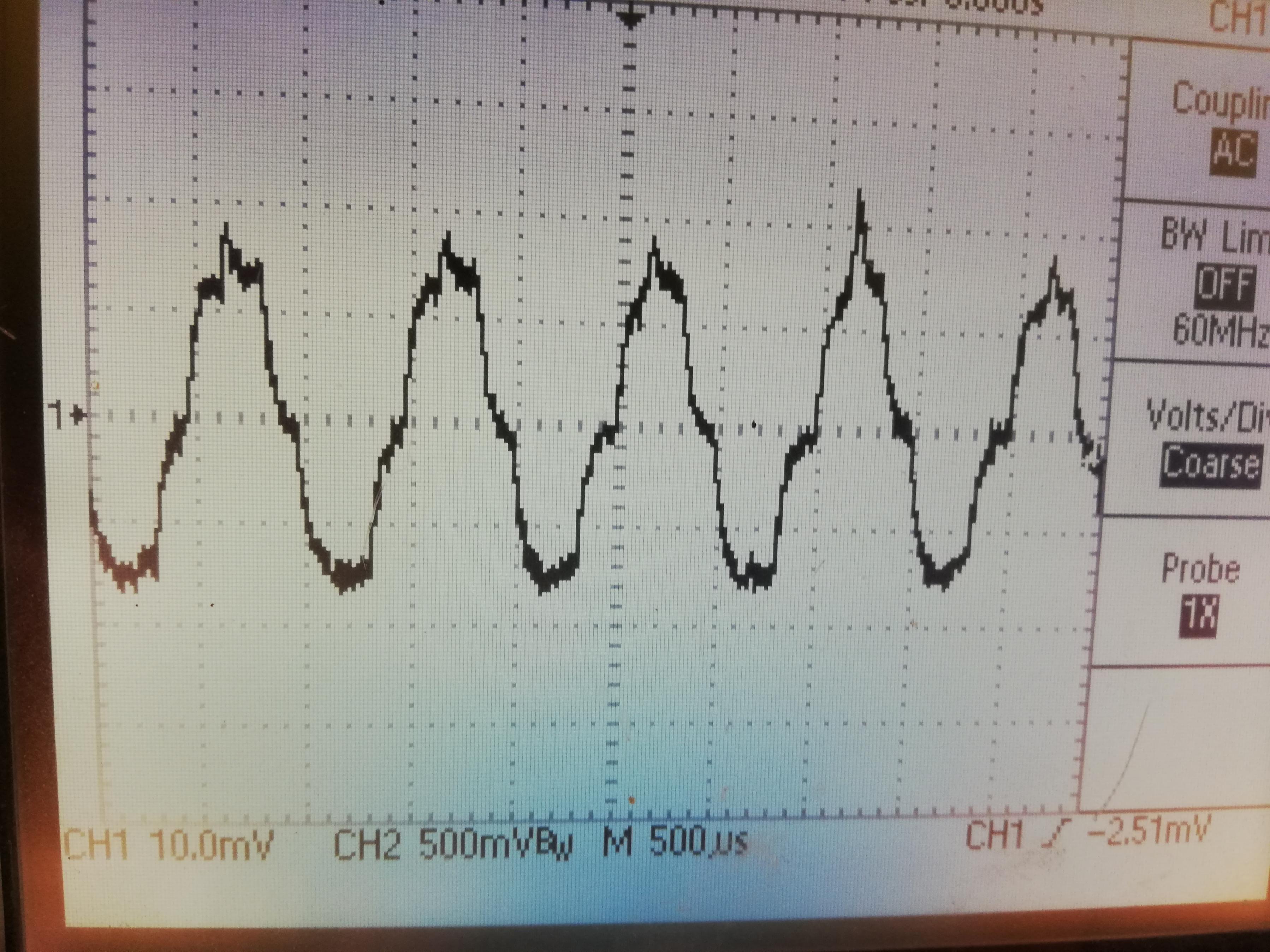

They are wav format files, intended to be written as audio CD or played back by some PC media player through an USB/I2S interface. The DC level at the output of the DAC is indeed fs, fs/2, f2/4, fs/8, etc. with a 3-step variation superimposed. (fs = full scale)I also tried your files but with no luck.
All of the tracks except track 15 produced a - full scale DC at the output of the DAC. Track 15 only noise.
On a low resolution or noisy system the 3-step variation is buried in the noise. Therefore you need a x100 low noise amplifier for visualization.
Sorry I should have added that the x100 low noise amplifier should be AC coupled, to show only the 3-step variation (that should be even in + and - directions referring to the center line)
It is before the x100 amp directly at the output of the I/V stage that the .wav files 1-14 produces steadily full scale - DCThey are wav format files, intended to be written as audio CD or played back by some PC media player through an USB/I2S interface. The DC level at the output of the DAC is indeed fs, fs/2, f2/4, fs/8, etc. with a 3-step variation superimposed. (fs = full scale)
Classic OpAmp I/V stage with 2K from output of opamp to inv.input and noninvert to ground.
x100 amp noninverting 100k from out to inv. input and 1 k to ground. Yes I know it is not exactly x100...
I shall experiment with some LPF to get rid of some of the noise.Koldby,
What about the idea of placing a 22nF cap par. to the output resistor, that would suppress noise quite a bit, just for testing.
What I don’t understand is where all this noise comes from.
You could also feed the Dac with only digital zero, and try to find the source of this noise, an idea ?

What I cannot understand is you can get such a clean signal, if you in fact are measuring on a NOS DAC without any filters , digital or analog. Should be far more noise then IMHO. Do the AP have lowpass filter switched in?
You better make a low noise cascoded transconductance stage for a clean amplification, or something like the ones discussed here:Classic OpAmp I/V stage with 2K from output of opamp to inv.input and noninvert to ground.

So I found the main reason for the excessive noise.Koldby,
Hans
A faulty earth connection in a RCA plug caused most of the noise. 22nF over the feedback I/V and a LC filter just before the x100 amp did the rest, so now it is more clear. Still not as clear as your measurements, but clearly three steps.

Let me first answer your question how I measured.So I found the main reason for the excessive noise.

Since you are measuring a Nos Dac, my advice would be to leave everything working the way it is intended, and that's with an output resistor and not an I/V convertor with a virtual gnd.
So my measuring circuit started with a instrumentation amp like circuit, giviving no load on your Dac output resistor, followed by a level shifter, both having a extremely high Common mode suppression, combined with a high gain.
It is important to connect your probe to the two wires of the second op amp and not somewhere to some gnd.
This way you will get the lowest possible noise from the digital section and a clean analog signal, and still having the Nos Dac in operation as envisaged.

I'm not sure what signal you used, it is way better than before, that's great. But I see at least 20steps, which corresponds more or less with the 500mV/div on your scope.So I found the main reason for the excessive noise.
