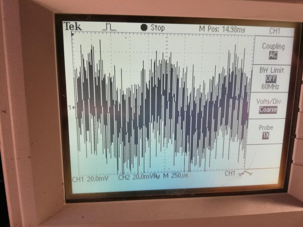

Hi again.
I made a low noise (LM4562) x100 amp and played your file through the Signed Magnitude TDA1541A. Very noisy and it is not the preamp, but a very rude measuring setup not optimized for noise reduction, that causes all the overlaying noise. But definitely a recognizable 1Khz.
If I speculate on what would happen the DAC could not resolve that, it would not IMHO result in even order harmonic distortion, but in raised noisefloor and lack of resolution.
I still am convinced it is the small differences between the two dac's inside the TDA1541A that is the reason.

using lm4562 at 100x can explain the noise in the system and also the nonlinear measurement of short duty cycles spikes...It's possible that the lm4562 itself produce some of the spikes.
As you might not like op-amps either...better use a cascoded common base structure supplied by a very low noise power supply if you want to measure those spikes accurately.
It is ABSOLUTELY not noise from the opamp. I measured it about 1 - 2 mv out of the lm4562 x100 amp with shorted input ...And no spikes whatsoever.
I use a x1 probe into a scope with 5mV per division.
Please remember it is a DAC with absolutely no filters, so a lot of HF noise is expected!!
And I have never used a x100 amp when measuring distortion, why should I???
What spikes are you referring to?? I am not trying to measure spikes , but verify that the DAC actually have a resolution of at least 16 bits.

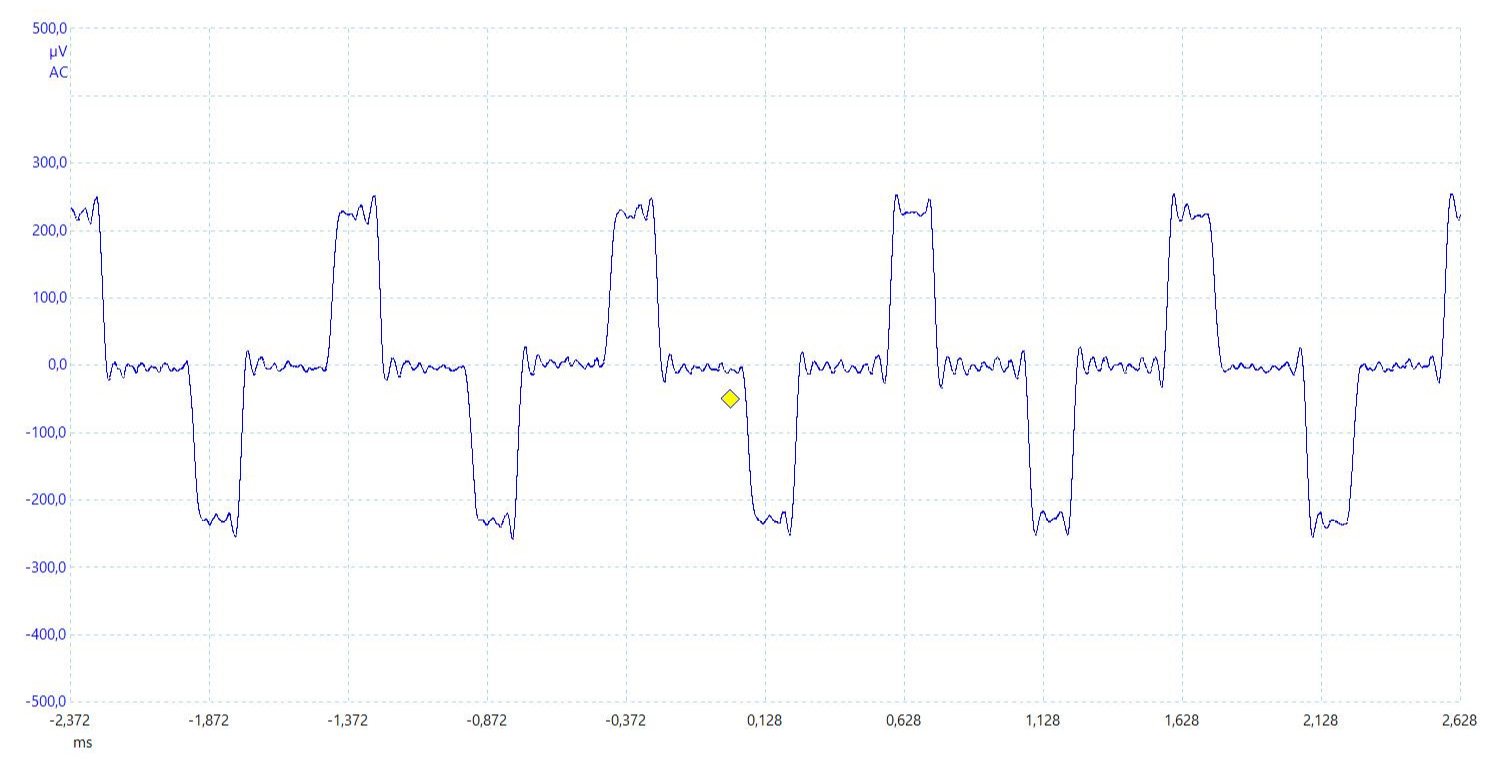

I'm sorry to hear.
This is what I got with the file.
Hans
Sorry to hear what?
As far as I can see the DAC that I measure can easily resolve your file as well...:bigeyes:
It is only drowned in a lot of noise because of no digital filters and no analog filters..
I did not use any filters either, so my feeling is still that things can be improved on your side.
You could for the purpose of this measurement place a cap parallel to your output resistor to get a better view on what’s happening.
But the noise of your 100x amp could also contribute to the noise.
Is this a low noise op amp that you used ?
Hans
Koldby,
What about the idea of placing a 22nF cap par. to the output resistor, that would suppress noise quite a bit, just for testing.
What I don’t understand is where all this noise comes from.
You could also feed the Dac with only digital zero, and try to find the source of this noise, an idea ?
