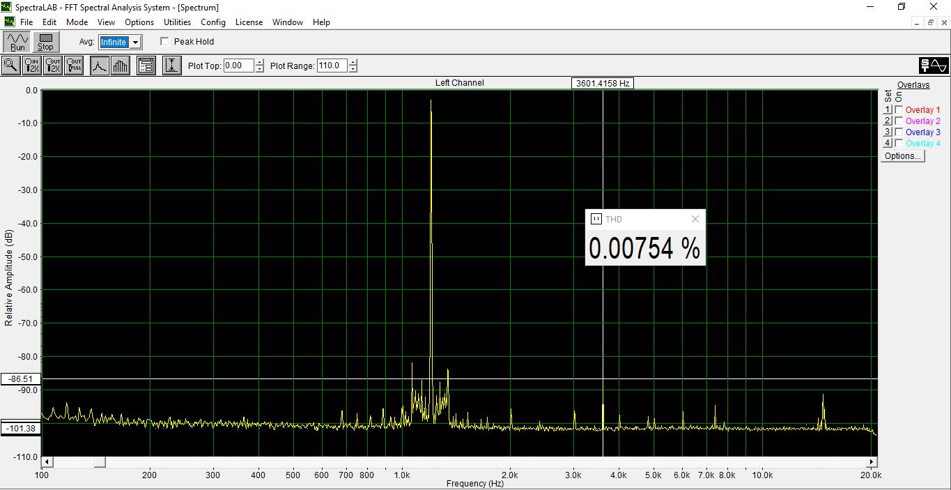

I repeated my previous FFT tests, this time powering the external USB soundcard from batteries, and powering the USB/I2S adaptor from external wall plug (there is an onboard stabilizer). Signal source: REW Generator 1198Hz, -6dBfs and -3dBfs. I used different computers for signal generator and analyzer. First picture is the baseline, second is 100R I/V resistor, -3dBfs, third is 100R I/V -6dBfs, fourth is 50R I/V -3dBfs.
3rd harmonic is visible with 100R, but it disappeared in noise with 50R I/V resistor.
Here is the spectrum of 1198Hz -3dBfs RMS sine (full scale peak) with using an ADUM3160 based USB isolator before the Weilang 24-bit USB-to-I2S/SPDIF card. RI/V = 100R. No much difference really.

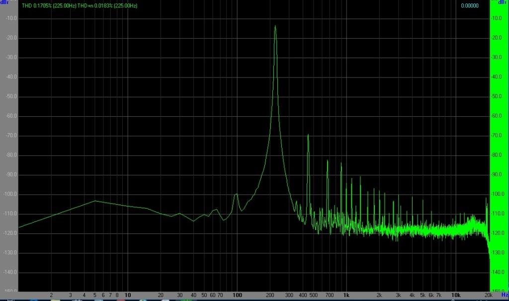

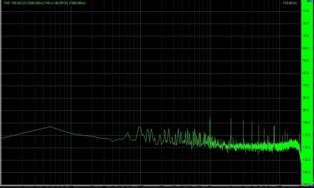

I have been trying a lot to reduce the even order harmonic distortion in the Signed Magnitude TDA1541A DAC, but not with great success. In order to minimize distortions from the I/V , I made an opamp I/V , just to measure, and here are the results:
First pic is the noise/spuriouses when there is no signal in.
Second is with full scale digital input.
Is this what can be expected?
Any comments? John?

What I was asking for actually, was if this is a normal spectrum when you use TDA1541A in signed magnitude mode. It could be an error in the circuit I use and then cause other problems. So I wanted to know if it is representative of the signed magnitude mode.
When you use it in standard mode the THD is much much lower, even if it is a 30 + years old DAC chip!

Excatly, but as you are using TWO TDA1541A, one in the positive half and one in the negative half, it is probably the small differences between the two TDA1541A that produces the even order distortion and probably unavoidable in this application, but I wondered if the figures I measure are excessive.
Sorry I do not have the graphs , but I know the 2. (and 3.) harmonic was about -90 dB.
In normal (and simultanious mode) the 2. and 3. are almost the same @ FS.
In signed magnitude , even order is more prominent, and John even said that this should be expected, but he said it was a slight increase in even order distortion. My problem is, that I see it as substantially increase in even harmonic distortion. Whether this is a problem or even audibly, is another thing, but I just wanted to be sure nothing was wrong in the way the Signed Magnitude was implemented. I have documented the benefits (lacking spike in the zero crossing point) of the Signed Magnitude, so maybe this is just all fine...

Yes I know all the technical backgrounds, I'm just saying something is not O.K.
As a technical challenge it's a nice experiment, splitting the signal in two halves.
What you could do is to offer a -90.31dBFS signal that only triggers the three lowest levels, resp 1, 0 and -1.
When you don't see these three levels, there is something wrong in going from one Dac to the other one.

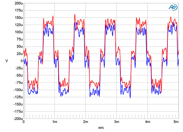

Attached: the second picture is a picture of a 5% full scale digital 300 Hz sinus from a TDA1541A running simultaneous mode with stopped clock.
The first is a closeup of that around the zero crossing. It is easy to see the big spike, when TDA1541A is changing all the bits at once. No spikes on any of the other transisions. Good reason to try Sign Magnitude 😀
