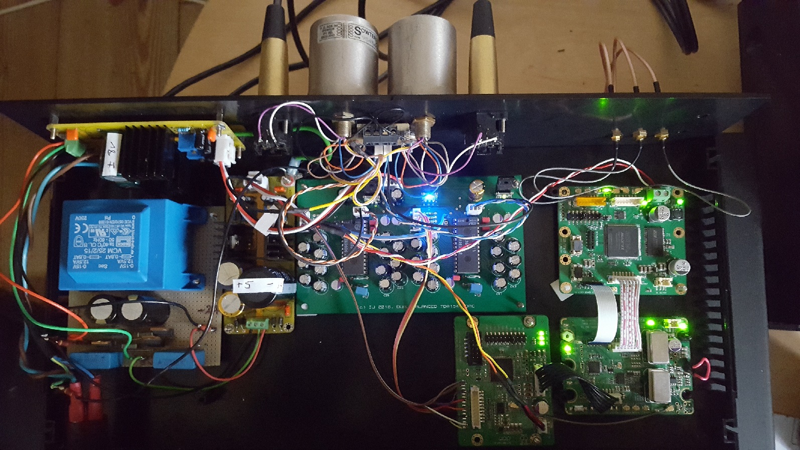

I eventually damaged my first I2S-PCM board by connecting to 15v instead of 5v. Ian very generously replaced it for the cost of the cost of repair.
I also then bought a Fifo 2 and dual clock board.
Today it is all connected and it sounds superb. Better than the dual AD1862 I have been listening to in the meanwhile (via SPDIF and a SRC4192 EV).
I/V is four 50R resistors and the Sowter transformers. By using balanced operation, the static 2ma offset of the dacs is nullified so no DC flows through the transformers which si essential.
The wiring needs tidying and my MK2 dac pcb will have pads for U/fl connectors for the data but I am relieved I now have something great to listen with.

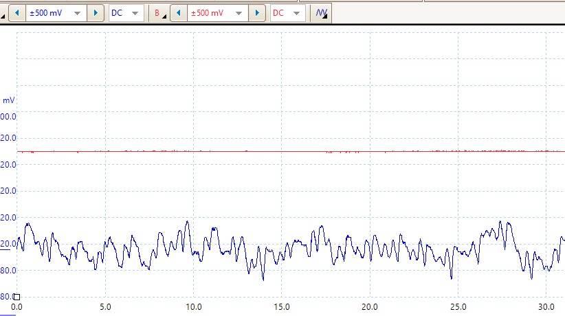

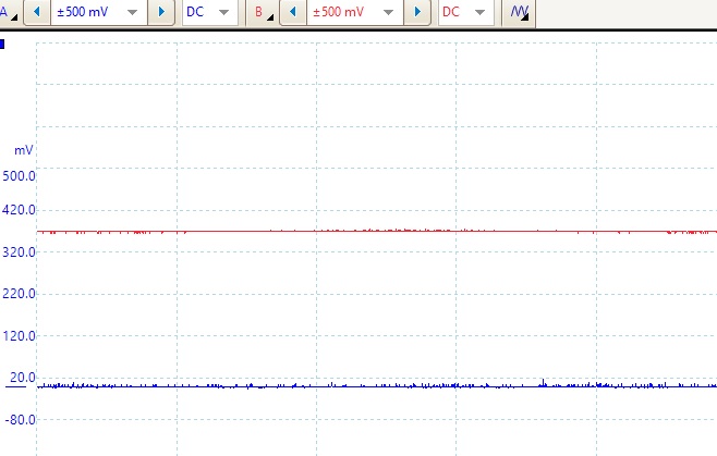

Very clean differential traces from the left channel dac D+/D- taken directly from across the dac audio out pins. (loaded with the I/V resistors and transformer)
These I believe shows the benefits of balanced simultaneous operation and the clock stopping features of Ian's board.
Who needs OS with such clean signals!
Blue = signal and then no signal.
