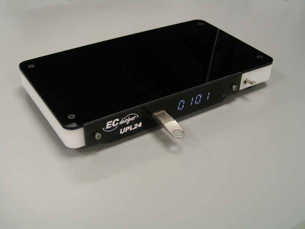

We also developed a very clean, battery powered digital audio source to explore the limits of DAC and connected audio equipment and for performing low level measurements.
This very clean source is now available as the UPL16 (44.1/16 and 48/16 support) and the UPL24 (44.1/16 ... 96/24 support). It has Toslink output. Similar to the the UTOS, MCK, BCK, DATA and WS signals (Left Justified) are present on the board.
The two USB sockets on the UPL are for internal battery charging and for firmware updates respectively.

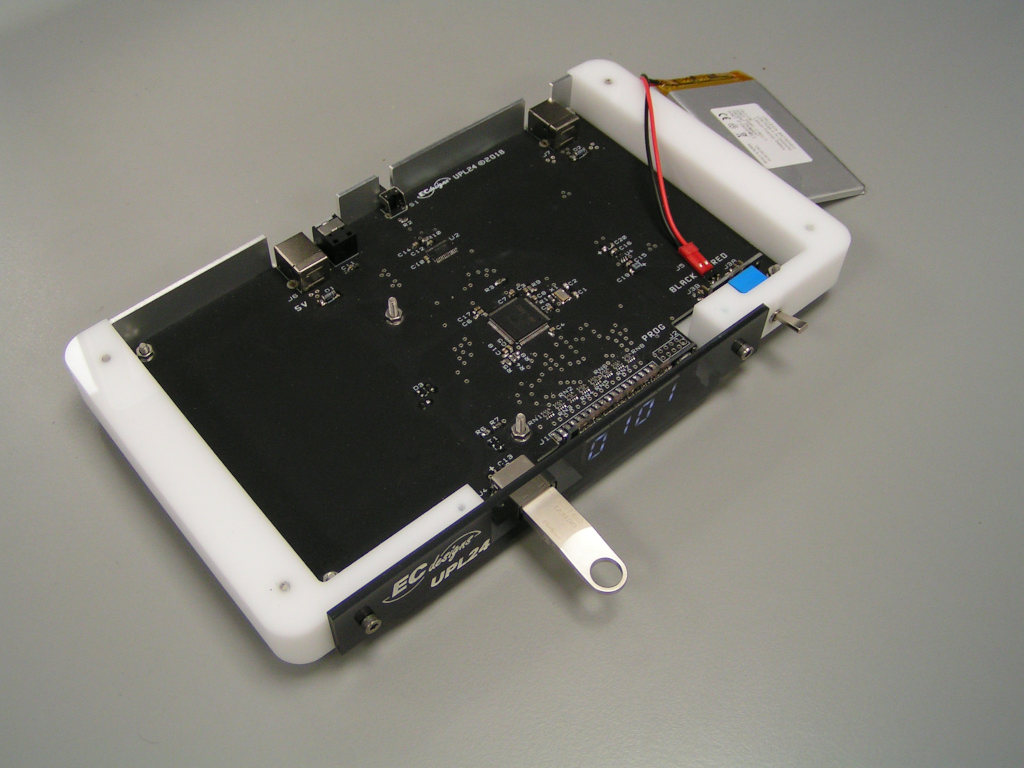

The UPL is based on a single low power micro controller and a S/PDIF transmitter chip. Dynamic master clock scaling is used to reduce interference and power consumption to absolute minimum. The complete UPL24 plus USB stick consume approx. 250 milli watts when streaming 44.1/16. The UPL has an auto power saving mode that puts the UPL in low power mode and switches-off the USB stick power supply.
It supports up to 99 CDs, each CD containing up to 99 tracks (9801 tracks in total) on a single USB stick. Shuffle modes are also provided. USB stick needs to be FAT32 formatted with a MBR. In most cases a new USB stick will work out of the box without formatting. If I am correct, maximum supported USB stick capacity is limited to 2 Terra bytes.
The CDs are represented by folders that have to start with a number between 01 and 99. Within those folders are the WAV tracks that also have to start with a number between 01 and 99. Plain text file called id.txt that holds a number between 1 and 9999 can be added in the root for USB stick identification. Artwork can also be added for reference, but keep in mind that artwork name should not start with a number between 1 and 99.
We only support WAV as this requires no conversion and we can use on-chip hardware instead of software routines. This greatly reduces CPU load and interference levels.

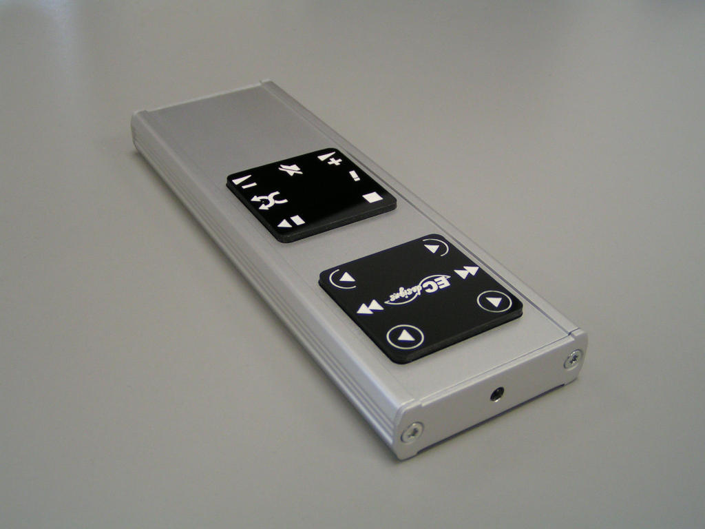

I attached some pictures of the UPL24 and the IR remote control.

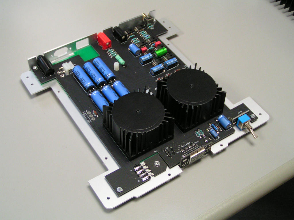

With our novel MBL monoblock, following happens with the same listening level:
DAC, 5.6Vpp -> volume control -> 1Vpp -> amplification 5x -> 5Vpp -> speaker
DAC software volume control -> 1Vpp -> amplification 5x -> 5Vpp speaker
We can now use ten times larger signal (improved SN ratio) for the same listening level and get a lot more resolution out of the speaker.
The MBL offers variable gain of x5, x10, and x20.
Why do we have class A and SE amplifiers wasting power? because of audible crossover distortion. The higher the bias current, the less problems we have with the AC voltage generated by the speaker (dynamo).
But there is a more elegant solution to this problem, we applied it in the MBL. The MBL only requires 11 watts or less during idling and sounds at least as smooth as SE or deep class A
I attached some pictures of this MBL monoblock.

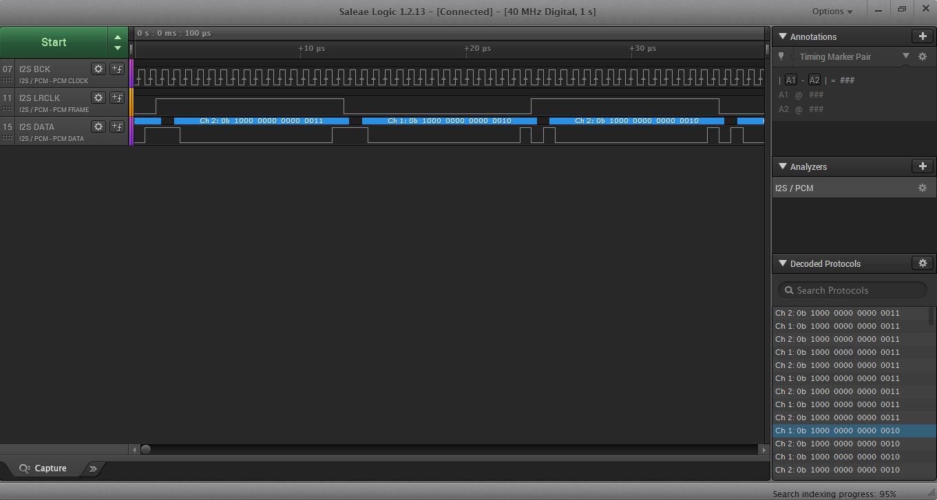

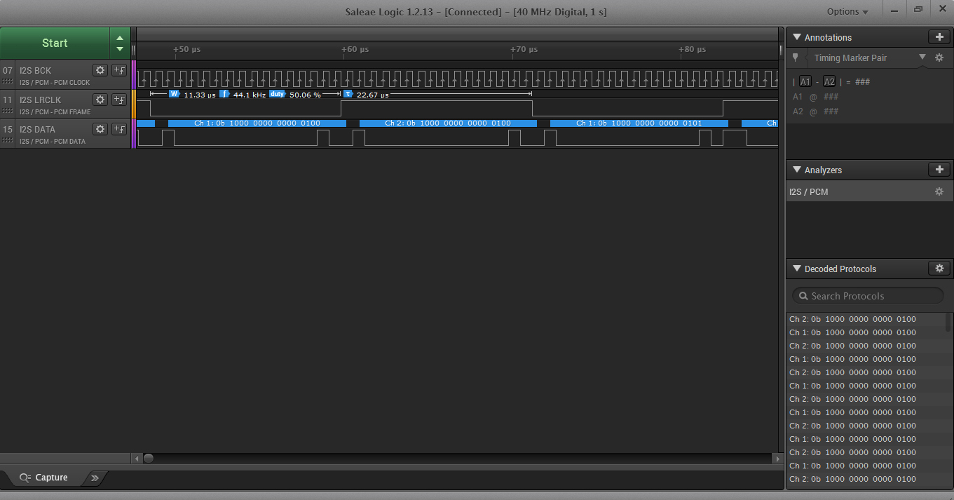

Koldby, tried your suggestion of bypassing Ian's board for WS - no difference to the distortion.
Next connected the board to a cheap USB to I2S interface.
Screen shots attached. Still looks like one of the clock cycles is after the rising edge of LE but no distortion heard from Youtube so far. (48Khz)
Does this mean that the I2S data from the Denon Cd player is not actually I2S?
Images: Bck + L, D + BCK, D + L
I can now answer my own question!
Yes, its 16bit right justifed MSB first. (which explains the distortion although I am surprised I got any audio at all).
To find this out, I installed a sample rate converter evaluation board - a SRC4192 in my dac and connected it to the AD1862 dac board from DIYINHK. (I2S in)
I set the output to I2S and the input to 16bit RJ, and this was the only setting that worked with the dac. (I tried all the other input data formats - I2S, 24bit LJ, 18,20, 24bit RJ)
Taking Marcelvg's advice, I set the 4192's clock generator for 24.576Mhz which gave an output bit clock of about 6.14Mhz and fs of 96k (clock/256) & 20bit compared to the input data of 16bit, 44k/2.822M.
The sound quality is nothing special, with occasional quiet clicks - like a worn LP, but I have not found the cause. Its probably due to the wiring between CD player and dac & maybe the ADUM digital isolator between them or maybe the SRC4192 itself.
This doesn't matter for now as I will be using the AD1820 with a USB to I2S converter and building a second dac powered entirely by Lifepo4 & Lipo cells
using IanCanadas Fifo II and I2S board plus my own balanced TDA1541 dac board.
So I feel a clot for accidentally feeding Ian's I2S board with the wrong data type but in my defence, no one came up with a definitive answer as to what the actual data format was.
You 'live & learn'.
