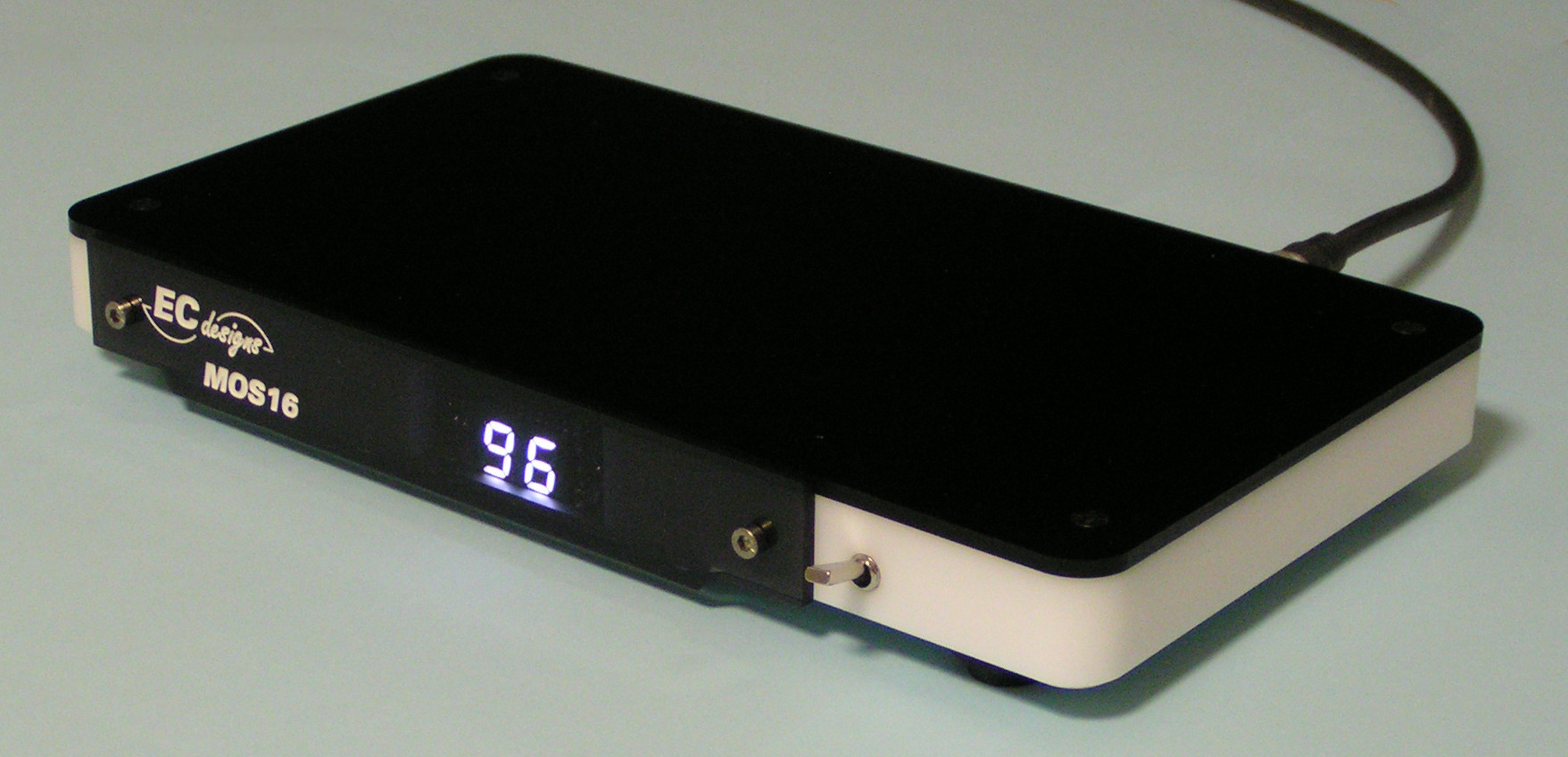

Hi JOSI,
Yes, we completed the new MOS16 and MOS24 DACs that will be presented on our new website soon, together with some other very interesting new products. So keep an eye on our website.

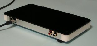

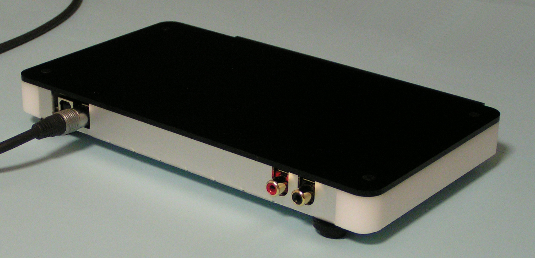

I attached some photographs of the first completed MOS16. The USB socket on the rear is for internal battery charging only.

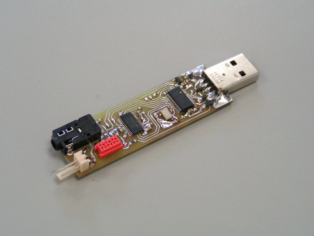

The MOS DACs can also be connected to USB audio sources while retaining required advantages of Toslink. We designed the UTOS for that, third picture shows the first UTOS prototype.
