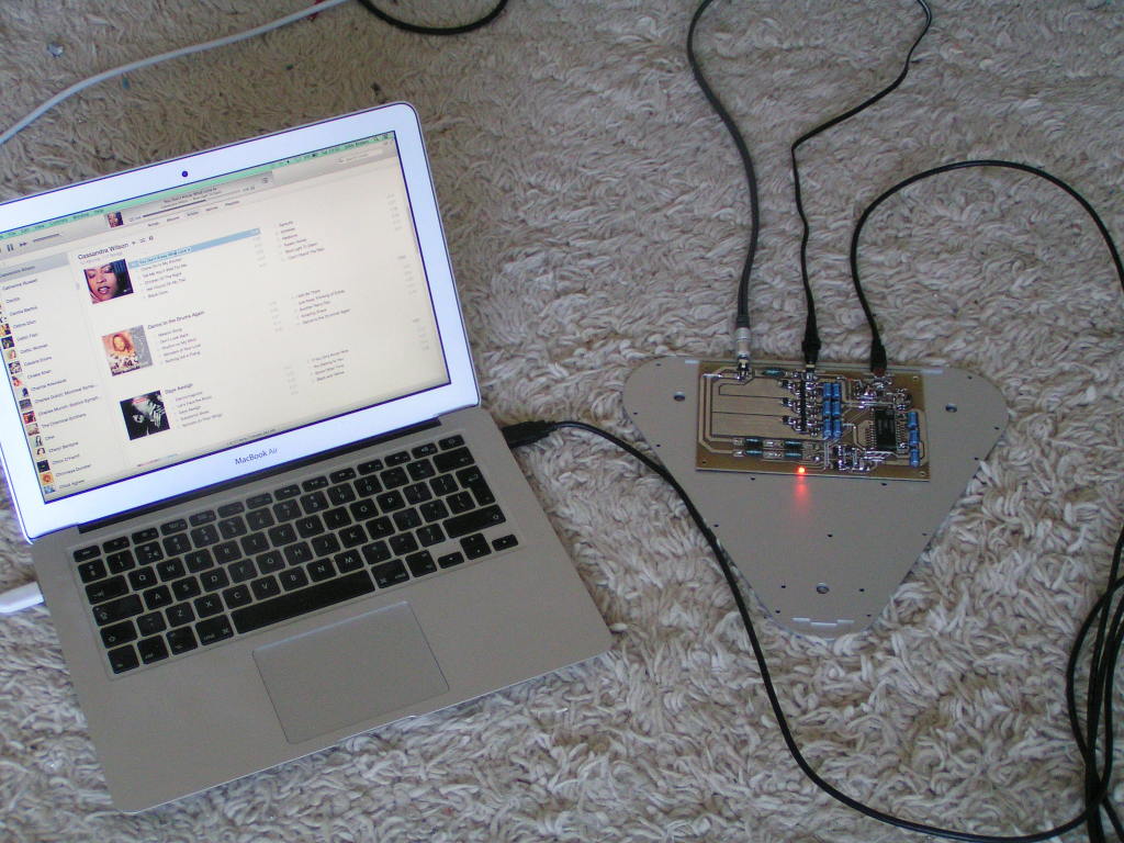

Well picking up is an understatement, a euro card size TDA1541A asynchronous USB DAC prototype with reactor circuit is already up and running (attached picture).

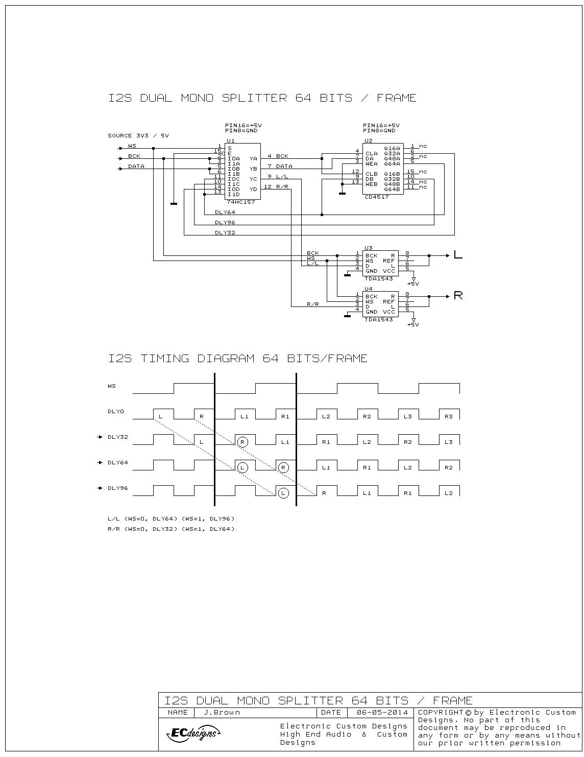

Could you post a schema of the i2s splitter? I would like to use it on 1543
I2S dual mono splitter
Hi marconi118,
I attached the schematic of the I2S dual mono splitter.
It already contains DATA and WS buffers / level translators so this circuit works with digital audio sources with 3V3 and 5V signal levels.
The circuit works with both, TDA1543 and TDA1541A
The outputs are L/L and R/R and both L and R outputs of one DAC chips are paralleled as in the schematic.
The timing diagram illustrates how the circuit works. The CD4517 provides required delays of 32, 64, and 96 bit clock periods.
The 74HC157 (quad, 2 input multiplexer) is used for buffering & level conversion and for selecting the correct delay depending on WS signal level. All multiplexters change state with the WS signal that enters pin 1.
This circuit could be converted to a L/-L and R/-R splitter by adding two inverters. One at pin 10 of U1 and one at pin 13 of U1. One could use 74HC04 for this.

Hi Jaffrie,
Pls excuse my ignorance. What advantage does dual mono
have over parallel dac ? We're still summing the output of both
dac together but in a different manner .
- Good matching and thermal tracking of both paralleled DAC chips (both DAC sections are located on the same chip).
- Noise / jitter spectrum only relates to one channel that is being processed by that chip instead of a mix from L and R channel.
- Greatly reduced crosstalk between L and R channels. Crosstalk significantly increases when paralleling multiple stereo DAC chips.
- Tolerances in full scale current between L and R channel on the same chip that are related to chip design are cancelled as the same tolerances now occur for both channels.
DAC chips have different propagation delay between BCK / LE signal change and output latching. This time can be measured with a frequency counter.
This means that when paralleling DAC chips that have different propagation delay, the outputs won’t latch exactly simultaneously but rather one after the other. Propagation delay can also change with thermal drift (not constant).
This can introduce significant jitter. Jitter amplitude and spectrum change with amount of paralleled DAC chips and the thermal drift in all DAC chips ensures that sound quality isn’t constant.
Matched DAC sections (located on the same chip) with excellent thermal tracking will minimise this issue with propagation delay (changes). This again can be measured with a frequency counter.
One has to trigger the counter with the BCK / LE signal and stop counting as soon as a new sample is latched at the output. 0dB Square wave test signal can be used for this. The measurement shows tolerances in propagation delay and change of propagation delay as a result of chip temperature changes.
When stacking TDA1543 chips, the chips in the center of the stack get hotter, so propagation delay of these chips will already be quite different from the propagation delay of chips located at the top or bottom of the stack. This, together with tolerances in propagation delay ensures high jitter levels due to non-simultaneous latching.
Similar issues also occur with non-matched delta sigma DAC chips that are not thermally coupled.
So in general it is not a good idea to simply parallel randomly selected unmatched DAC chips as this will almost certainly lead to degraded sound quality compared to a single DAC chip.
Dual mono configuration can be useful to double full scale output current (better switching characteristics, lower I/V resistor value for same output signal amplitude). Since the full scale current of the TDA1543 for example is rather low (2.3 … 2.5mA) and on-chip crosstalk is rather high, it is a good idea to use these chips in dual mono mode.

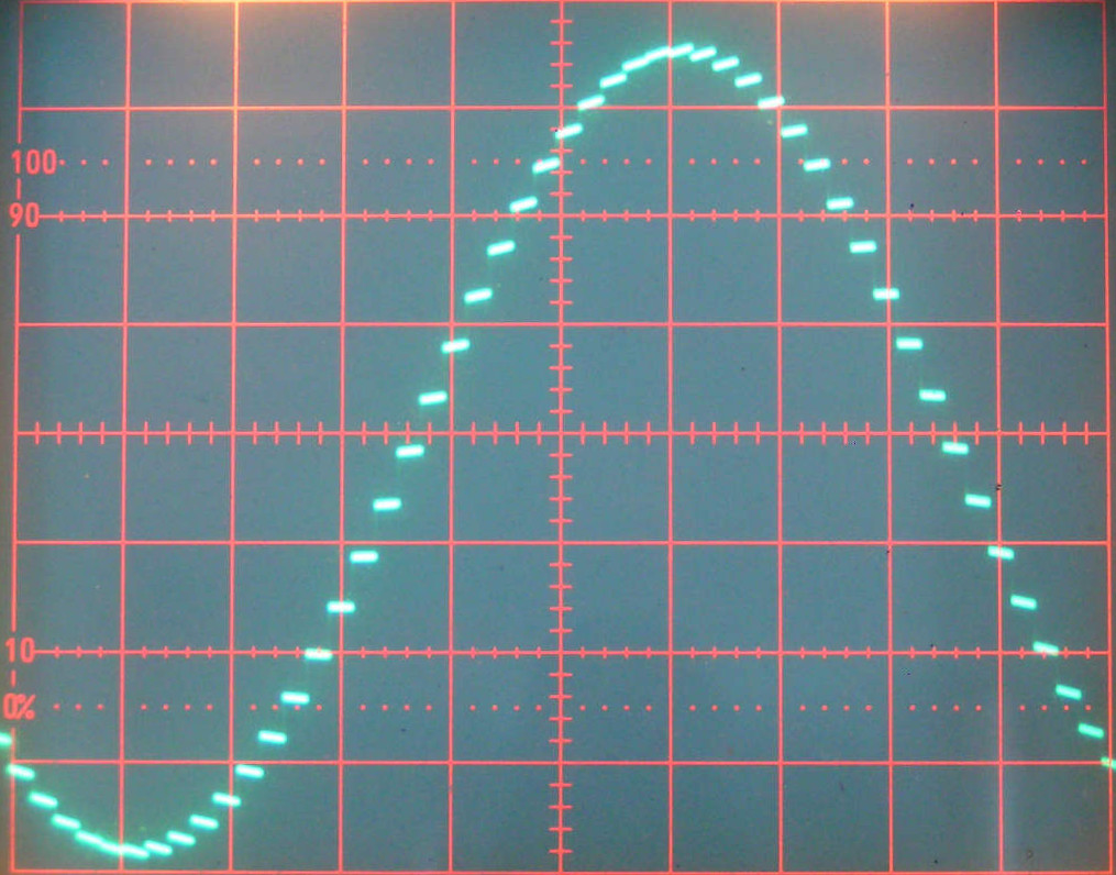

I tested a TDA1543 single, two paralleled and dual mono configuration side by side. The dual mono configuration provides best perceived sound that comes closest to that of an optimised TDA1541A circuit. So the I2S splitter clearly offers advantages here.
The signal is not corrupted, bit perfect L / L or R / R data is latched into the DAC chip. The circuit only delays I2S signals so the data can be aligned (diagram added to the I2S splitter schematic). The 74HC157 selects a specific delay time depending on WS signal status.
I have to add that I always test with the reactor circuit installed now.
I attached an oscillogram of the reactor circuit output signal of an early prototype. The reactor circuit basically super imposes an analogue sawtooth signal to the zero order output signal of the DAC chip. Polarity and amplitude change with sample polarity and value. The sawtooth signal contains even order harmonics. In contrast with the zero order hold signal, the reactor output signal keeps changing during sample hold time (ramping up or ramping down).

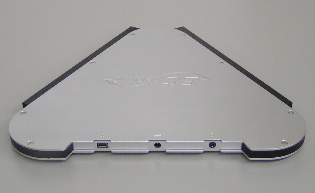

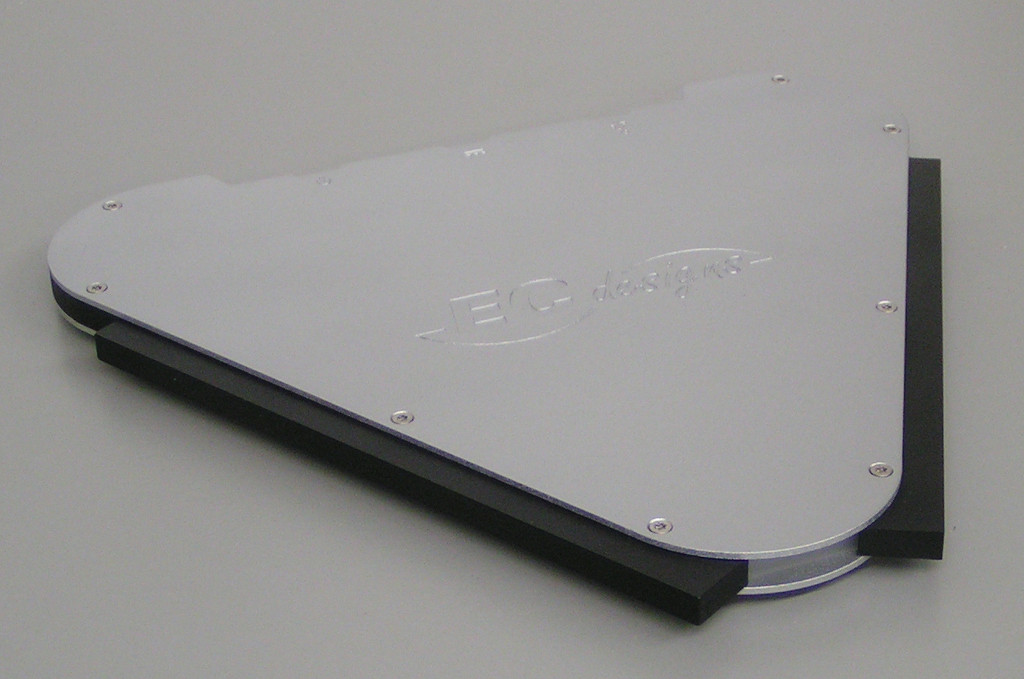

That got you to pick up the TDA1541A project again…
Both, UD2 DAC and the new SD2-player will be based on the TDA1541A and the reactor circuit.
Both projects will fit in a similar 12mm high housing (attached pictures show the already completed UD2 DAC).
