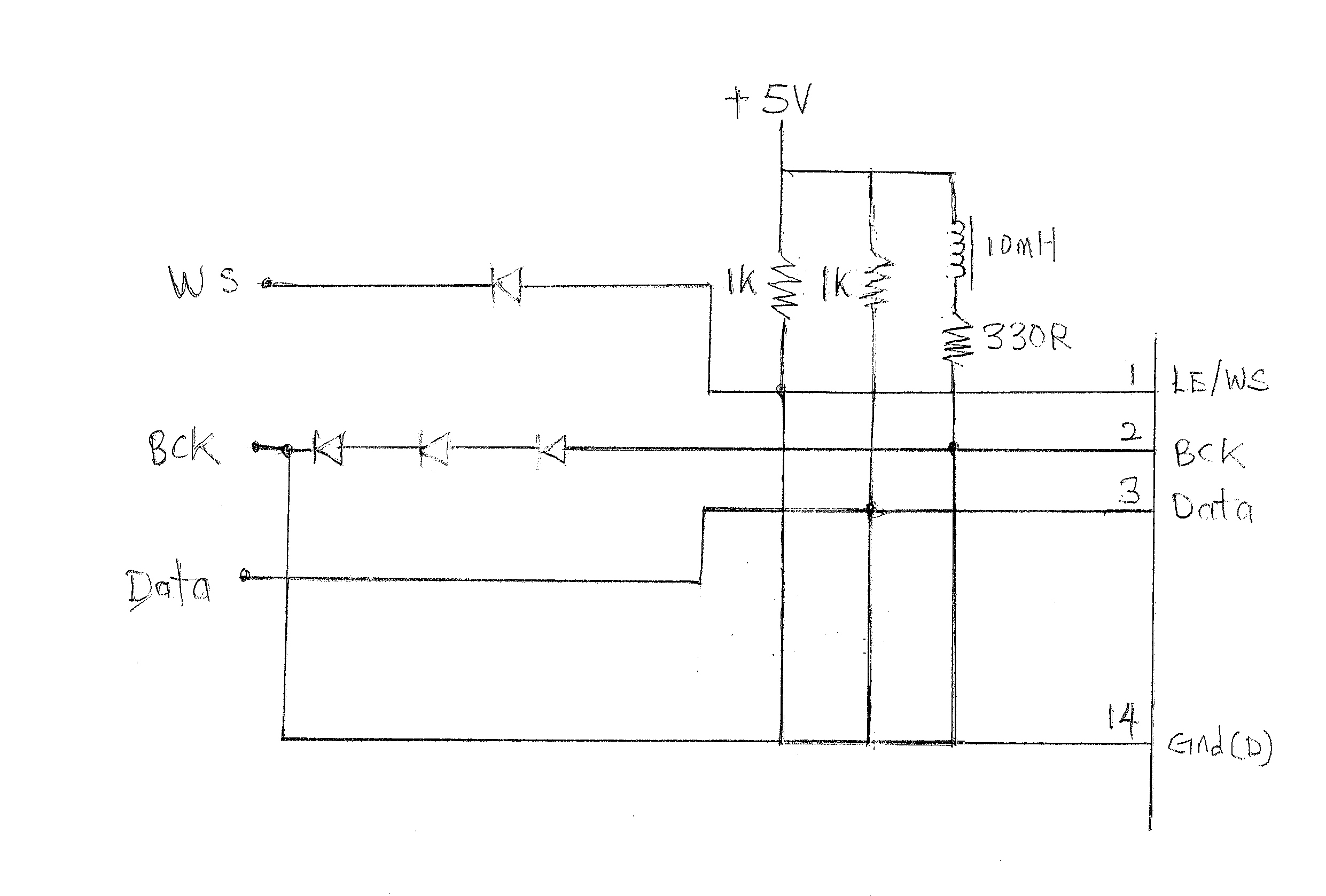

You can use DEM clock circuit and I2S attenuators for this project, no problem.
Suitable I2S attenuator can be found in the TDA1543 datasheet, page 5, figure 4a.
TDA1543 pdf, TDA1543 description, TDA1543 datasheets, TDA1543 view ::: ALLDATASHEET :::
The protection diodes at the input that connect to +5V and GND can be removed. The CCS can be built from a JFET with current setting resistor or one can use a split pull-up resistor with a decoupling cap between the junction of both resistors and GND.
1N4148 or similar diodes work fine. You will need 4 diodes for each input.
This will generate a clean 1V2pp I2S signal that varies between 0V6 and 1V8.
This I2S attenuator will work with both, 3V3 or 5V I2S signal level. You could use SMD diode arrays for making a more compact attenuator.

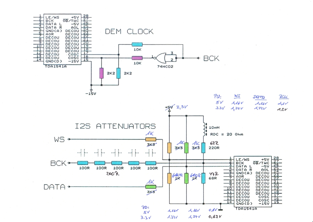

DEM clock
I implemented the above I2S atteunators and it works, but when i conect the DEM clock as shown there was a lot of noise. I even conected the +5V supply to Pin 14 and Gnd to Pin 7.
What is wrong?
Help greatly appreciated
I attached latest DEM clock and I2S attenuator schematics. The I2S attenuators can also be used for the TDA1543.
The DEM clock circuit consists of two resistive attenuators that perform biasing, level-shifting and attenuation. The DEM clock frequency has been increased to 2.8224 MHz (bit clock).
The I2S attenuators provide both a bias voltage (approx. 1.2V), and attenuation of the I2S signals. By lowering I2S signal amplitude, sound get's much more refined, due to reduction of I2S interference.
The bit clock (BCK) attenuator needs a choke (10mH Panasonic ferrite-core choke) to attenuate power supply noise. This choke will also provide a high impedance to +5V, so the series resistor value can be increased, and the shunt resistor value can be lowered.
I used multiple 100R resistors in order to minimize the effect of resistor stray capacitance.
I tried many, more complicated discrete designs. This simple circuit performs best so far, especially when using multiple low noise transistors in parallel, minimizing current flow through each transistor.
The simple trans-impedance I/V converter uses current steering and is extremely fast (large bandwidth). By using few high quality (low noise) parts, signal degradation can be minimized.
Single-ended output (class A) seems to provide cleanest sound, as cross-over distortion is eliminated.

Hi Audiohifi,
Circuit lay-out is -very- critical, one would have to place the complete circuit (especially the DEM clock circuit) over a solid ground plane and use shortest possible wiring (millimeters) and effective decoupling. Failing to do so causes instabilities (noise).
I now use a free running low jitter DEM oscillator:
470pF film cap between pin 16 & 17.
6K8 resistor between pin 15 & 16.
6K8 resistor between pin 15 & 17.
The latest I2S attenuators I used were diode attenuators:
Diode #1, cathode to I2S source, anode to TDA1541A I2S input.
Diode #2 … #4 in series, cathode to ground, anode to TDA1541A I2S input.
Pull up resistor, 1K for WS and DATA, 330R for BCK between +5V and TDA1541A I2S input.
1N4148 diodes will do fine. One could also use an IR led (1V2) with a diode in series to replace the 3 diode diodes in series. Impedance would be a bit lower this way.
These diode attenuators produce a very clean 1V2pp I2S signal that varies between 0V6 and 1V8.
The pull-up resistors may pollute the 5V power supply. One could use split pull-up resistors (470R, 470R for example) and decouple the junction to GND using a capacitor.
I implemented the above I2S attenuators and it works, but when i conect the DEM clock as shown there was a lot of noise. I even conected the +5V supply to Pin 14 and Gnd to Pin 7.
What is wrong?

Your Latest I2S Atteunator
Hi John,
Thank you for your reply.
See attachment. Is my understanding correct.
Hi Audiohifi,
Hi John,
