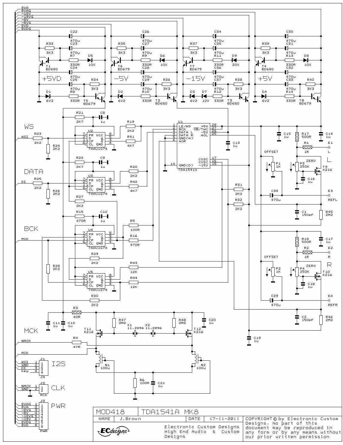

Hi John, can you explain us a bit about your grounding philosophy?
I see the supply lines being decoupled to gnd just after the regulators. You also mentioned your grounding for the tda (using separate lines running to pin 5). How are you using the top plane?

Further to this, I had a closer look at the layout... It seems like:
- ...+5V (Reclocker) and -15V are decoupled to the same GND line
- ...-5V supply is decoupled to the GND belonging to the -15V supply?
- ...all GND lines in the supplies are connected to a common GND plane (top)
- ...decoupling of the supply lines to the chip is done quite far away from the TDA
:Confused:
Hi studiostevus,
All common mode voltage regs on the MK8 are decoupled with 1uF SMD film cap close to the regulator output. There are no electrolytic caps on the regulator outputs.
The references of all 4 common mode voltage regulators are connected to the ground plane that serves as GND reference:
Masterclock, synchronous BCK divider and synchronous WS / DATA reclockers all have local RC filters located very close to these circuits. The resistor for the masterclock RC power supply filter is a low noise Honeycomb Mobius resistor.
The TDA1541A power supply SMD film decoupling caps are soldered directly to the chip pins, underneath the chip as close to the IC housing as possible (attached picture).
So TDA1541A power supply decoupling is actually pretty close to the chip.
The 14 active divider decoupling caps are also soldered directly to the TDA1541A pins. Only 14 pins of the TDA1541A are connected to the MK8 module using a customized IC socket.

MK8 concept schematics.
I attached TDA1541A-MK8 concept schematics.
On the top there are 4 common mode voltage regulators for +5V, -5V, -15V, and +5V. They consist of cascaded filtered buffered zener diode regulators.
This works as follows, T1 and D5 form a 10V - 1.2V = 8.8V pre regulator. This pre regulator is placed in the ground reference line. T5 and D1 form a 6.2V - 1.2V = 5V post regulator that is referenced to the 8.8V GND reference provided by the pre regulator. R7 and C23 filter the zener diode noise.
The 5V post regulator is placed after the 8.8V pre regulator and re-stabilizes it to +5V. The output of the 8.8V pre regulator serves as ground reference. The output of the post regulator is decoupled to GND by a 1uF SMD film cap (C11).
The negative common mode voltage regulators function similar. The -15V regulator has a -18.8V pre regulator and a -15V post regulator.
Note that all common mode regulators have separate plus and minus inputs that are connected to the main power supply using twisted pairs. The main power supply contains rectifiers, smoothing caps and common mode capacitance multipliers.
WS and DATA inputs are first attenuated by R23 ... R26. U2 and U3 perform synchronous reclocking. R19, R20, R40 and R41 perform I2S attenuation for the TDA1541A. The MK8 only has 2 I2S inputs, DATA and WS. Source BCK signal is not connected to the module.
Each synchronous reclocker has a separate RC power supply filter, R21, C8, R22, C9.
BCK is derived from the masterclock using a synchronous Johnson counter consisting of U4 and U5. R28 ... R30 reduce ground bounce. R5 and R16 form the BCK I2S attenuator.
Balanced DEM clock is now derived from U5 using R43, R44, R31 and R32 to inject the signal into the DEM oscillator circuit on the TDA1541A.
The masterclock is built around 2 lateral MOSFETs T11 and T12. Both crystals are matched high-Q versions.
Chokes N1 and N2 are now connected to a DC reference voltage generated by R6 and C21. This lifts the clock signal above GND so clock rectifiers are no longer required. The masterclock runs on approx. 2V. CLC filter consisting of C12, R3 and C20 offers extra filtering of the 5V masterclock supply.
I/V conversion is passive by generating a voltage across resistors R17 and R18. The TDA1541A output current is buffered by lateral MOSFETs T9 and T10 that serve as current buffers (grounded gate circuit). The DC bias level on the TDA1541A outputs is adjusted by integrating the output signal across the passive I/V resistor and feeding it back to the MOSFET gate. This is done by P3, P4, C16 and C18. R45 and R46 make sure the MOSFETs can't go out of conduction as the DAC output current approaches zero.
The bias current running through the I/V resistors equals 2mA, so the DC voltage at the outputs equals +4V. In order to provide DC-coupled outputs, two +4V reference voltages are added that now serve as output "GND". The DC voltage between this DC reference and the voltage on the I/V resistor now equals 0V.
R1 and R2 are mobius loops that are used for low level refinement.
The MK8 outputs can be directly coupled to RCA sockets without the need of an additional module like required with the MK7.

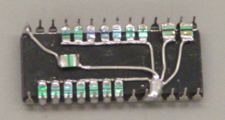

My assault on the K8 version recloker
