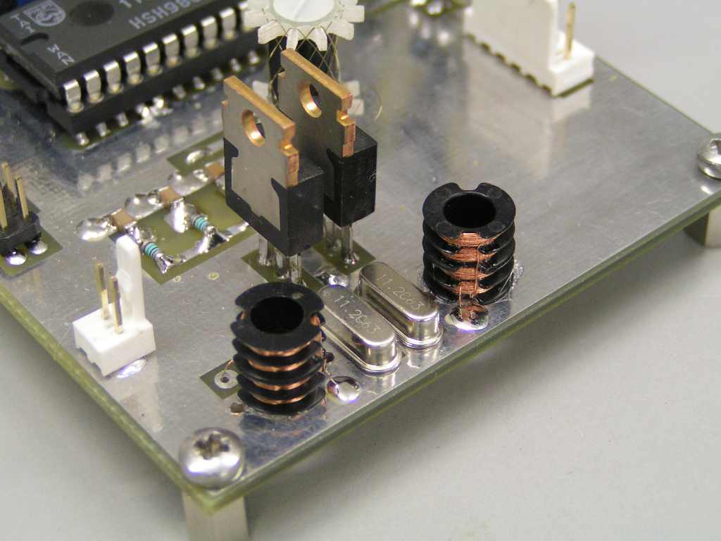

John,Hi roger57
These are custom made, multi-segment air chokes (non tunable). They consist of two dual half core formers glued together (intended for use with ferrite pot cores). Turns are equally divided over these 2 formers (4 x 50 windings). These chokes are then screened using a brass IF transformer screen.
The photograph shows an early prototype.
I see some strange values for the clock crystal here in the picture: 11.2063 Mhz.
Looking on the net gives no clue. Just curious!

Hi triode_al,
These are the crystals I bought:
CITIZEN AMERICA|HC49US11.2896MABJ-UB|CRYSTAL, 11.2896M, 18PF CL, HC49 | Farnell Nederland
They are specified at 11.2896 MHz and I received crystals with following printings: 11.2C76 and 11.2C63
Hi triode_al,
Thanks, I see now. And a tandem gives very low jitter in your design as I remember.
albert
Quite a funny misunderstanding: I also wondered if I missed something regarding the 11.2063 MHz 😉
