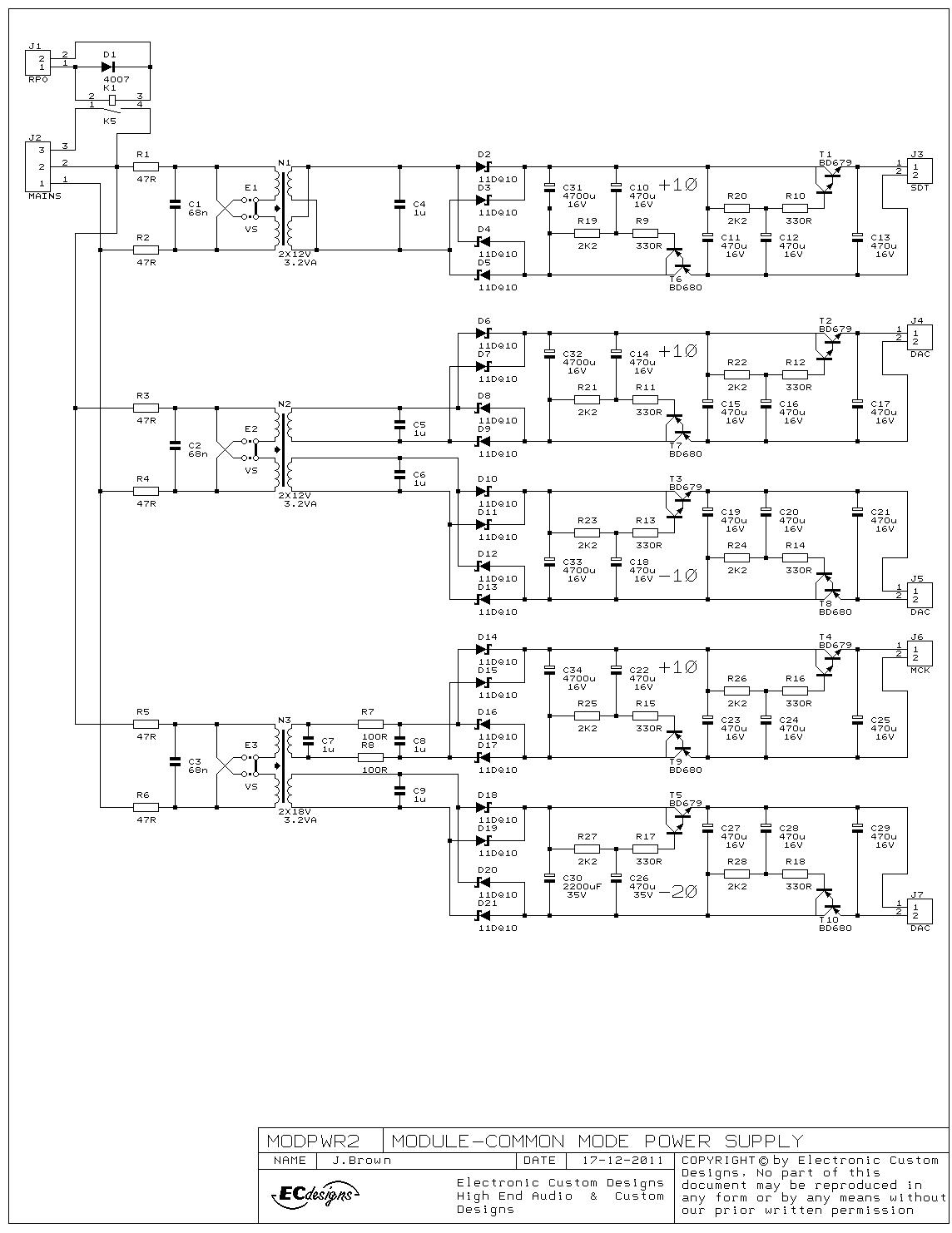

This year I have been busy building a new workshop, so I had very little time for audio projects. This workshop has now been completed.
Yesterday I completed common mode power supply schematics and routing of the PCB. The module will hold 5 separate common mode power supplies and fits on a euro size PCB.
Is it similar to the pre-regulator and capacitor multiplier parts of the schematic you posted earlier, which are then followed with a post-reg locally at the TDA ?.
Capacitance multipliers are located on the power supply module, pre / post regulators are on the MK8 DAC module.
I attached common mode power supply concept schematics. When combining it with the MK8 schematics I posted earlier (post #4008 on page 401) you can see how I split up the power supply sections.
Hi Ken,
Was that your design objective, or do you have a different view of what the regulator is actually doing?
Common Mode - attenuation to signals that appear identically on each of the wires going through the filter
Differential Mode - attenuation to signals that appear on just one of the lines.
Based on this, the new power supply should be called common mode power supply unless I am missing something.
Anyway, main function is placing a high impedance in both feed and return (GND). So the impedance between the mains and the powered circuit is high. With a conventional power supply, the return line (GND) has low impedance.
By placing a high impedance between mains and circuit, the effect of mains interference and ground loops can be greatly reduced.
Other objectives are very low noise, low output impedance and unconditional feedback stability under complex dynamic loading.
