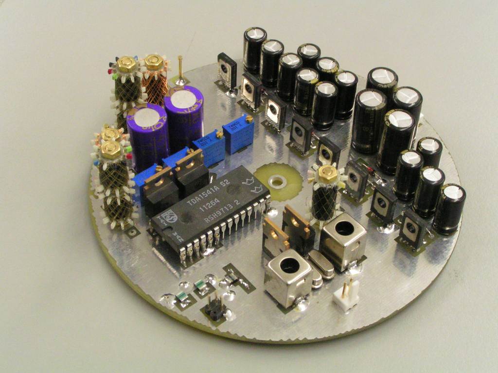

Here is a screen shot of the new TDA1541A-MK8 module PCB lay-out
It looks like it fits in a cd-player. Nice sentiment.. 😎

Hi brubeck,

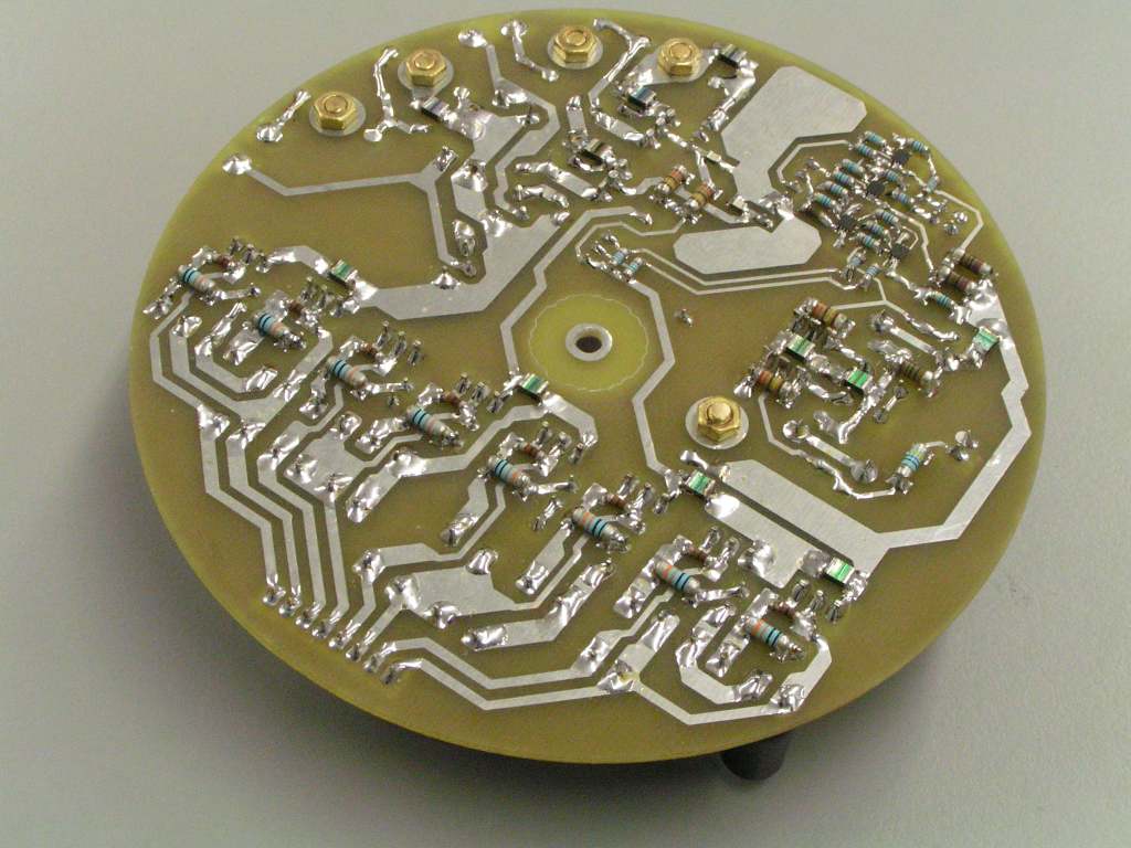

I attached some pictures of the TDA1541A-MK8 module that was completed today.
nice one, ive been using those panasonic pps for a while now too, very nice caps. cool looking module for sure; i pictured you using bulk foil trimmers =)
Hi John,
thank you for posting the schematics of the latest regulators and some pictures of the MK8 module.
In your designs you are using MELF resistors. Do these resistors have an electrical advantage compared to 0805/1210 or is it just for easier/better mounting and soldering?
well they are metal foil resistors, rather than regular thin film, but i thought i read that they were magnetic
