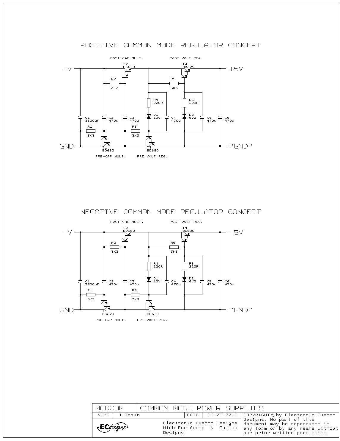

Common mode power supply concept schematics
Hi JOSI1,
can You show in more detail how the common-mode filtered buffered zener diode regulator looks like when placed in both supply lines. Is the circuit for the pre regulator (GND line) and the post regulator (Plus/minus line) identical?
I attached common mode regulator concept schematics for both, a positive and negative 5V supply.

Hi Joshua_G
As for your discrete regulators, possibly plain capacitance multipliers will be quieter. They can get even quieter when for low power consumption clients the pass elements can be JFETs like 2SK170 and 2SJ74, possibly few JFETs in parallel. Just an idea.
The pass elements for both, capacitance multiplier and filtered buffered zener regulators need to have high gain, low voltage drop and high (surge) current capability. This makes 2SK170 and 2SJ74 less suitable.
Also, sometimes multilayer PCBs with ground planes on the inner layers help minimizing high frequency interferences.
When a curtrent flows from point A to point B in a PCB trace located above a ground plane, one cannot guarantee that the return current flows back exactly the same way.
Multiple return currents will now flow through the ground plane, choosing the momentary path of lowest impedance. This in turn creates increased EM levels and unwanted coupling between signals sharing the same GND return plane.
Better method is providing a well defined GND return path for each signal, ensuring optimal canceling of EM fields and minimizing coupling between multiple GND return signals.
