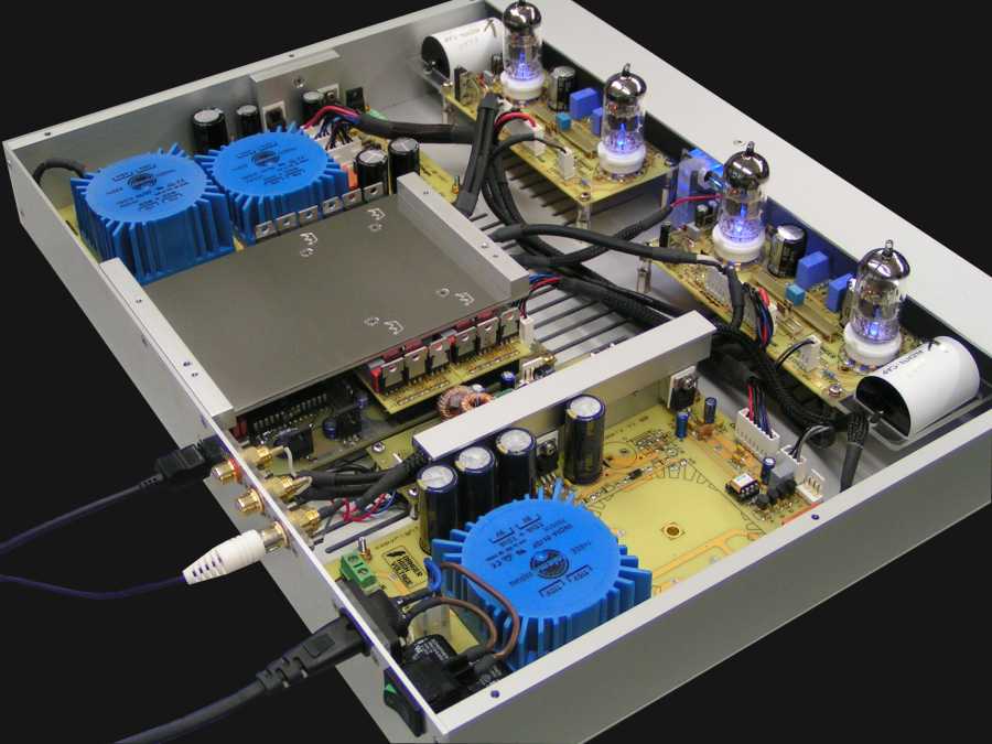

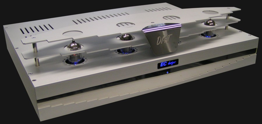

Hi MGH,
The DI4T design is ready, I added a connector for the optional SPDIF cleaner module (part of the twin-VCXO system) on the DI4T mainboard.
I am now selecting / testing the best components for the signal path. I am planning to order some DI4T mainboards soon.
As DI4T performance increased, I had to improve my audio set again. I now use modified bulk metal foil resistors for the entire signal path (passive stepped volume control included), well except for the passive I/V resistors, these are still copper wire types. The passive stepped volume control now holds 28 Vishay VSH1 resistors.
I added a photograph of how the DI4T looks now. The part showing "DI4T" is made from polished stainless steel, it's CNC milled and engraved. Since I was at it, I made a top cover for the DI4T core, with engraved crowns (since I am using 4 x TDA1541A-S1 now).

No, to busy as always, "record" now stands at 18 years without holiday (I didn't have a holiday since I started my company in 1990).
Here is a photograph of the DI4T internal circuitry. I was able to remove another transformer (fewer voltages required because no OP-amps are used). The SPDIF cleaner is still located on a proto-PCB built around a CS8412, the final PCB design will hold a CS8416.
The black trimmers on the tubedif modules are bulk metal foil trimmers, it's quite an improvement over the cermet trimmers. I replaced most of the resistors in the tubedif modules with modified Vishay bulk metal foil resistors, I had to make some small adapter PCBs when multiple resistors had to be used in parallel or series.
I still plan to test Caddock TF020 for the higher resistance values, and Mills wirewound for the higher wattage resistors (twin-cathode follower load resistor).
I probably going to use cryo-treated JJ ECC82 (gold-pin, balanced / matched), and Tungsol ECC803 (gold-pin, balanced / matched). At the moment I am using JJ ECC83S (gold-pin, balanced / matched) for the differential input stages. The tube amplifiers do add complexity, but provide the most transparent sound with highest dynamic resolution.
Both tubediff modules are mounted to the frame using flexible spacers (two hexagonal brass spacers pressed into a clear plastic tube). This reduces microphonics / feedback problems.
The tube sockets are modified ceramic PCB types with gold-plated contacts.
All Molex connectors are also modified to gold-plated contacts (pinheaders & sockets).
Screened wire interlinks are Van Damme studio patch cable (mixed OFC silver-plated & OFC copper wire) with foamed poly-ethylene insulation.
I also used Schottky 1.1KV / 1A Hybrid diodes in the HV tube power supply. These provide a very clean sound, I tested these diodes with a pulse generator, recovery is identical to Schottky diodes. The only high voltage Schottky diodes I could fine were Silicon Carbide versions that can just handle 600 ... 800V, but these are very expensive. So I constructed a Hybrid version, only disadvantage is slightly higher forward voltage drop.
I also increased the capacitance of some electrolytic capacitors, and used versions with better performance.
The white connector supplies 5V to the remote power on / off relay, so all devices connected to the PCU (passive control unit) can be switched-on and off simultaneously using the remote control.
The rear panel is now adapted for the DI4T configuration, the RCA sockets are high-quality gold-plated versions, the sockets are also placed further away from the mains connection when compared with the DI8M design.
There is now one single Toslink input. The Toslink receiver module has enhanced bandwidth and is mounted on the DI4T mainboard.
After testing a lot of different coupling caps, I still prefer the Audyn plus for this specific application. I now use Vishay / Roedersteyn 15nF / 160V precision polypropylene bypass capacitors (the small blue capacitors on the separate PCB). The Audyn plus caps are mounted on flexible lexan holders to reduce problems with mechanical vibrations.
The power consumption of the DI4T has dropped to approx. 30 watts. The TDA1541A heatsink stays quite cool, the DI4T can play all day at high ambient temperatures without problems.
TDA 1541A & LM 4562

Hi Pocoyo,
Yes, it seems like the DI4T finally meets the design objective.
4 x TDA1541A.
None, the DI4T uses tube amplification exclusively. The OP-amp I/V converter was replaced by differential passive I/V conversion.

Hi Pocoyo,
I currently use JJ ECC83S and JJ ECC82, I am planning to test Tungsol ECC803 as well. I don't use the standard tubes, but factory selected balanced / matched tubes with lowest distortion and lowest microphony with gold-plated pins.
I already use high-quality ceramic tube sockets with gold-plated contacts. This requires the use of tubes with gold-plated pins too. The sound quality doesn't change, but poor contacts are avoided this way.
When you look at the photograph in post #2110 you will notice that I also used professional gold-plated RCA sockets.
All Molex connectors are equipped with partially gold-plated crimp terminals, I also swapped all tin-plated pins from the molex headers with gold-plated versions.
The SPDIF cleaner PCB (located between DI4T mainboard and DI8 power supply) can be removed when real glass-fibre Toslink interlinks are used. These have multiple thin glass fibres. The cheaper interlinks only have a single clear plastic fibre that increases jitter problems and reduces optical output.
Film capacitors act similar as condenser microphones, mechanical vibrations result in small voltage changes. When these capacitors (with solid wires) are mounted directly on the PCB, and the PCB is mounted firmly to the chassis, mechanical vibrations are coupled into the capacitor.
Similar, tube sockets mounted firmly to the chassis will pick-up vibrations that are coupled into the tube metal parts, affecting performance.
In order to prevent this, and enable the use larger film caps in the super flat 1.96" (5cm) high DI4T housing, the film capacitors are mounted on thin flexible Lexan frames, and flexible wires were soldered to the capacitor. The TUBEDIF PCBs are mounted on flexible spacers (clear plastic tube with a hexagonal spacer pressed in on each side). This construction is visible on the photograph in post #2110. The coupling capacitors are the large white ones at each side of the TUBEDIF PCBs. The small blue capacitor, mounted on a small PCB strip between the tubes is the 15nF Vishay / Roederstein MKP1837 precision polypropylene bypass cap.
Note that the DI4T is packed with these kind of details that contribute to refinement of sound quality.
I tested many film capacitors like Auricap, Audyn, Monacor, Obligato, Pulse-x, Siemens, Visaton, WIMA (same capacitance value of 3.3uF and same application), and compared them with a DC-coupling. Each capacitor has specific properties that color the sound, this sometimes sound impressive, but it's not transparent.
Up till now the Audyn plus performs closest to a DC-connection, it doesn't sound "impressive", but the direct comparison with a DC coupling showed it produced the most transparent sound of all caps I tested so far.
The Audyn plus has a special construction, two counter-wound windings, coupled by a "blind" layer. This results in a non-inductive construction. Polypropylene foils always have so called micro-punctures (microscopic holes in the foil). When a single layer is used (like with most capacitors), arcing, and associated noise could occur. Double layers prevent alignment of these micro-punctures, preventing arcs and associated noise.
Audyn plus caps have a very good electrical connection between lead wires and foil. This reduces noise / distortion, and enables handling high peak currents without problems. This makes them suitable for passive, high power speaker crossover filters as well.
The Audyn plus caps are also vacuum treated, and sealed to remove air pockets between the windings. The price is eur 7.69 each, the price/performance ratio is excellent.
