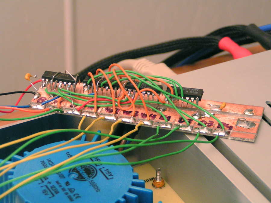

Hello,
I've been following this thread trying to understand the i2s reclocker. I want to use a pcm2706/7 to tda1541a (only one) with this reclock system. I am pretty much a noob at this so I just want to check if this works (don't mind the colours)
Is this the way I build this?
Thanks in advance
Thanks in advance
Hi serph1nia,
Yes this should work.
U8 and U9 are shift-registers, they basically consist of 8 cascaded D flip-flops that are synchronously clocked (CLK). The output of each D flip-flop is available (QA ... QH). The first D flip-flop has 2 D inputs (AND).
Without the reset circuit (U10) it's basically a plain asynchronous reclocker (similar to two cascaded 74xx74 chips). However, this reclocker is always reset after a fixed amount of masterclock pulses (inverter Q10). So it acts as an both an asynchronous reclocker and a digital one-shot circuit. This means that the positive BCK pulse width is always fixed. The circuit requires a masterclock that oscillates at (almost) an exact multiple of BCK.
Note that the reset is asynchronous here, I later improved this circuit by not using the reset inputs (tied to VCC), and feeding QH (U8) back to the second D flip-flop input (B) of U8, using inverter U10, B needs to be disconnected from input A of course.
This is basically an asynchronous reclocker that changes the jitter frequency spectrum, but doesn't block it.
I think it's best to drive the DAC chips directly from a (2.8224 MHz) masterclock, without any reclocking. This requires synchronization between both source and masterclock.

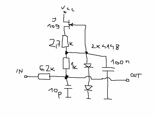

Hi ec design
could You post the sch of the
improved I2S attenuators please?
I would like to try...
Hi Zoran,
1K5 resistor close to WS / DATA outputs (primary series resistor).
PCB trace or wire from 1K5 to the attenuator.
Attenuator:
Input to VCC using 3K3 (pull-up resistor).
Input to GND using 1K0 (pull-down resistor).
Input to trace 1K8 (secondary series resistor, close to DAC chip input).
BCK, only series resistor:
TDA1543, 330R.
TDA1541A, 22R.
There are many other options to boost TDA1543 / TDA1541A performance.
One big problem seems to be L / R channel tolerances, Bernhard already documented this with measurements. Both channels are located on specific spots on the chip, and are surrounded by different circuits, so each channel has a unique noise frequency spectrum. When the same channels are paralleled (L+L+L+L ... R+R+R+R) errors are correlated, and might prevent correct averaging of bit errors.
So paralleling multiple DAC chips "the easy way" might even lead to increased distortion.
One way to prevent this, is swapping L/R channels inside the DAC chip. This can be done by manipulating the serial I2S data for half of the paralleled DAC chips. This also means that the L/R outputs on these chips need to be swapped!

Hi -ECdesigns- 🙂
That's what discourages me: you do in one day what will take me a month to plan and build... 🙁
I understand but with a diagram it could be easier...
So, with TDA1543 a 330R is better on BCK signal...OK, I have time to correct it.
M
Yesterday I designed, built and tested a scrambler / interpolator circuit for the DI4T.
The scrambler / interpolator was designed to provide balanced output signals and 4 x interpolation: DAC #1, L16 / R16 (channels delayed). DAC #2, NR48 / NL48 (channels swapped, delayed and inverted). DAC #3, L32 / R32 (channels delayed). DAC #4, NR64 / NL64 (channels swapped, delayed and inverted). Now the L / R channel on-chip tolerances are correctly averaged. This doesn't seem to be that spectacular until you hear the results.
M
-ecdesigns- said:One big problem seems to be L / R channel tolerances, Bernhard already documented this with measurements. Both channels are located on specific spots on the chip, and are surrounded by different circuits, so each channel has a unique noise frequency spectrum. When the same channels are paralleled (L+L+L+L ... R+R+R+R) errors are correlated, and might prevent correct averaging of bit errors.
IIRC, in Philips players, with os always the same channel had more LL distortion than the other.
But there were a few exceptions where the other channel was better.
Also IIRC the 1541A with 7220A had a characteristic spectrum around K5 & K7, which changed to K2 K4 K6 K8 with nonos.
IMHO in both cases the characteristic spectrum = sine waveform means that paralleling chips does not average out any errors.
I had put 3 TDAs in parallel without success.
Old picture of 1541A nonos:
maybe it is not about the distorsion...
but i check 1, 8, 16 tda1543 in parallel, at the same system
and winner is 16...
with instantly noticable sound improvement
and I was not alone in that test, everybody was reacted on the same way.
So maybe it is issue of rapid decrease of output impedance?
And linearising in highs was much better then 1 chip, no need for corrections
