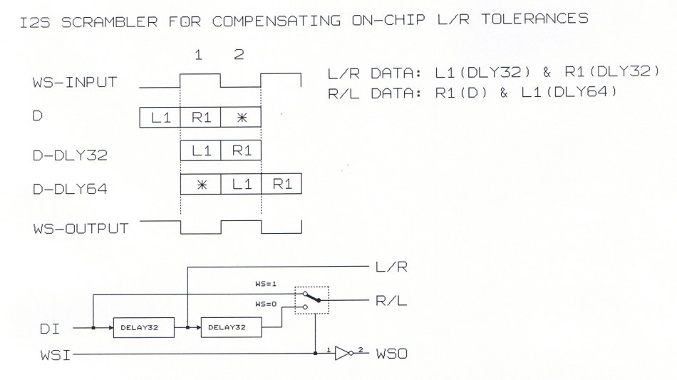

I attached both a timing and block diagram of a scrambler circuit. It has now been tested on both TDA1541A and TDA1543-based DACs, there is a significant increase in low level information, and much better L/R channel matching, even the DC-offset voltages are closely matched now.
This scrambler is already integrated on the new DI4T main board prototype, together with the highly effective tracker for source jitter blocking (replaces VCXO / PLL).
I used a separate 330R damping resistor for each TDA1543 clock input, this produced best (audible) results. The TDA1541A-S1 chips in my DI4T perform best with a 22R damping resistors on BCK

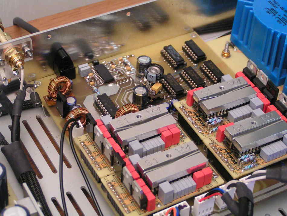

I attached a picture of the new DI4 main board prototype. The chip closest to the insulated voltage regulator on the left is the micro controller for the tracker. The 10-bit passive R2R DAC is placed on the solder side.
I used resistive attenuators for DATA and WS signals, all digital outputs have damping resistors installed to minimize interference.
The new CS8416 receiver is placed close to the Toslink optical receiver and runs in slave-clock mode.
The small module in the center is the discrete VCXO with a supercap soldered directly to the power supply connections.
The 5 chips on the right are used for 4x interpolator, scrambler, and DEM / WS generation.
The UHS clock buffers are placed on the solder side.
Both GND and power supply connections are hard-wired on the solder side, this had to be done for achieving minimum crosstalk.

Hi Bernhard,
This is probably caused by TDA15xx on-chip tolerances between both L and R channels.
When simply paralleling these chips, it's possible that these typical errors are increased (correlated errors).
The scrambler circuit will prevent this form happening by swapping L/R channel data within the DAC chip. This is achieved by manipulating the I2S data for each DAC chip (group).
When paralleling 4 chips, I2S data would need to be as follows:
DAC #1, L/R (this is the standard sequence)
> L output = L output, R output = R output
DAC #2, R/L (channels reversed on the DAC chip)
> L output = R output, R output = L output
DAC #3, L/R
DAC #4, R/L
