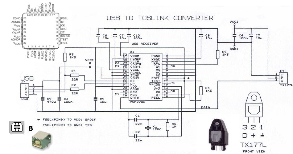

Hi Dorsal!
The PCM2706/7, 12 MHz crystal oscillator is mainly used for USB communication and on-chip timing. The source (computer) will dictate average sampling rate. Changing the 12 MHz crystal oscillator frequency has no effect on BCK frequency.
The PCM2706/7 only runs in master mode, meaning that it can only output MCLK, BCK and WS timing signals.
There is a simple way around this, configure the PCM2706/7 for SPDIF output (on DATA out pin), and connect a Toslink transmitter to this pin. The USB receiver Toslink output can now be connected to a Toslink SPDIF receiver that can run in slave clock mode. The use of Toslink guarantees perfect galvanic insulation with zero coupling capacity in order to block all unwanted signal current loops (ground loops) between both source (computer) and DAC. Suitable receivers are CS8412, CS8414 and CS8416 for example.
When using the DDDAC DAC, it should be possible to configure the existing USB receiver to output SPDIF on the DATA output pin. Refer to PCM2707 datasheet for details. This SPDIF signal can now be fed to the existing SPDIF receiver module that runs in slave-clock mode. Galvanic insulation can now easily be provided by using both a Toslink transmitter and receiver pair.
Now both DAC chips, and SPDIF receiver are still directly clocked by the masterclock (and receive a low-jitter clock) while accepting digital audio data from USB, routed via SPDIF.
I had an email exchange with Doede Douma (DDDAC1543) about the possibillity of clocking the PCM2707 with an external Clock.
I attached a schematic for a simple USB to Toslink converter. The TX177L Toslink transmitter can be ordered at Farnell (P/N 1225772). The circuit is bus-powered (receives power supply from USB). It should be possible to make a miniature version approx. the size of an USB stick, it could then be directly plugged into an USB socket having shortest possible USB interlink.
I am using a similar circuit to connect both DI4MJ and DI4T to USB audio sources during testing.
I have to point out that the USB audio source needs to provide bit-perfect playback for best results.
The PCM2706/7 has pin 9 (FSEL) tied to VDD in order to select SPDIF output. The SPDIF signal will appear on pin 17(DATA).

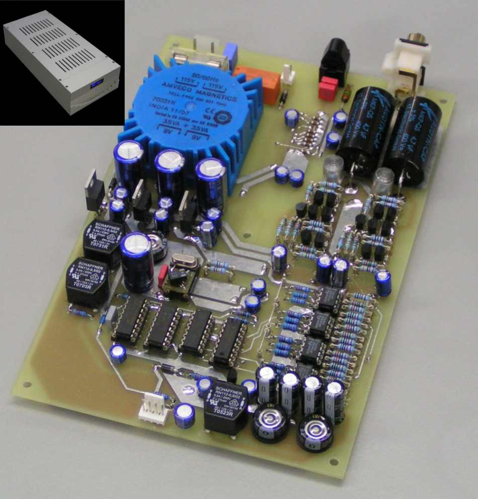

The DI4MJ is based on 4 x TDA1543 in a highly optimized design. I attached a photograph of an early prototype. This DAC is placed in a small DI16 anodized aluminum housing
It's a single-PCB DAC that has power supply integrated and consumes approx. 4 watts in total.
It has an on-board Toslink input and CS8416 receiver that runs in slave-clock mode. the 4 TDA1543 chips perform 4 x interpolation, they run on 4.6V power supply and need no heatsink. The new version has both scrambler and tracker, just like with the DI4T. The power supplies are all filtered using both chokes and supercaps.
All 4 TDA1543 chips have I2S attenuators / bandlimiters installed (8 in total).
The master clock is a discrete low-jitter VCXO that produces 2.8224 MHz and can be varied +/-100ppm with 10-bit resolution. The crystal runs on very low power for lowest jitter. The master clock is buffered by multiple UHS clock buffers, damping resistors are used on all digital outputs to minimize interference.
The I/V conversion is now passive (4 x 110 Ohms) using 2 x Arcol 220R in parallel. Amplification is done with the new discrete high-resolution 4-JFET amplifiers (basically a replica of the new DI4T tube amplifiers), but now using JFETs. The 4-JFET amplifiers have DC-coupled output, so the output coupling caps on the photograph are no longer required.
The DAC also has a remote power on/off option, so it can be switched-on by applying a 5V control signal. The LED indicator on the front panel lights when the tracker has locked.

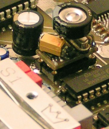

It's no DPLL, but a frequency tracker. When accurately locking on the source clock phase, the lower jitter frequency spectrum of the source is "copied" and transfered to the masterclock.
I use a discrete VCXO circuit, the crystal runs on very low power, and the power supply has a special filter on it to emulate a battery power supply. The control voltage input is connected to a 10-bit passive R2R DAC through a low-series capacitance, low-pass filter. The VCXO also has on-board filters for both power supply and voltage control inputs. The masterclock outperforms the standard 0.5ps rms XO clock modules that still produce significant jitter below 10KHz as specified in the datasheet.
I added a close-up of this VCXO, it's a small double-sided PCB with SMD parts on both sides. The 0.1F (100,000uF) supercap is soldered directly to the power supply pins for best performance.
